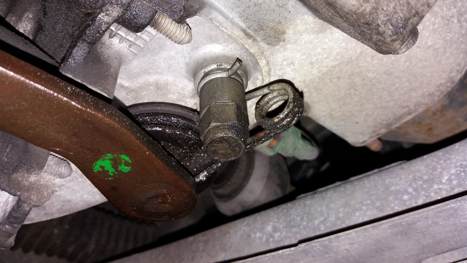

Just had a look under the car and noticed a bit of fresh oil on the bottom of the sump and fresh oil spots on the floor that looks to be coming from the gear linkage. That seal looks pretty shot, is it easy to fit a new seal?

It's cool, just trying to picture it.
Box has to be stripped for selector seal unless you use the repair kit.
strip and full rebuild is pricey, not looked a prices for a while but parts alone are nudging £300.
@bloke I saw PMS offer a rebuild service but it's £300 before parts, so around £600 for gearbox & maybe another £250 for clutch & flywheel. Hmmm I may drain the gearbox and see what the oil is like before doing anything else.
