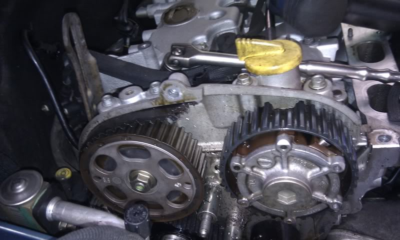

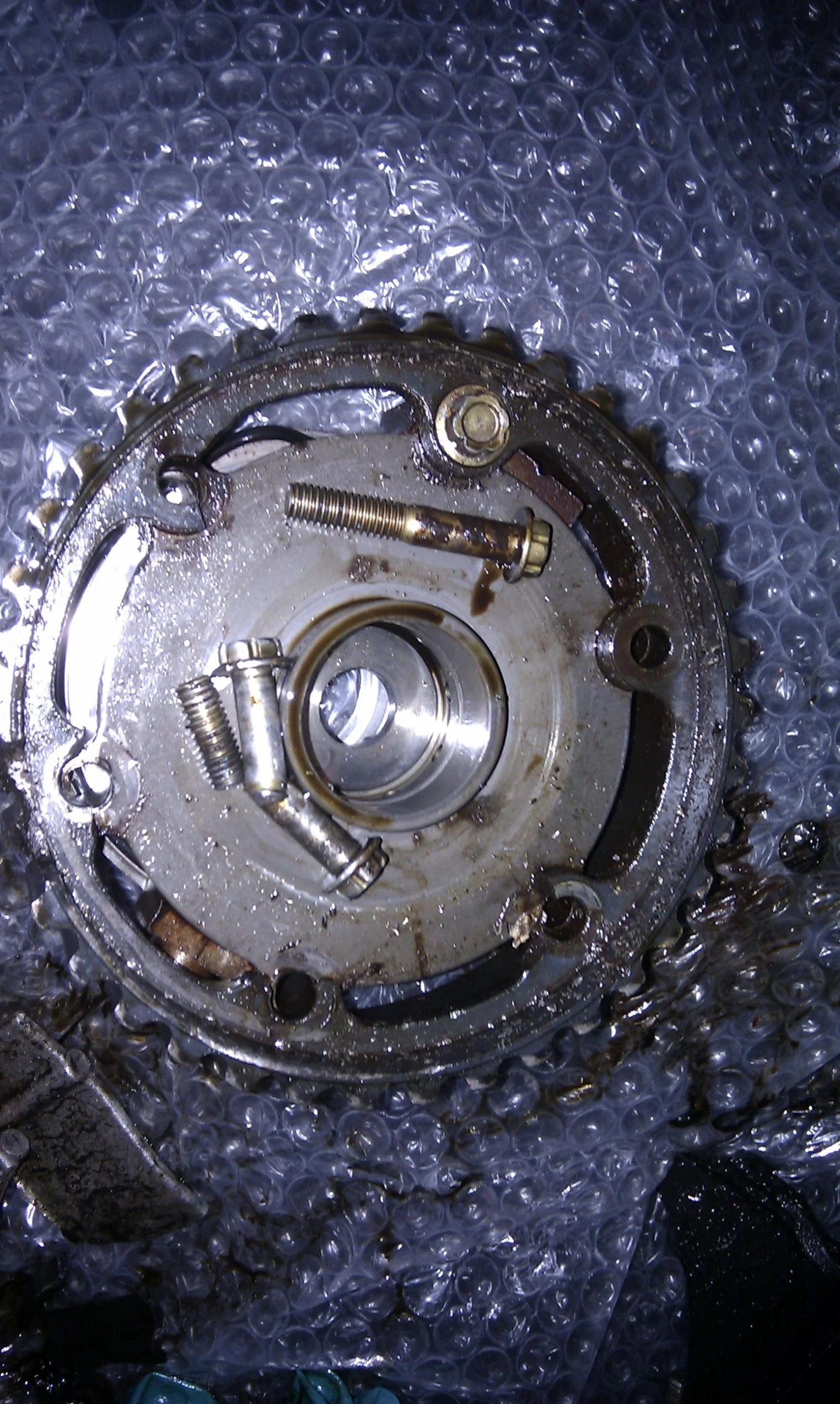

most of the time failures are down to shredded aux belts, shattered idler pulleys, or previous incorrect work meaning the pulleys slip. Very rare to see a belt actually break.
Does happen, but usually as in this picture it's down to poor workmanship
  DON'T SEND ME PM'S!!
the blanking cap on the dephaser was torqued up to an unreal level, and with no washer in place. the lugs where the bolts go through to hold the dephaser together all sheared off (I believe due to the massive over torque), the bolts worked their way out and jammed up, shattered the pulley and sliced the belt
