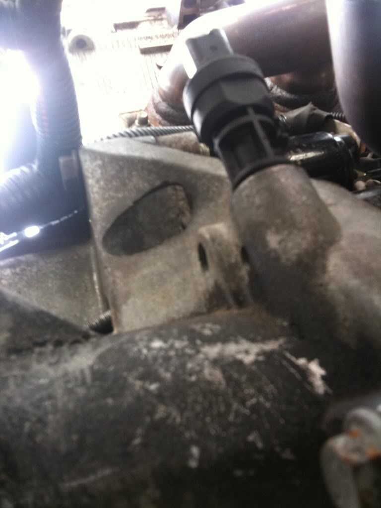

I did fine this though:
Is there a hole suppose to be there? i mean its rough so clearly not machined,
  Astra 1.9Cdti SRi
