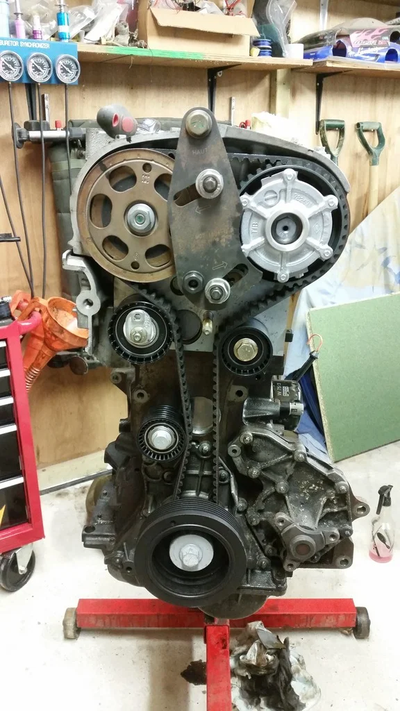

In the process of changing my cambelt, i've read the process many times over but i can't figure out if i'm missing a tool or doing something wrong. I'm trying to rotate the belt 6 times to check the tension, which tool should i use ? The manual says MOT 799-01 but i'm using MOT 1801. I can rotate it maybe half or 1 turn and then it gets REALLY stiff... too stiff for me to turn. Is there a technique to using MOT 1801 ?

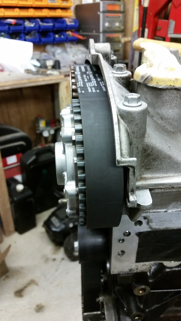

Also the belt is slowly moving towards the engine, why isn't it centering itself ?

What about the cambelt moving towards the engine ? Is it because the pulleys aren't tight or sitting flush ?
  dan's cast offs.
must just be pulley/s not seated fully? never had one do it. watch out though the exhaust cam can sometimes seem seated but isn't all the way on (if that makes sense)
you might want to check that the pulley locking tool it NOT engaged in the exhaust pulley ... looks very close in the photo .... you could even take the whole thing off to be sure it's not causing any issues...

So the tightening was the nut on the exhaust pulley tightening itself which stopped me rotating the cambelt. I couldn't stop the cambelt drifting towards the engine so i've tightened everything up to spec and rotated the engine via the crank.... All good now with no cambelt drifting, it's centered itself.
