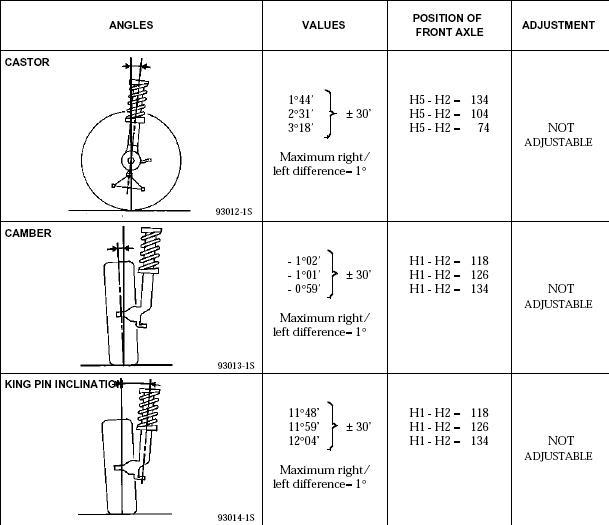

I have 172 ph1 with H&R coilovers (front 40-50mm lowered) and 15" rims. I bought camber correction bolts as i had too much negative camber.
What camber should i set on front? 1 degree negative on each wheel? Garage set it up 0.5 degree negative for now.
Is this 0.5 degree negative on each wheel factory setup for ph1? And should i go for some more negative camber?
or just measument of the wishbone length and length of strut with stadard suspension ? just some calculations i want to do for camber angle change due to lowering
