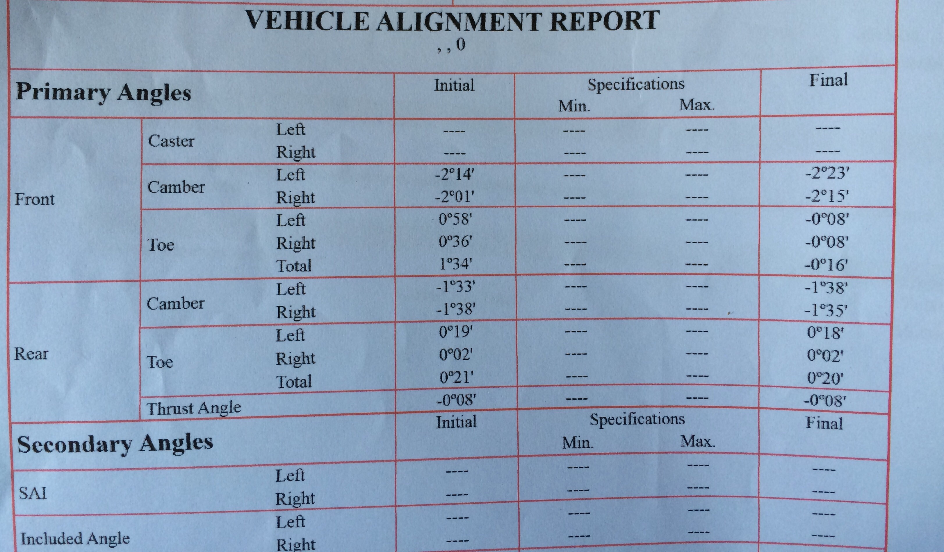

Hi guys had my b14 fitted yesterday and they said they could only get 1.1degree Camber on the front and I have eibach Camber bolts already he was saying I would need rose jointed wishbones or somthin how are you guys getting 2+ degrees

Just so I can go back to them with some info what should I be able to get on b14s camber bolts and pms top mounts

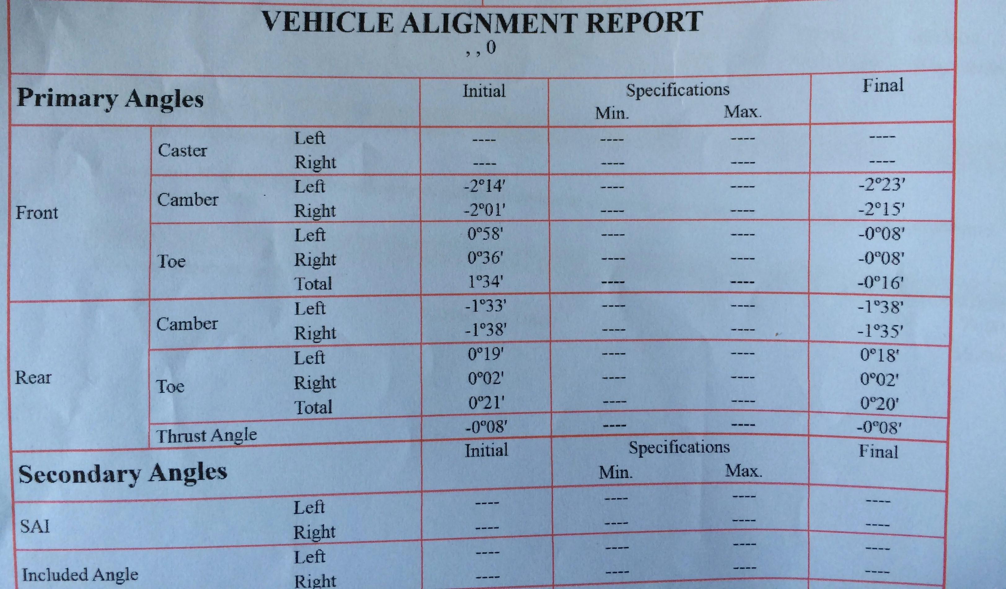

Can't help with the B14's specifically but these are my settings on cooksports, standard cup shocks, PMS solid top mounts and eibach camber bolts. I can't see why the B14's would be so much less adjustable.
I have b14's with camber bolts. My settings are around -1.5 on the front. The 'recommended' garage said to add more camber I need bolts. See above :(. I will be at some point run -2.5 ish. The rear is -2 but I have shims. Thinking outloud are the bolts in correctly, the tab iirc should be near the shock end if that makes sense mate

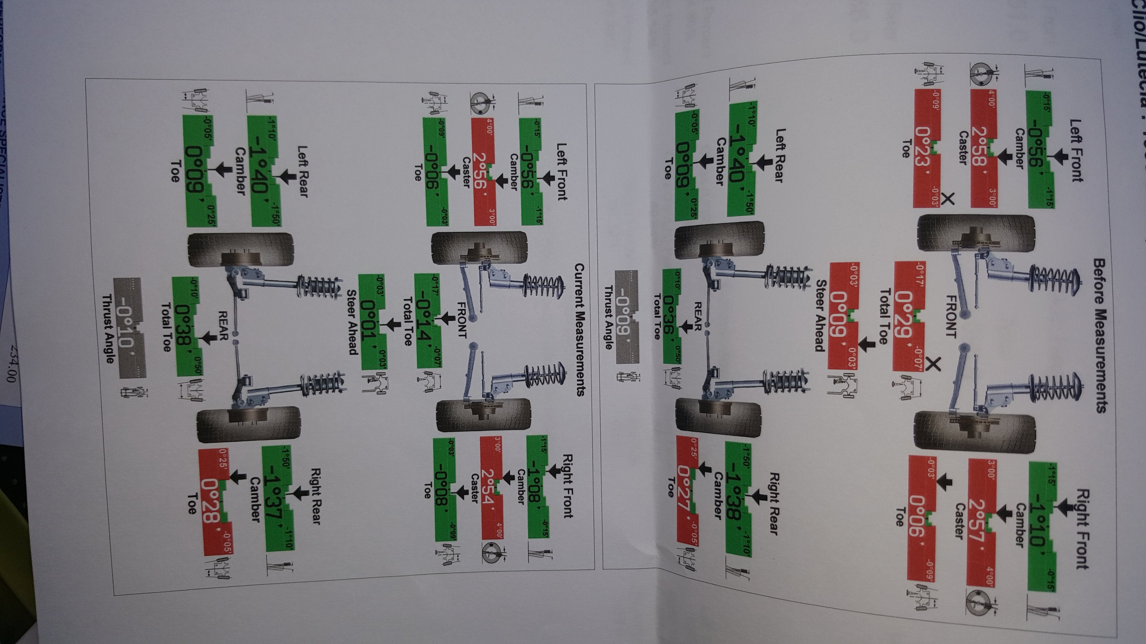

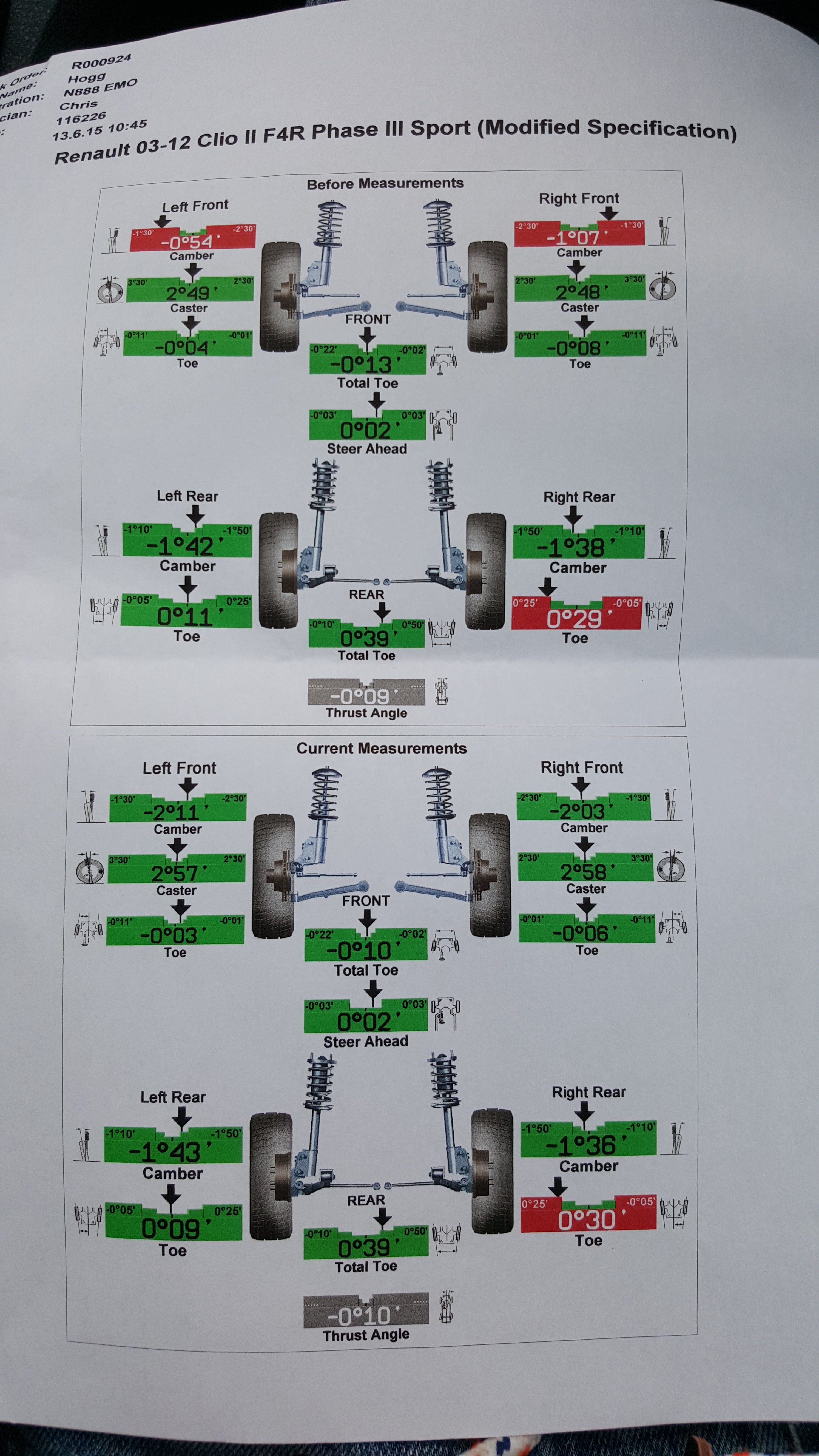

Thanks everyone for your help went back went back and got a couple of gremlins sorted now feels much better a lot more eager to scramble to the apex
