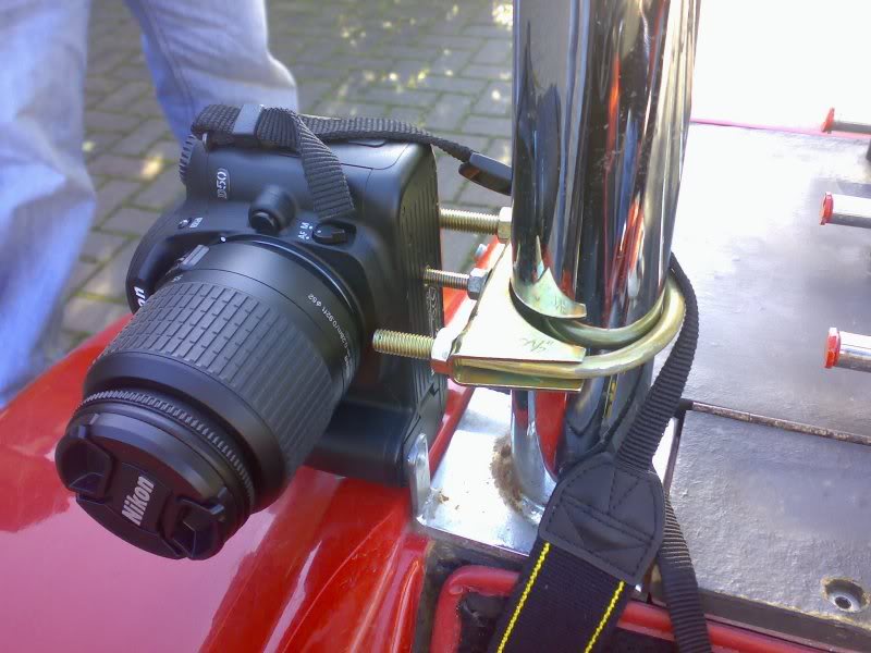

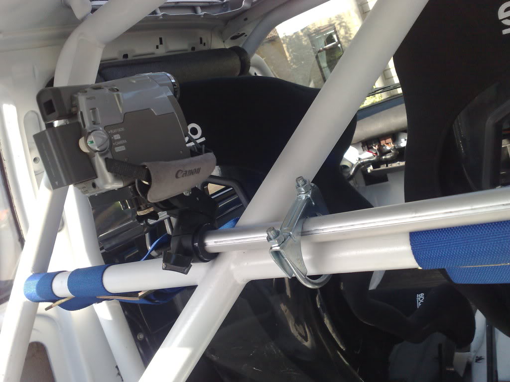

Myself and a few others have 'DIY'd it for cheap, using the head from a tripod and an exhaust clamp or two round the bar, solid as a rock, its worked fine on all the trackdays ive done!
