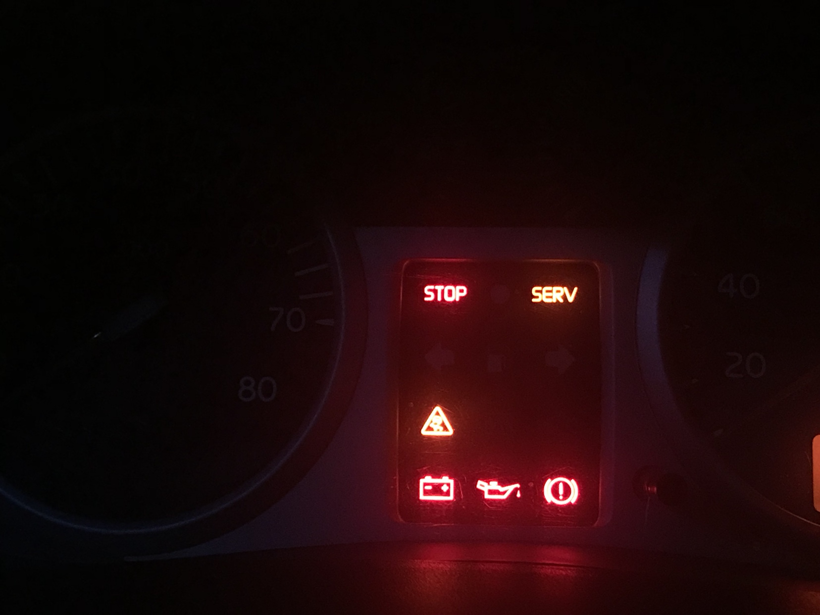

So I’ve had the issue for a couple months now, the ABS and serv light is constantly on
I’ve had it diagnosed and was driver side ABS sensor
I sourced a new working hub with new ABS sensor installed and I’m still getting the error
Is this an ECU problem or is there something else that could be wrong?

Was from when the front passenger bearing was changed. And garage noticed that driver side driveshaft needed replacing, which was replaced. Happened soon after that, but could also be conincidence?
Was on a friends diagnostic machine where we picked up the fault. Then also has a rstuner which also picked up the fault

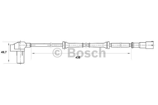

I did get a replacement ABS sensor but I’ve not used it as the new hub had a working sensor on there.
I got the Bosch one which was the same part number as the Renault one, for sale as no need actually
What is the part number of the Bosch sensor you have not fitted, but intend to sell on?
Either the Bosch or Renault number will do.
The replacement hub had a sensor with a male or female connection to the loom under the wheel arch?

With regards the abs sensor you have, 7700411747, it will have a 2 pin round female connector.
Can you confirm that this is the connection on the car, and not a more rectangular connector?
