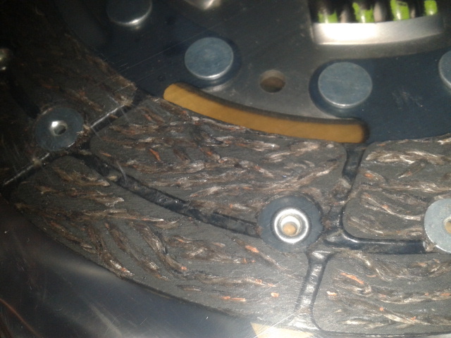

Really? I used my 4 paddle for 2 years and it was fine. No noises, and drove like standard. Only time you noticed was on a hill start....
Friction disc

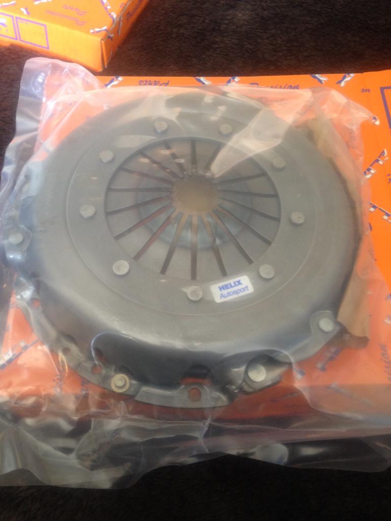

Pressure plate

Uprated helix cover, and standard plate is the best option, bit heavier pedal than standard but fundamentally still drives the same.
The 6 paddle then can be used later on with the same cover if you need it to handle more power.
