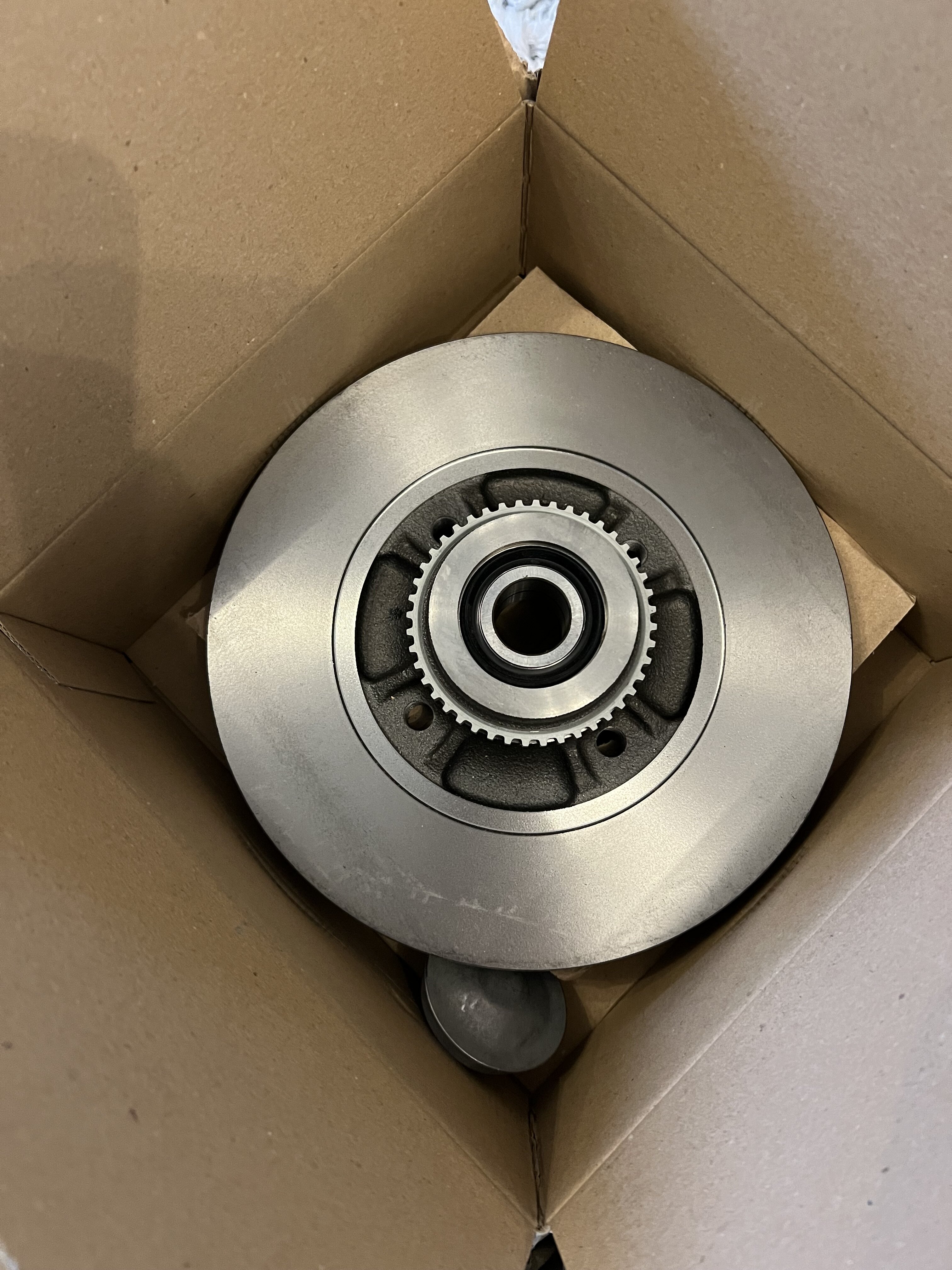

Typically the f**king discs turned up midday whilst I was down at the unit. So haven’t managed to replace the rear brakes.
