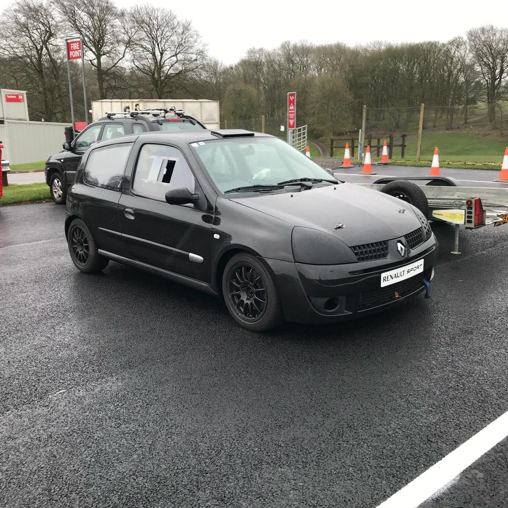

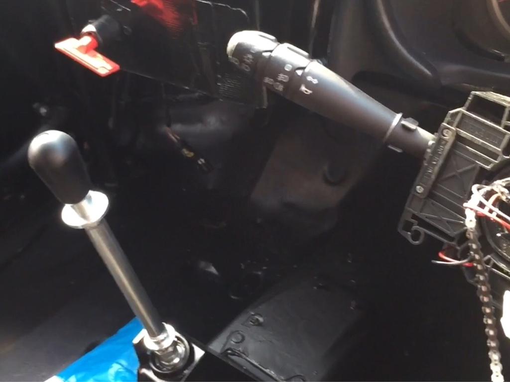

Managed to get a half day in at Teesside Autodrome to test the new shifter and roof scoop. Really warm day and the scoop worked a treat. Looking forward to the next Trackday at Cadwell now.

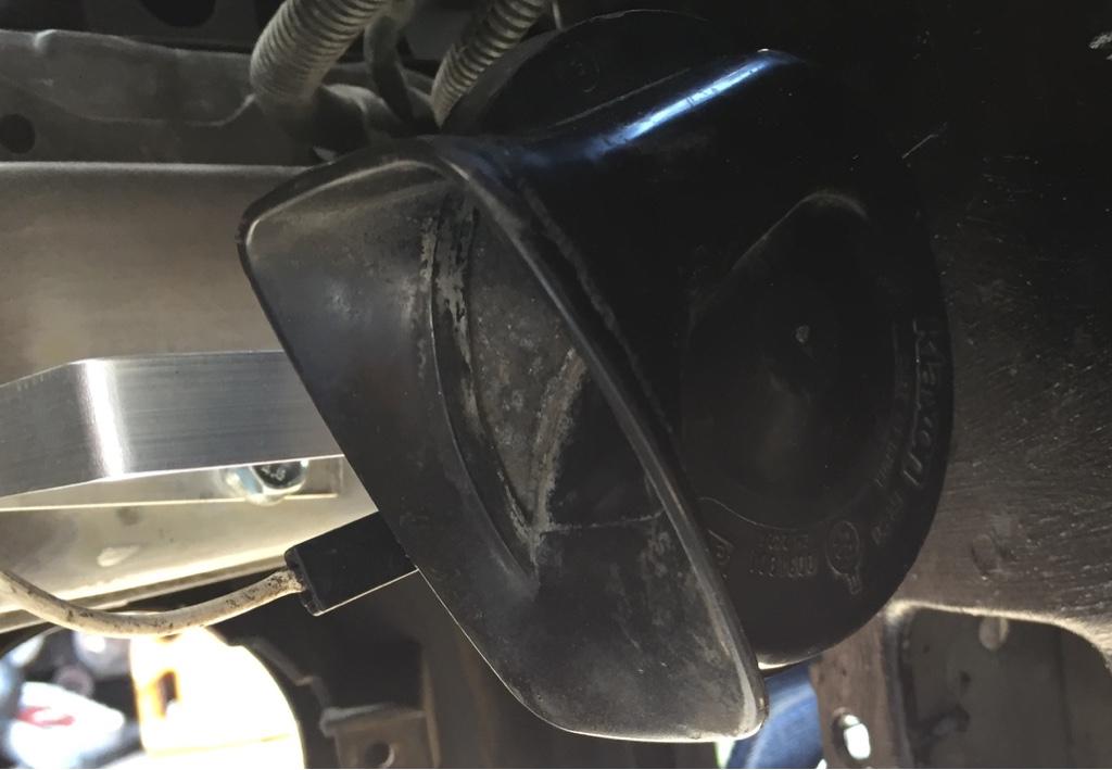

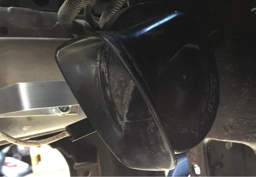

First thing I noticed was the car didn’t have a horn. I’d also removed the original wheel so needed to source a PH1 stalk, then wire up the horn. Found both locally, the car flew it’s test. Happy days.

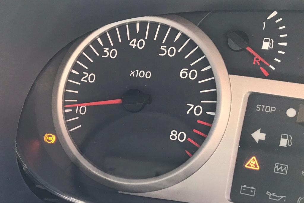

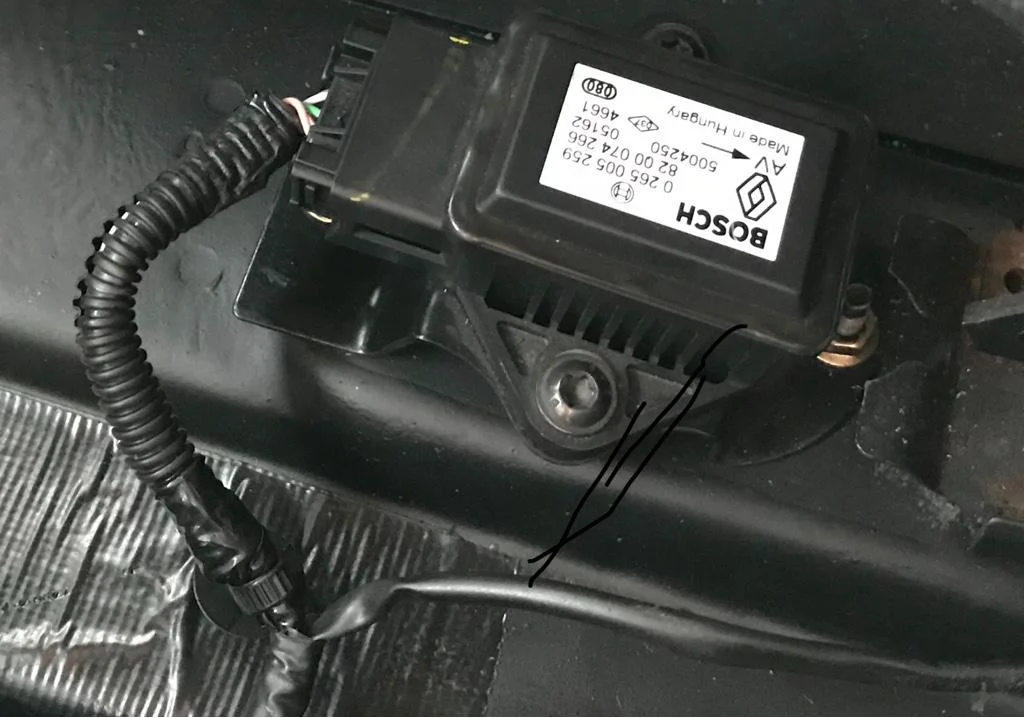

One nagging issue which kept coming up was the ESP light and then occasionally the ABS warning light.
Pretty much everything on the car from suspension through to brakes had been changed for original parts, including ABS rings and all round wheel sensors. Tons of suggestions from forum members, Clip diagnostics, trips to Kris at Ren Sport and 3 replacement angle sensors failed to cure the problem. You name it, we tried it.
I’m not that bothered about ESP as the car is for track only, but I prefer to have ABS.
Then a random message from Adam Stuck regarding a replacement ESP module got me thinking. When I painted the interior I remember removing this small box from near the handbrake and then sticking it under the dash out of the way with a cable tie. [emoji85]
Say no more! [emoji23] But it just goes to show how difficult it is for others to solve mechanical problems over the internet, although Kris Dark has no excuses [emoji87][emoji23]

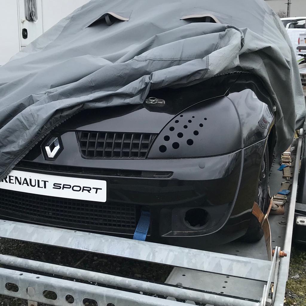

Enroute to Nürburgring via the ferry. Meeting some friends over there who’ve decided to take the Chunnel...again! Sod that, been there, got the t-shirt.

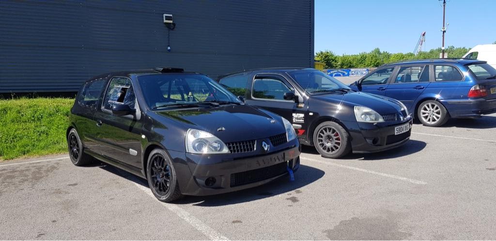

Met up with the possee. Note my road going 182 on the left. Sold it to a mate to do the ring, then bought it back. Long story.

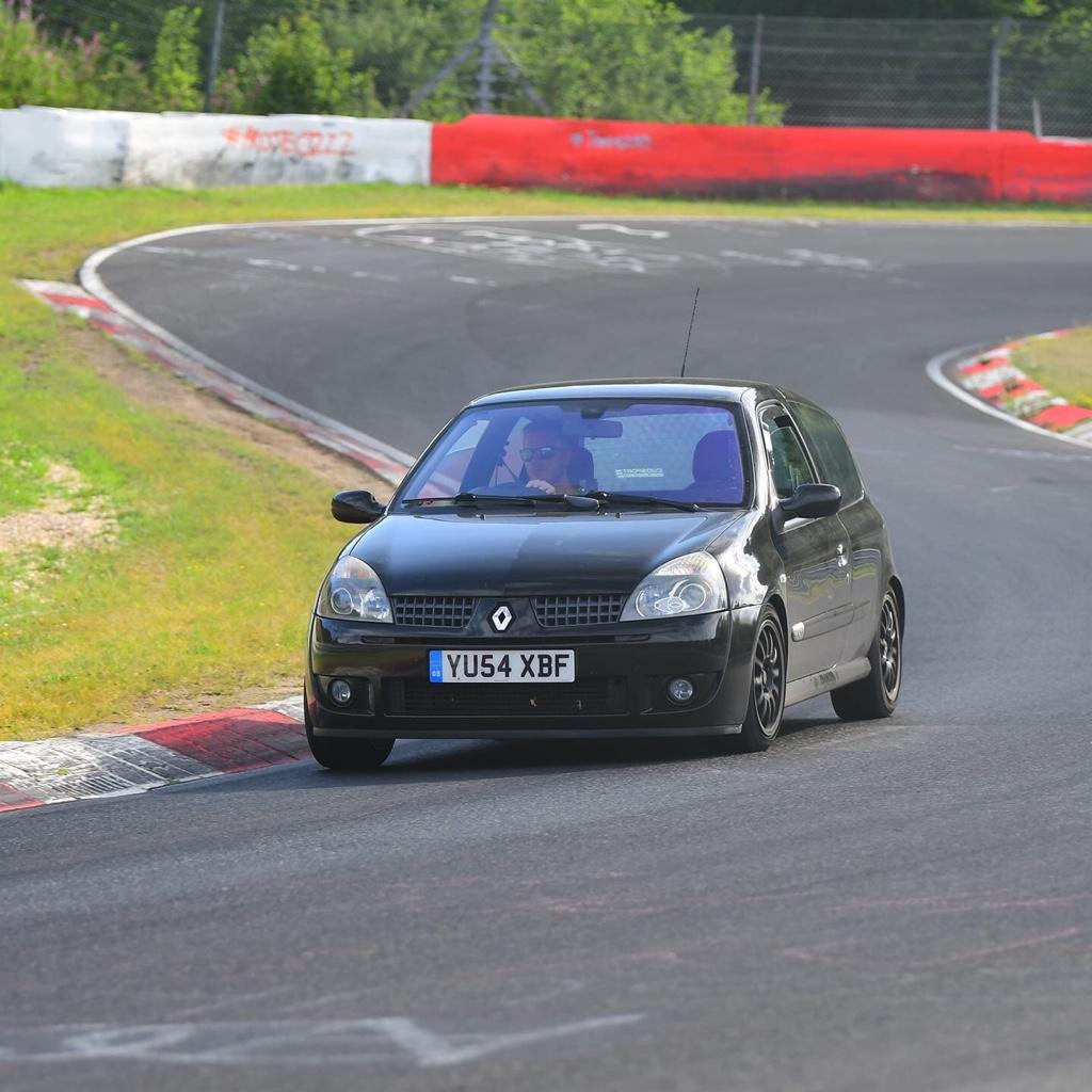

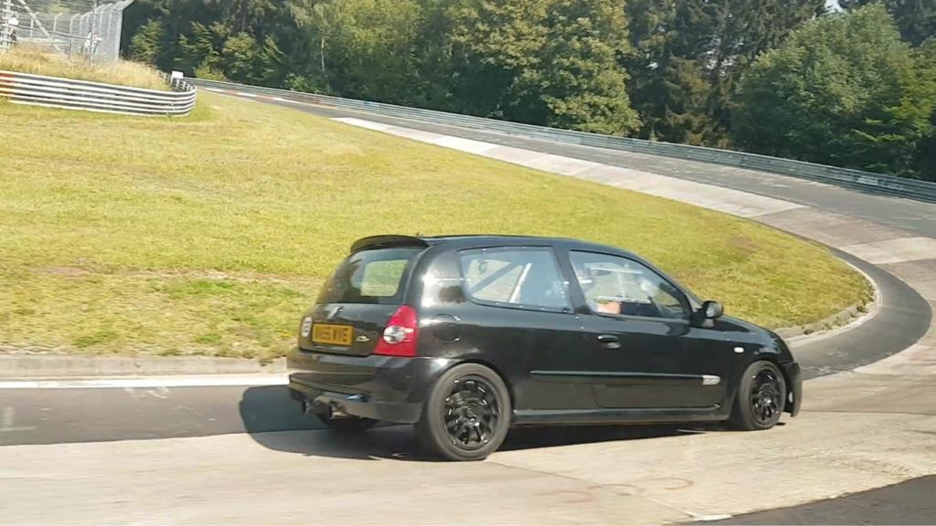

Got some decent laps in. Picture of me from my mates car as he bottled it going into Karussell [emoji23]
Obligatory Karussell shot.

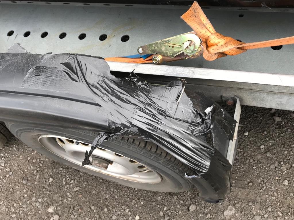

And a blowout 2 miles outside of Rotterdam. My fault rushing back to catch the ferry home in 90 degree heat.

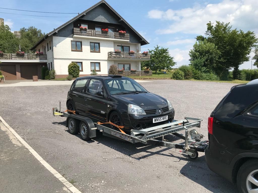

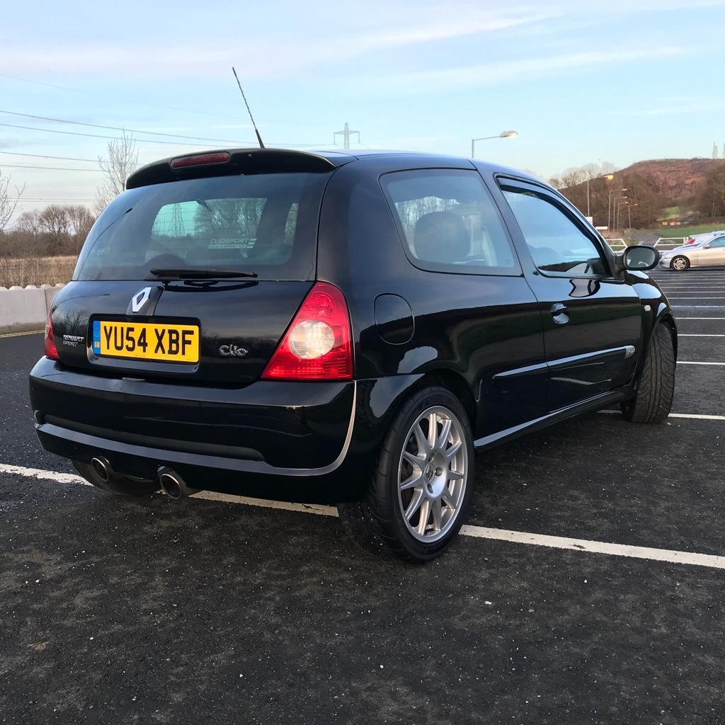

After our trip to the ring it was time to buy my 182 daily back and get it up to scratch. Although it looks good from a distance, a lot of panels are either rusted, dented beyond repair or keyed/scratched.
Mechanically it’s sketchy, although I’m confident it’s a decent engine, it gave my mate more than a few issues during and after the ring trip. Plus he’s fitted a lot of aftermarket parts and had his monkey mechanic on the job. It’s also come back to me with an issue where it just cuts out for no reason and then randomly won’t start.
Time to give her some TLC.

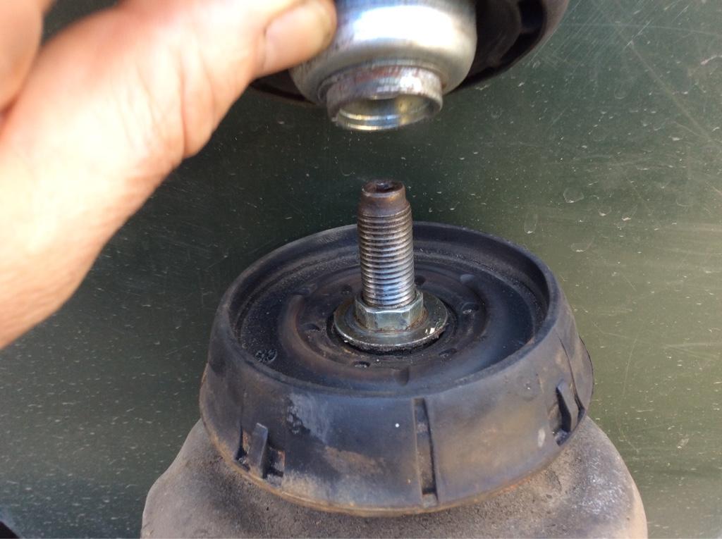

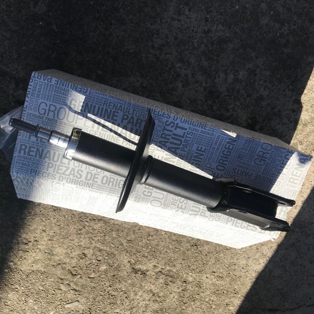

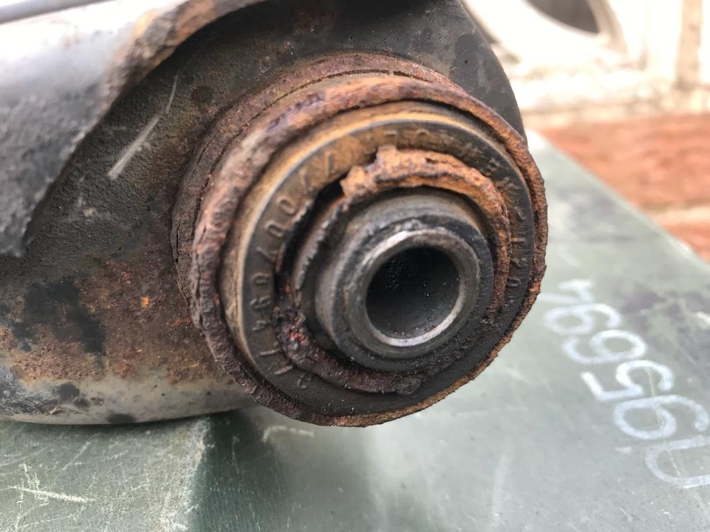

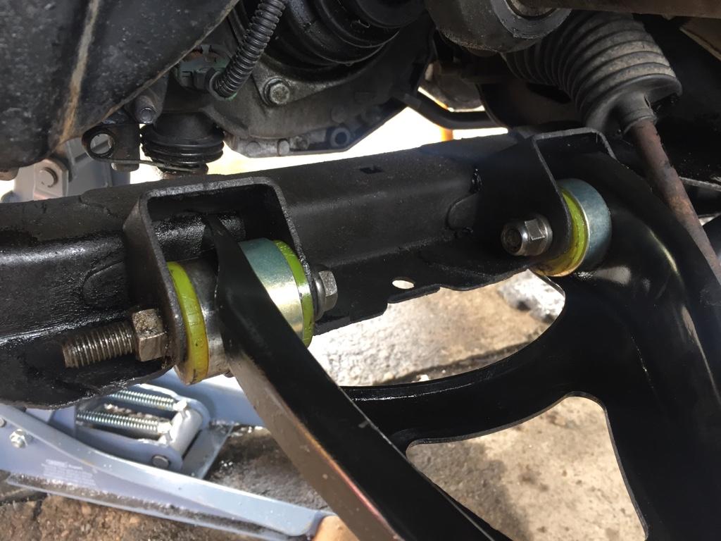

I decided to totally refresh the suspension with new cup dampers and springs. While I’m at it I might as well replace top mounts and put the new spacers in as well.
I want the ride to be softer and handling to be more progressive, like it was when it left the factory, as I plan on using it as a daily.
I’m a big fan of Strongflex bushes and prefer these to Powerflex - much cheaper too. So it’s out with the rusty old bushes and in with the Yellow series. Gave the wishbones a good clean up and a good few coats of pant.
Did the ARB bushes as well. Much easier than last time.

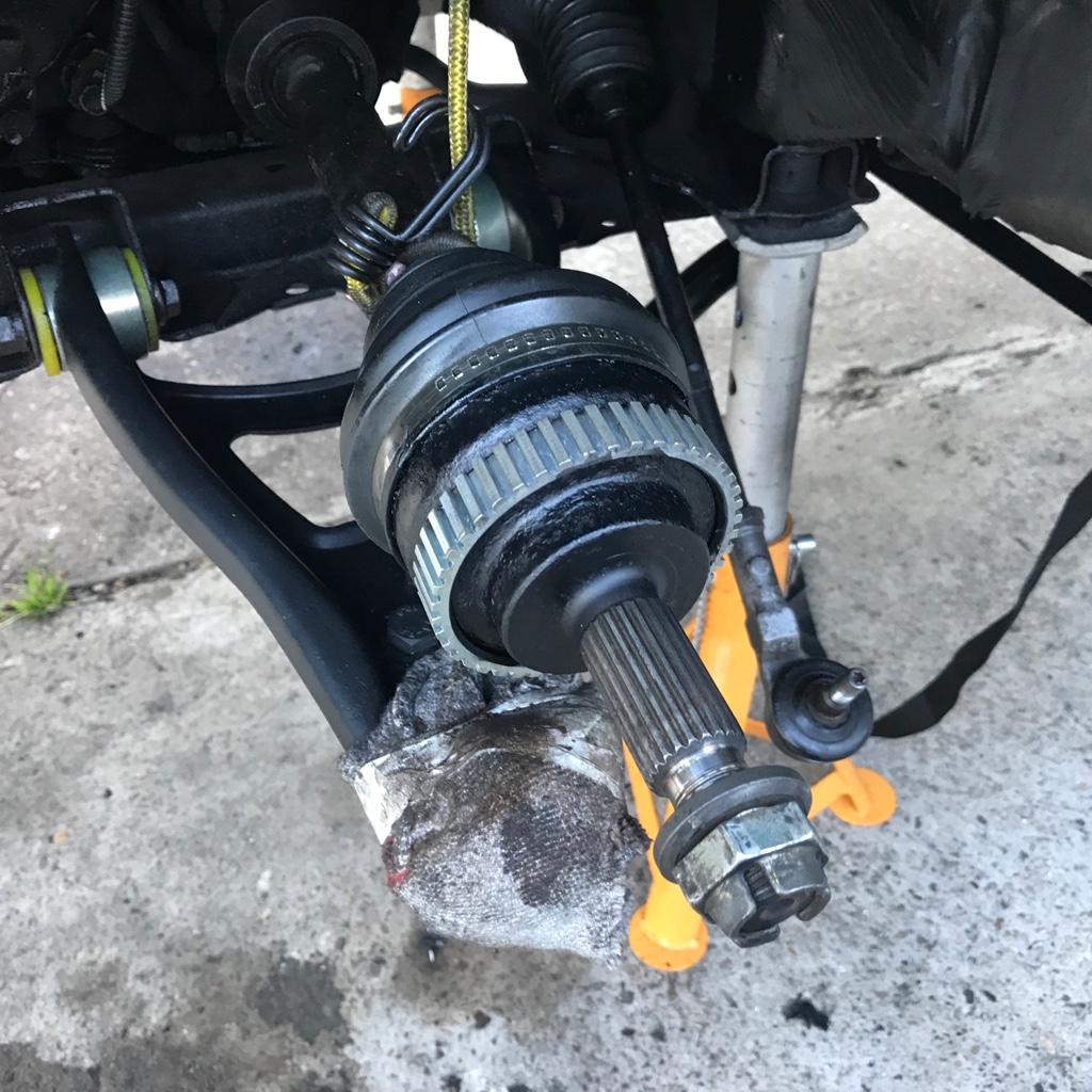

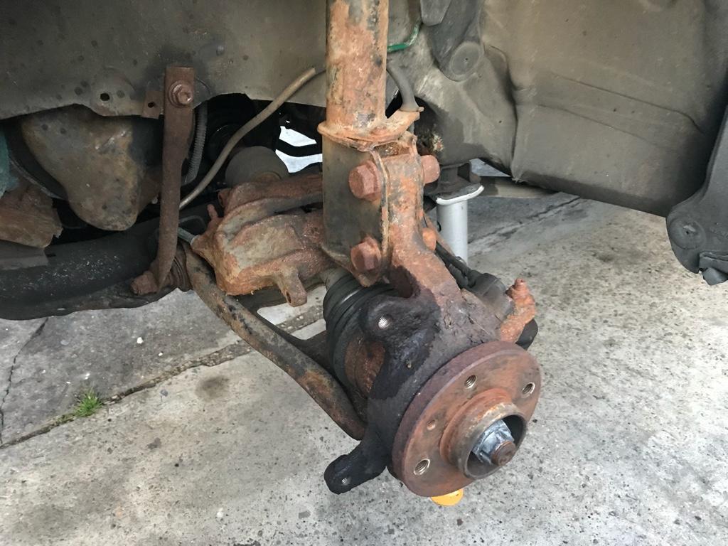

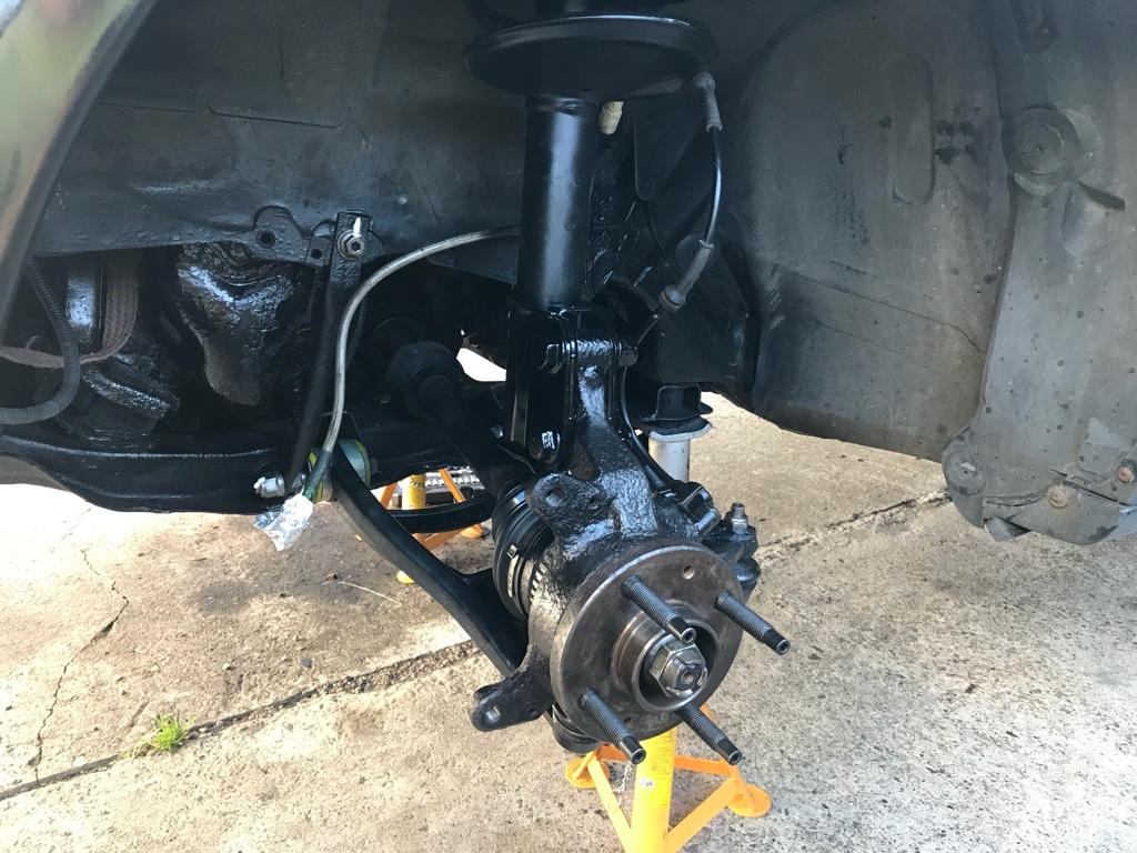

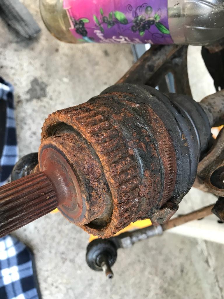

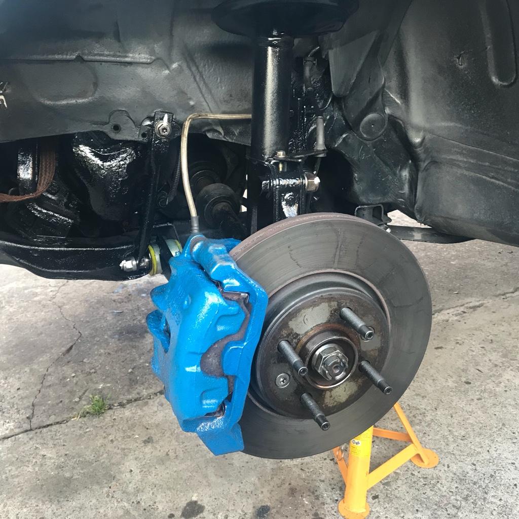

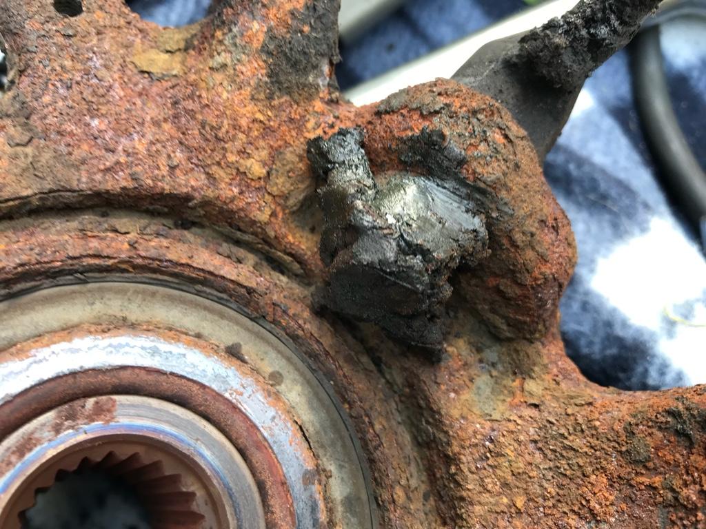

Stripped the hubs, callipers and replaced the ABS rings. Attacked everything with a wire wheel and then applied a few coats of paint, a bit of hammerite and it’s all looking nice and fresh. New track rod ends, ball joints, wheel sensors, pretty much replaced everything except the discs.
I had a spare PMS stud nut kit (68mm) off the track car so fitted that as I plan on using my spare Pro Race 1.2’s for now.

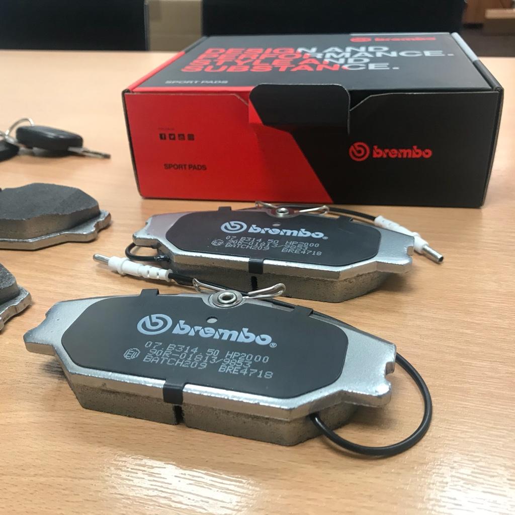

Replaced the PBS pads with a set of Brembo Sports Pads. They’re much better than the Brembo OEM replacements and give you more confidence when giving it some on B roads.

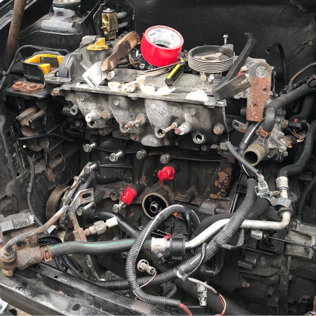

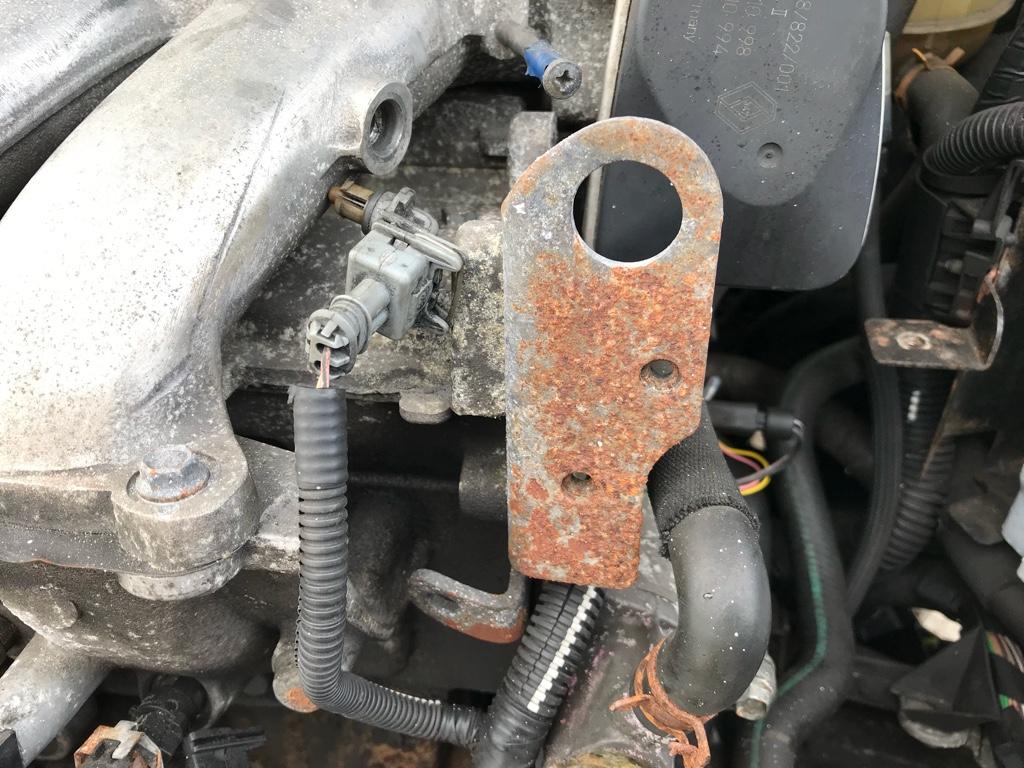

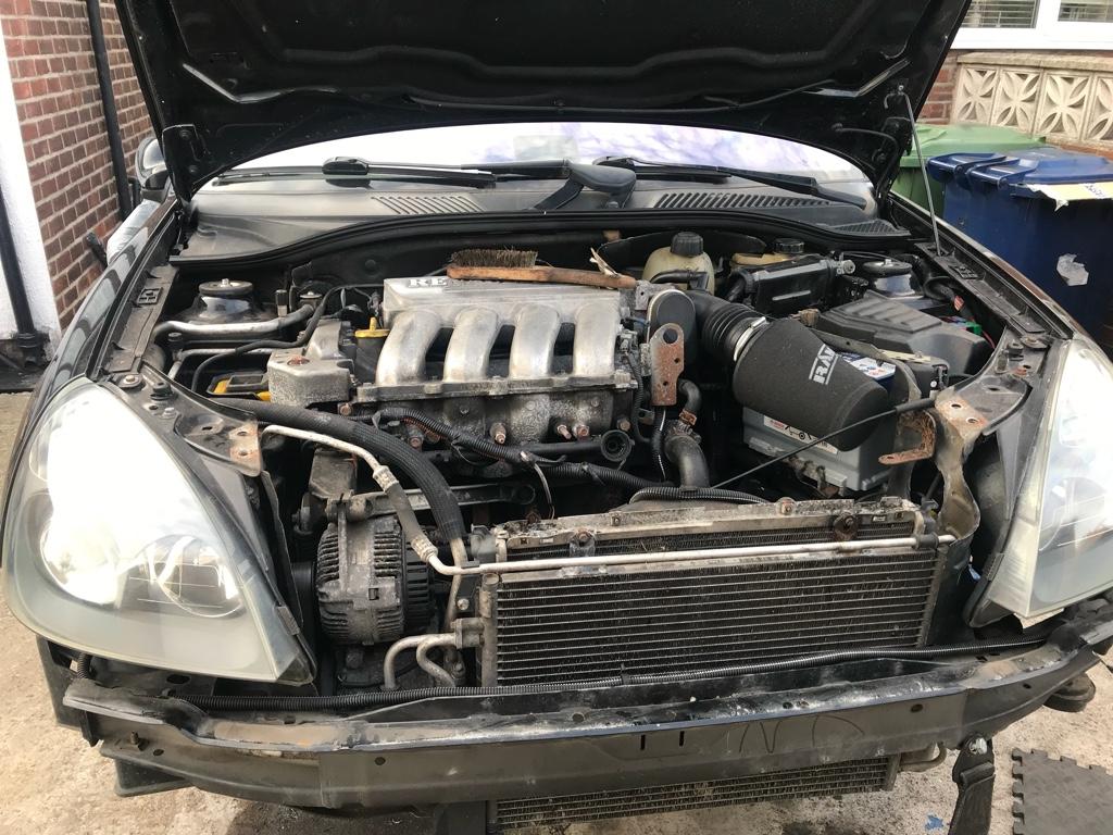

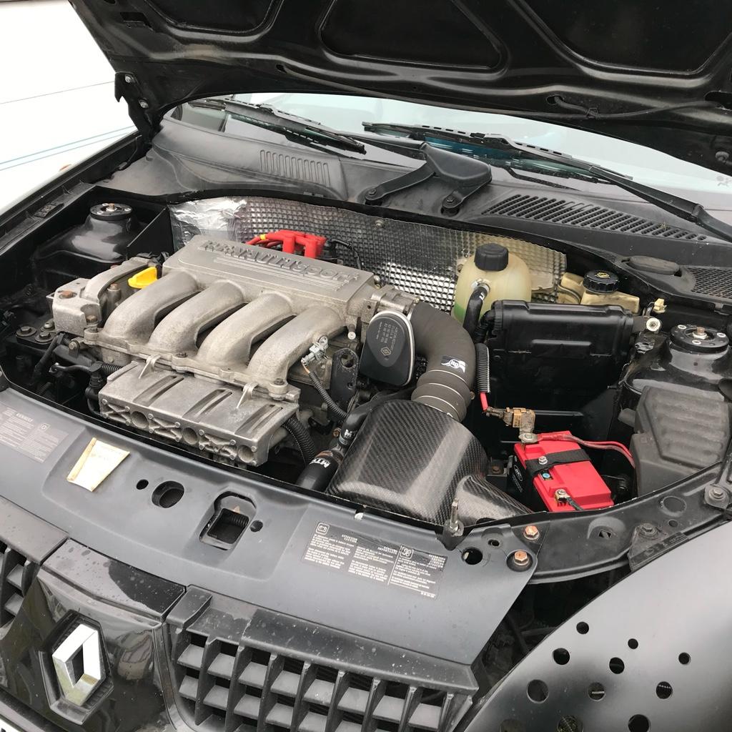

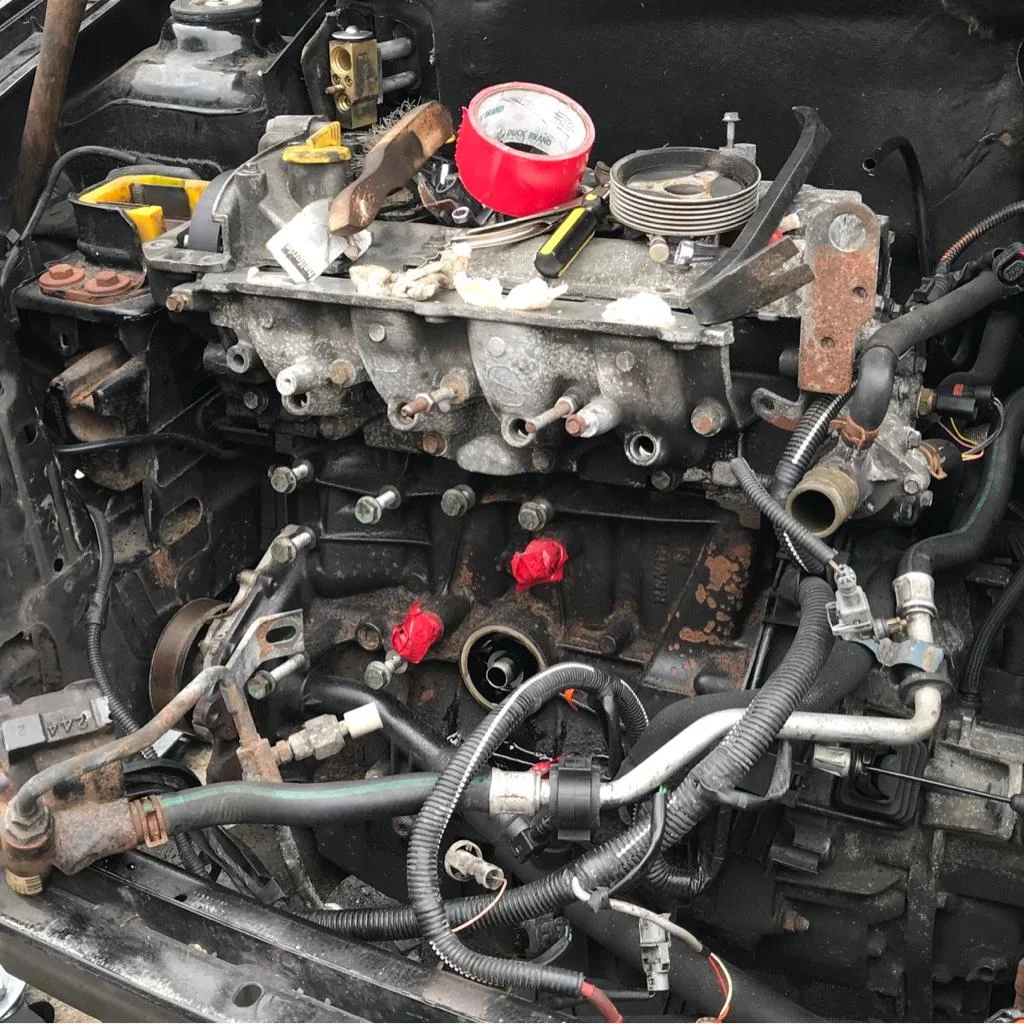

Time to tackle this engine, give it a clean up and a good service and sort these cutting out issues.

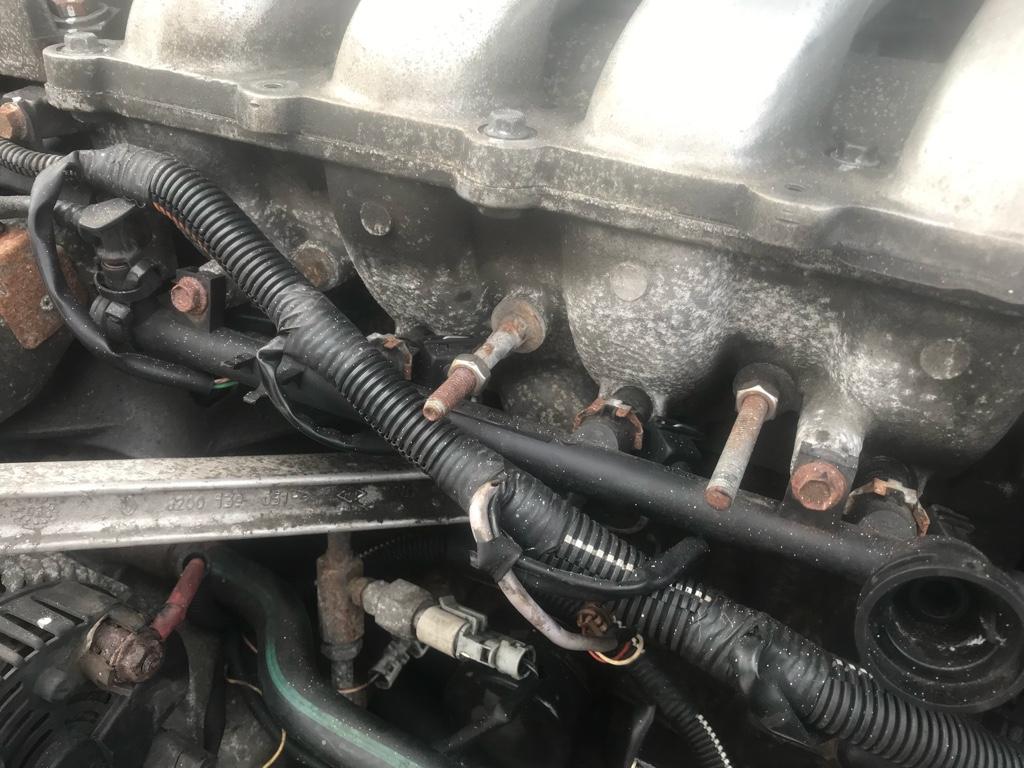

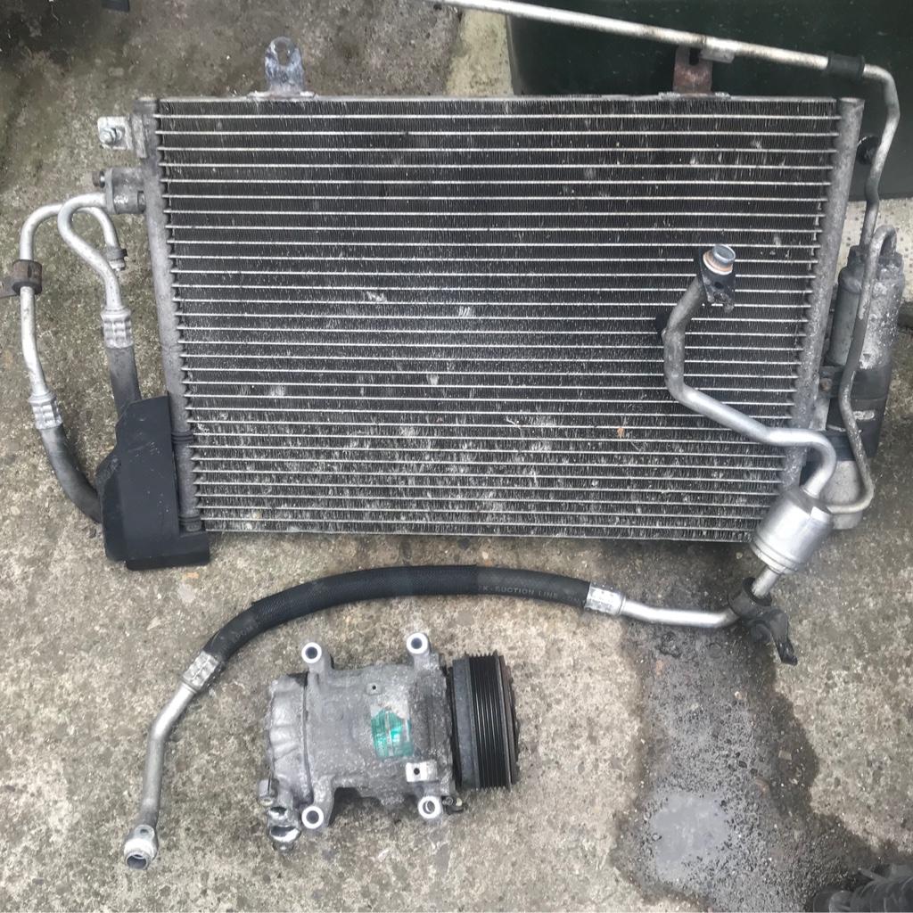

It’s a proper dirty engine and bay. Air condition is knackered so that’s coming out. Has one of those awful Ramair filters so I’ve sourced original airbox.
But when it’s not cutting out, the engine feels pretty solid and it’s had the all important cambelt, dephaser, auxiliary belts and water pump done when I first bought it. Basically I’m just going to strip everything back, replace all non genuine parts and give it a proper look over and clean up.

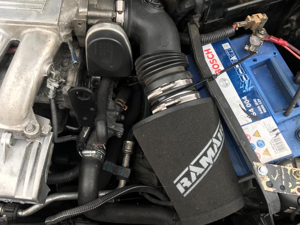

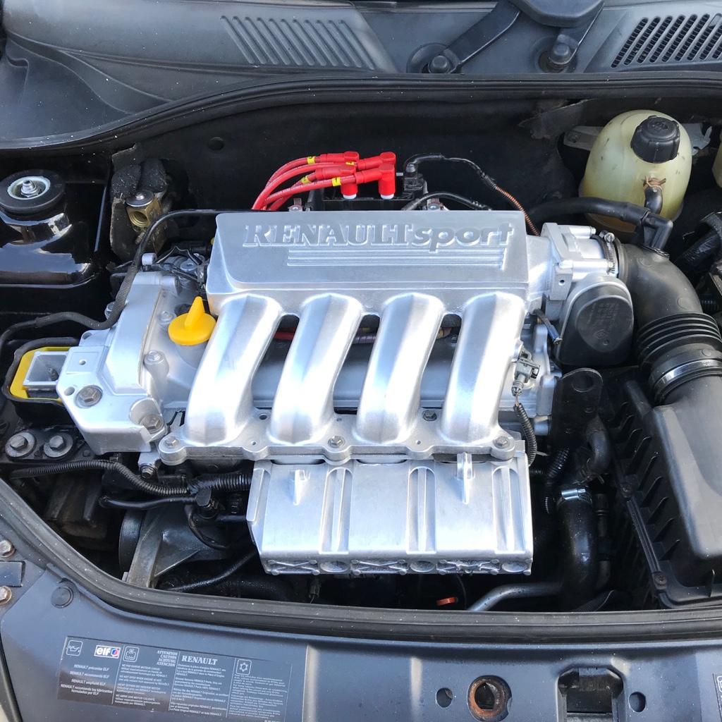

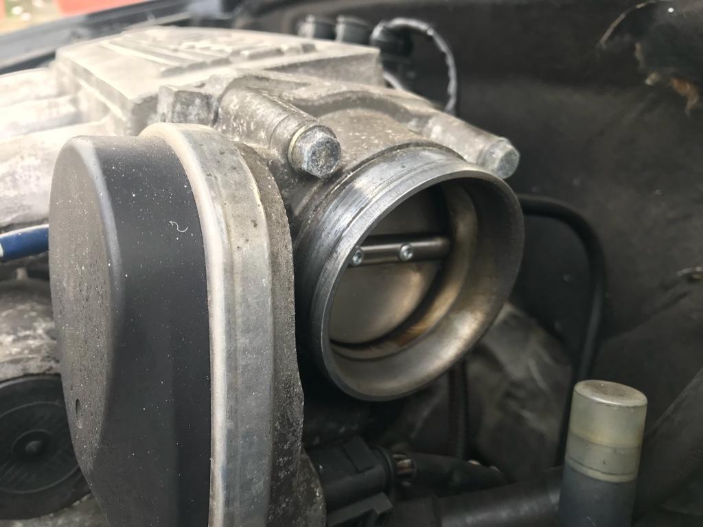

Stripped everything back, checked wiring loom, ran diagnostics, cleaned throttle bodies, changed oils, plugs, leads, TDC sensors, cleaned up all the earths, replaced Bosch injectors with Magnetti Marellis and put a new fuel line in as it was held on with a cable tie.
If you can think it, I checked it. Gave the engine a rub down and a lick of paint, changed the battery and gave the bay a good tidy up.
A quick run up the road with the old 16” wheels and it’s a different car. The ride is nice and smooth and everything feels lovely and tight.
All the warning lights have gone out and the engine is ticking over beautifully and feels pretty responsive.
A quick wash over and it’s not looking too bad, although we’re not finished yet.

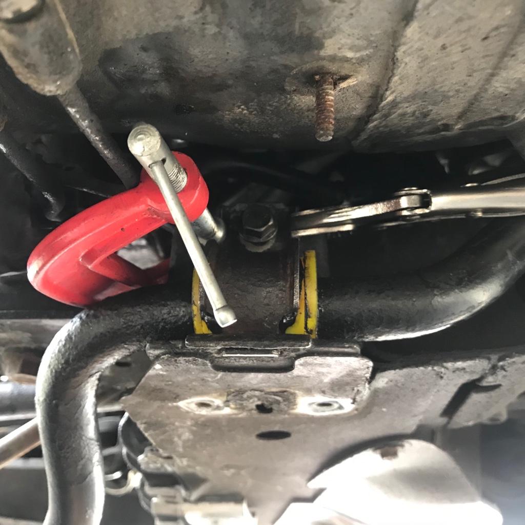

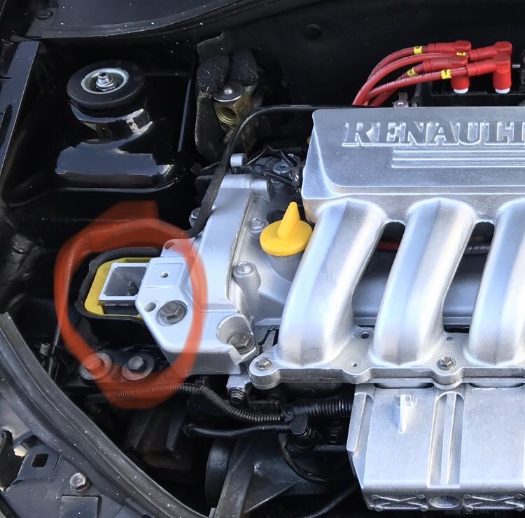

After a week driving the car back and forth to work, the cutting out issue seems to have been resolved. The car starts off the bat, so far so good.

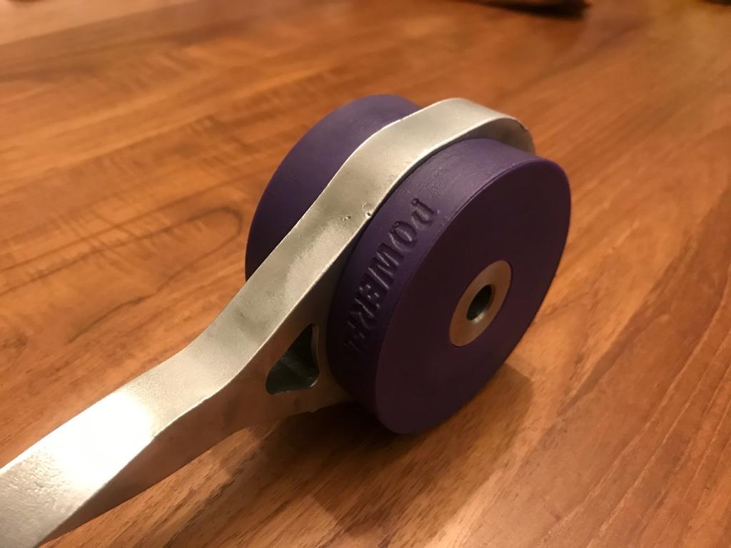

There’s still some vibration coming through the steering and dash so time to ditch the Powerflex bushes on the dog bone mount and upper engine mount. I replaced these with brand new genuine parts. Vibration gone, car feels even better to drive. Happy days.

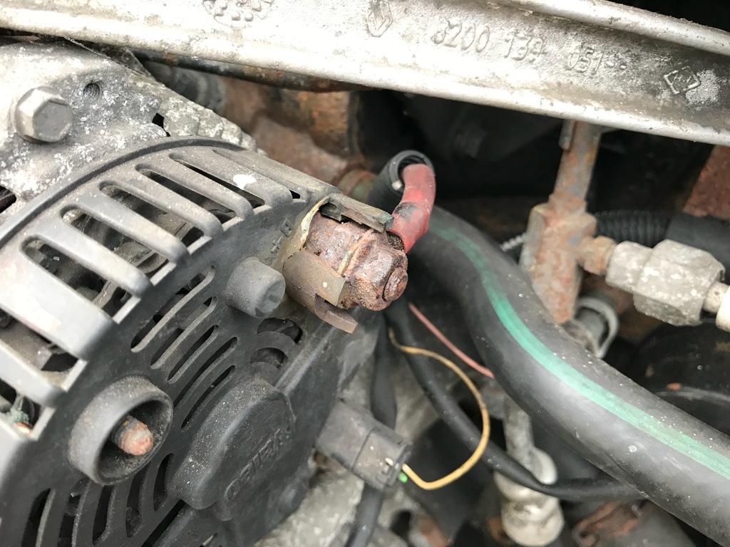

A thousand miles in and the car hadn’t skipped a beat until one evening the engine wouldn’t crank. Other than the cutting out issue this was also a problem.
Went through the car again with a fine tooth comb and everything seemed ok. The only thing I could think of was the alarm, fitted when new, which occasionally played up.
I called out an auto electrician who also checked everything over and in the end decided to remove the immobiliser part of the alarm as he suspected it was disabling the connection to the starter motor.
Since then I’ve done another 2,000 miles with zero issues so maybe we’ve finally sorted it.

Did you try just taking off the engine mount? No sound with powerflex black dogbone mount for me
I did but the engine mount was in pretty poor condition so just replaced it. It wasn’t bad vibration with it on but I’m getting on and do like a little bit of comfort.

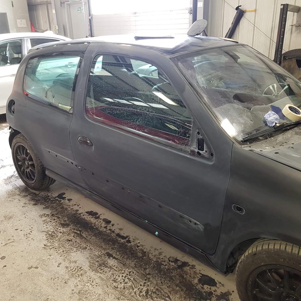

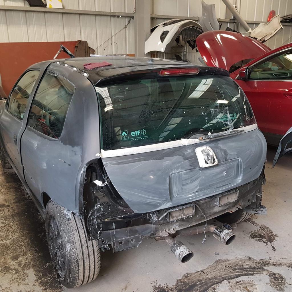

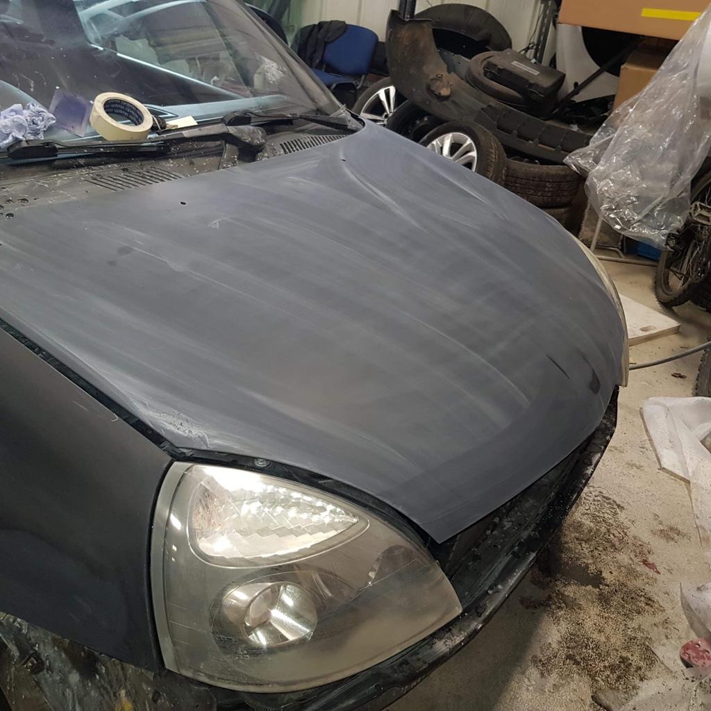

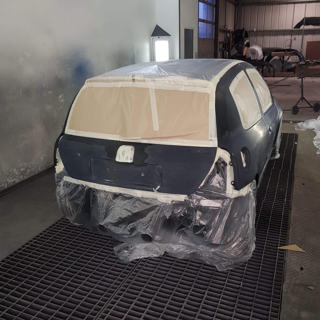

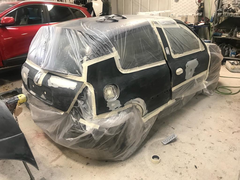

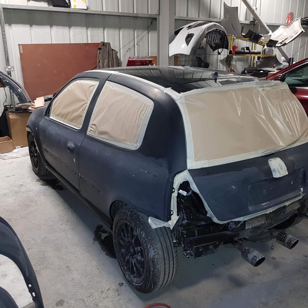

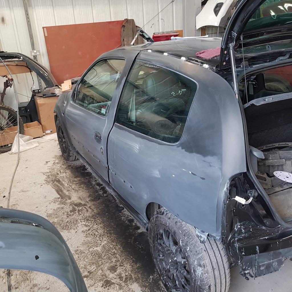

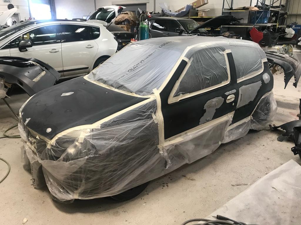

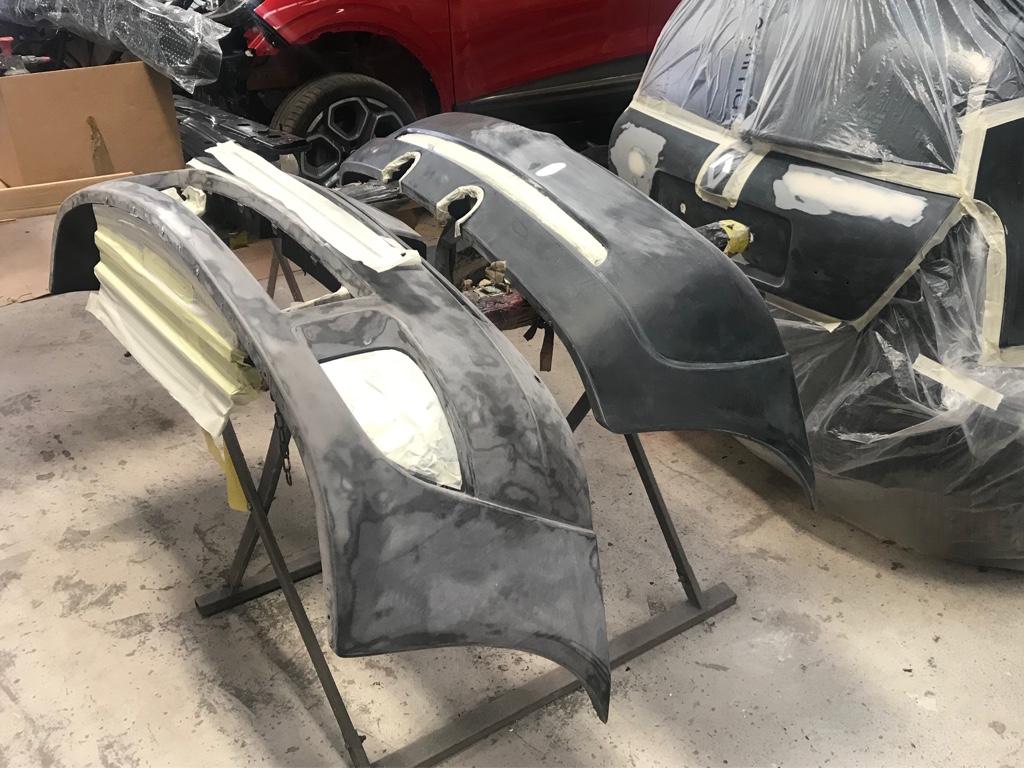

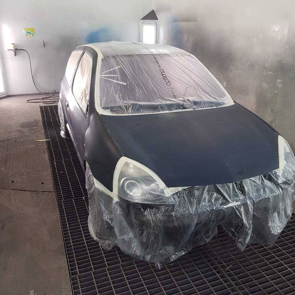

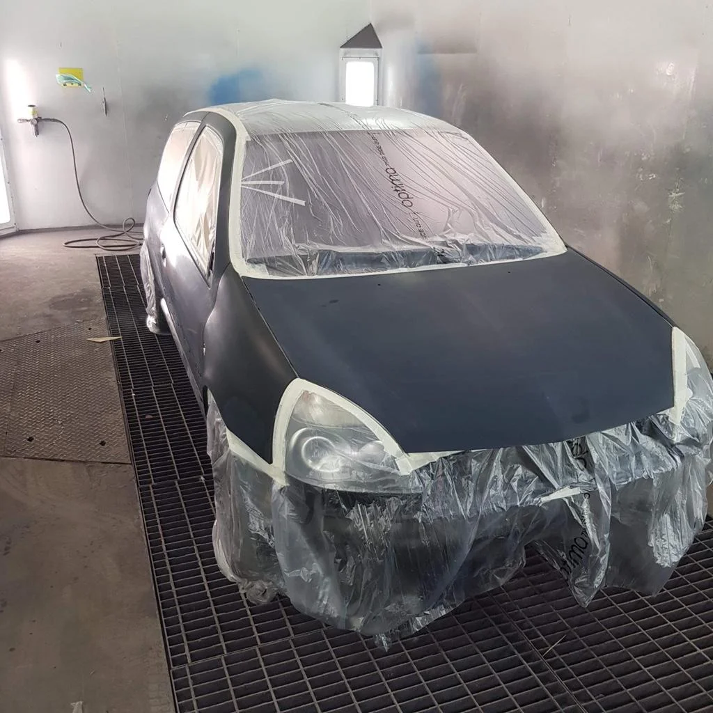

With the car now covering 3,500 miles without fault it was time to address the bodywork. I’d sourced a rust free bonnet and a straight passenger door and swapped those over.
Now to get it into paint. I work in a large dealership who have a superb Bodyshop. There’s a guy there who restores the bosses collection of classic cars, so I handed him the keys and he set about it.
At first we were just going to correct a few panels but decided to do everything but the roof which was in good order.
One of the things that I liked about this car, other than the obvious neglect and running issues, was how solid underneath it was. I knew it would make a car with some commitment.

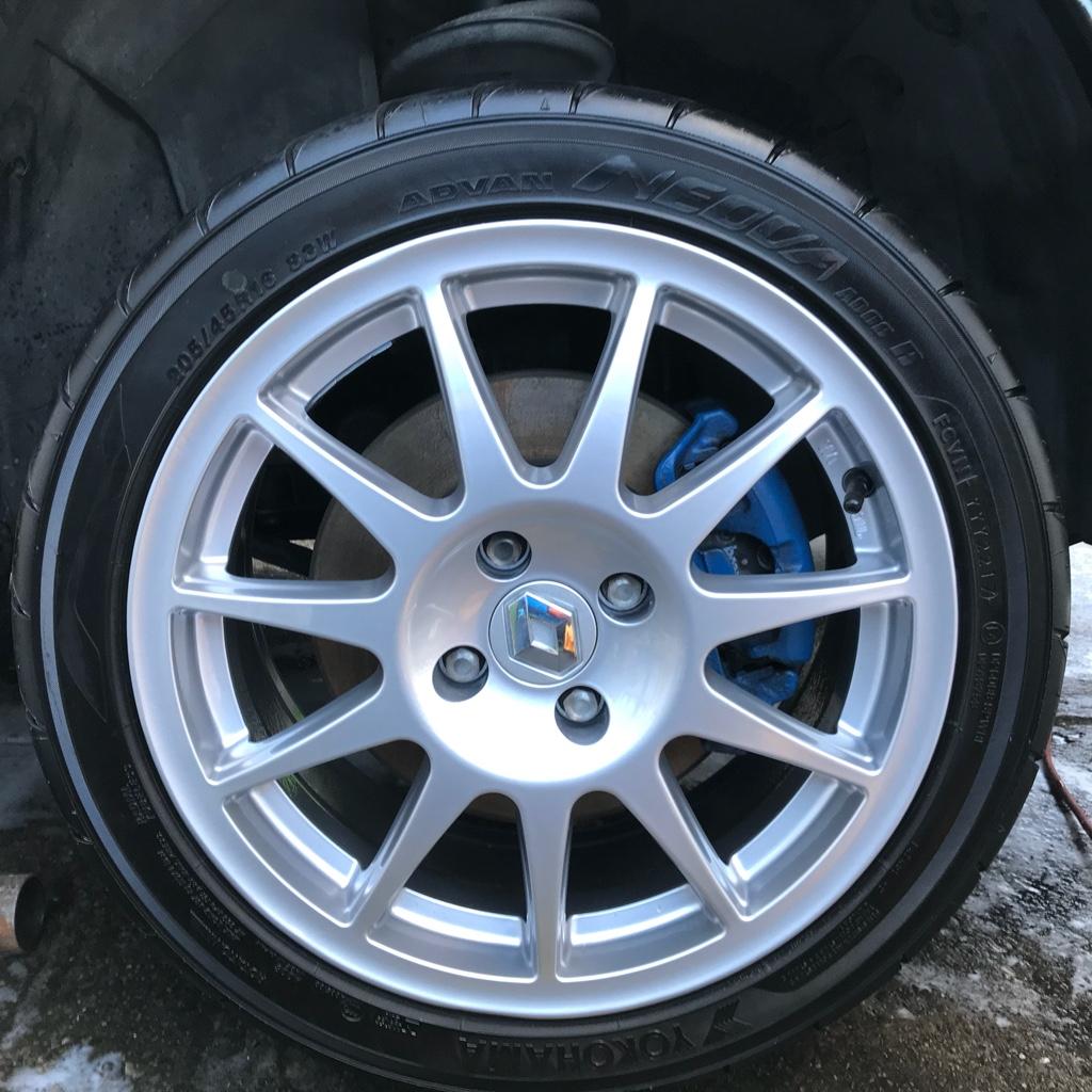

Whilst in the bodyshop I’d sourced some 16” Turini’s from a 172 Cup. The plan has always been to take the car back to as close to factory as possible, but I’m not a fan of the cup wheels, so Turini’s seemed the next logical step.

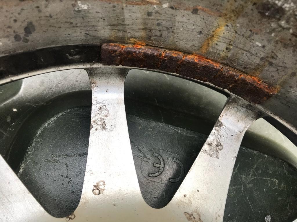

Most of the wheels were pretty beaten up but straight so i sent them off to Romax for refurbishment.
One in particular was proper rusty and corroded.
But they turned out superb in the end.
I had some 205/45/16 Yokohama’s from the cup wheels so these worked perfectly for now.

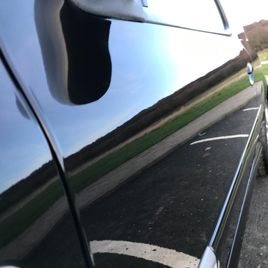

A week on so decided to give her some protection.

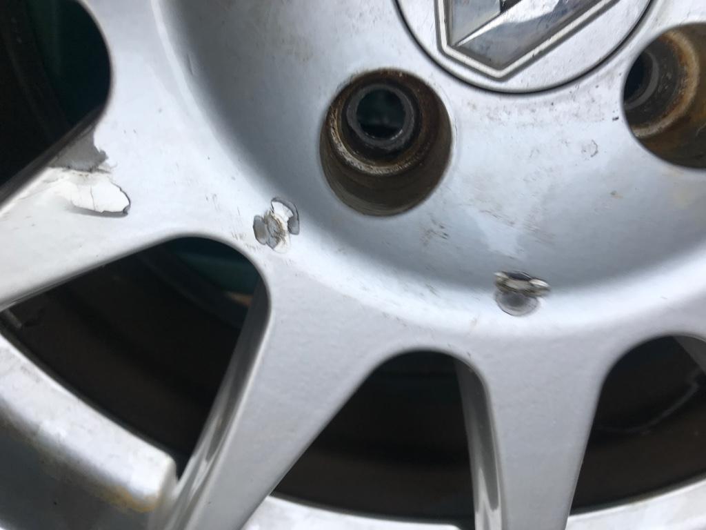

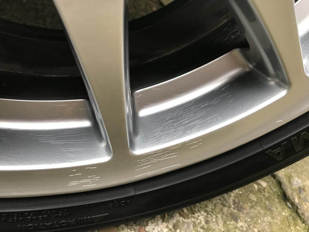

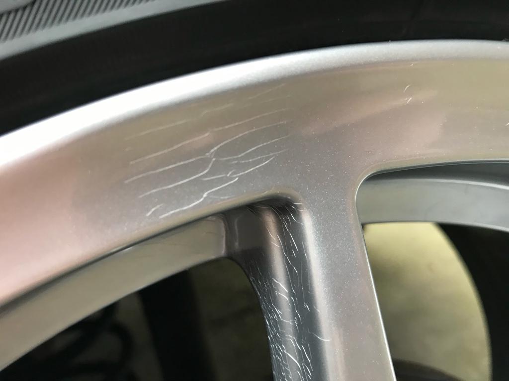

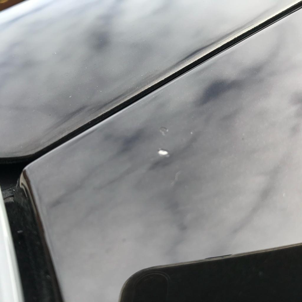

Although noticed this on one of the Turini’s. Looks like they haven’t cured properly, so they’re going back in to be sorted.

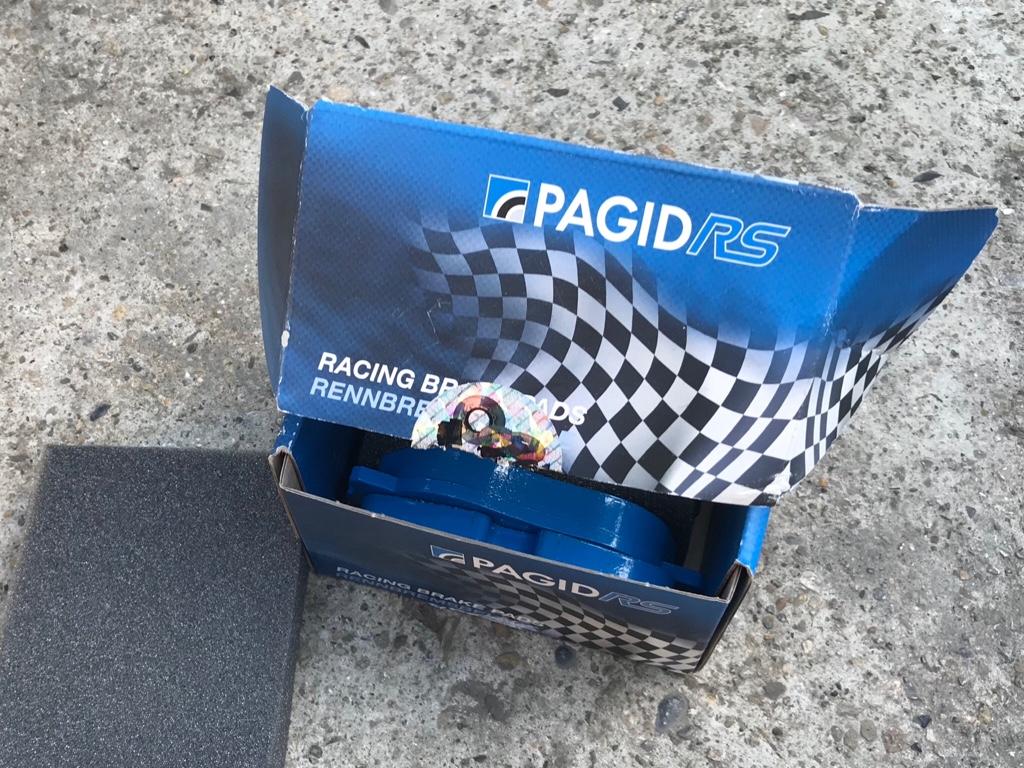

I wasn’t keen on the way the CL6 pads bite. They felt either on or off. Great at slowing the car down at high speed but a bit scary when they were hot and you needed to dab the brakes to make small adjustments. I think they’d work much better on a heavier vehicle.
The Pagid RS42’s on the other hand felt much better, the high speed stopping power not as good as the CL6, but they felt much more predictable.

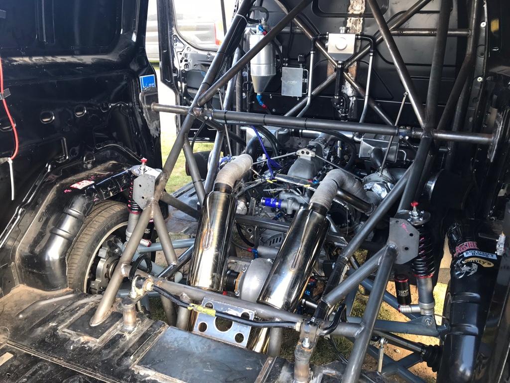

The visit also coincided with Guy Martins test day with his Transit Van. Nice fella and his van was a beast. I even managed a 5 second cameo on C4 [emoji23]

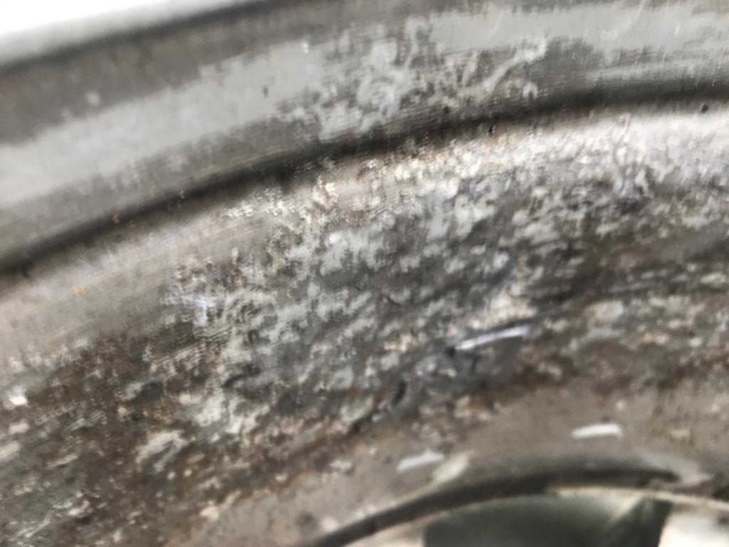

I've just had the same issue with my freshly powdercoated wheels, quite annoying really as two have had to go back for different reasons.
DomP182
  ph1 172, Arctic182
Yeah it’s a bit frustrating. Odd that the other 3 of mine had cured but this one hadn’t 🤷🏻‍♂️
I got mine done by a local woman who does wheel refurbs which makes complaining more difficult than if I'd gone to a big firm.

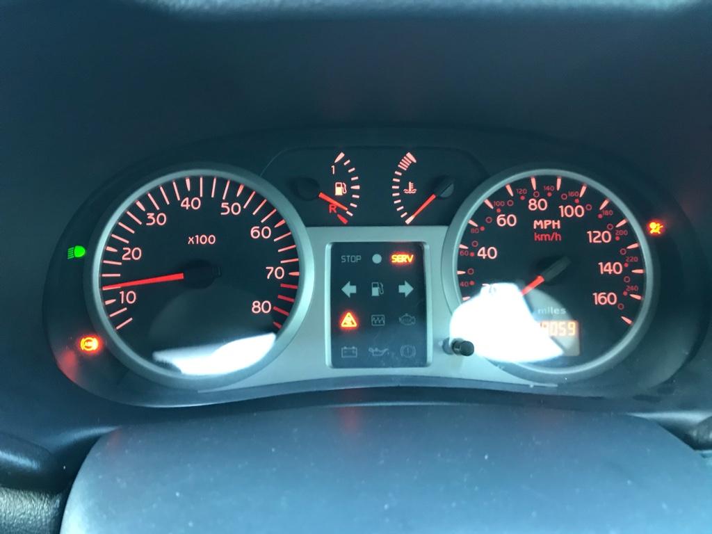

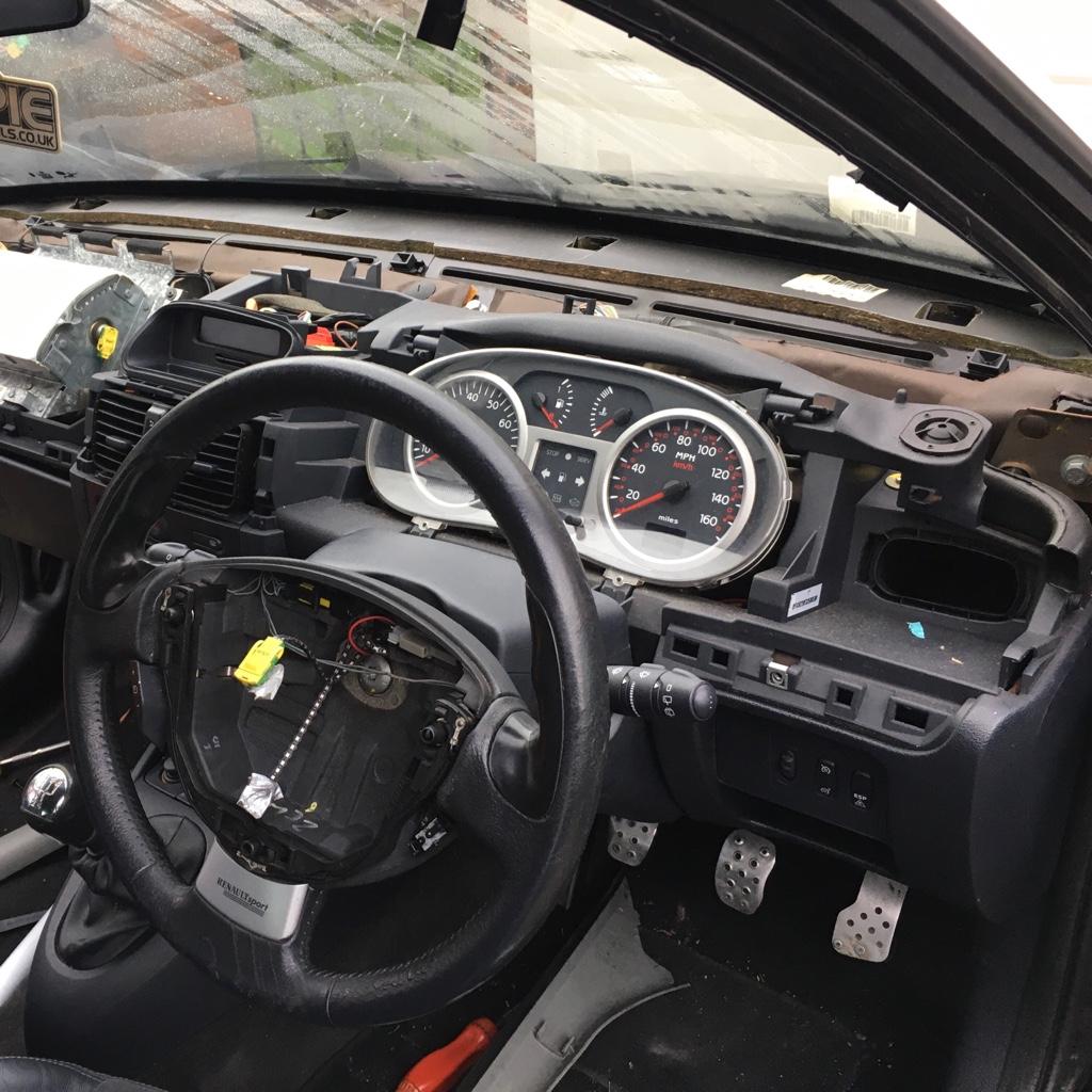

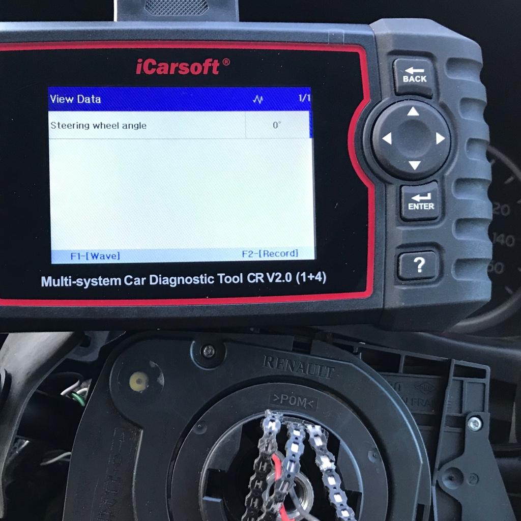

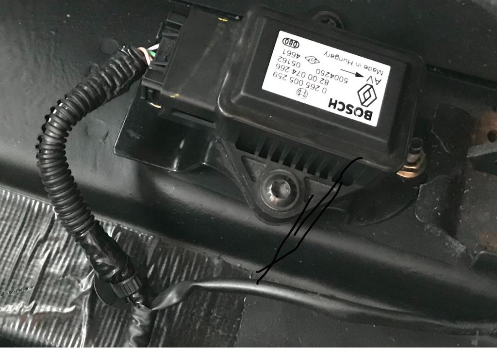

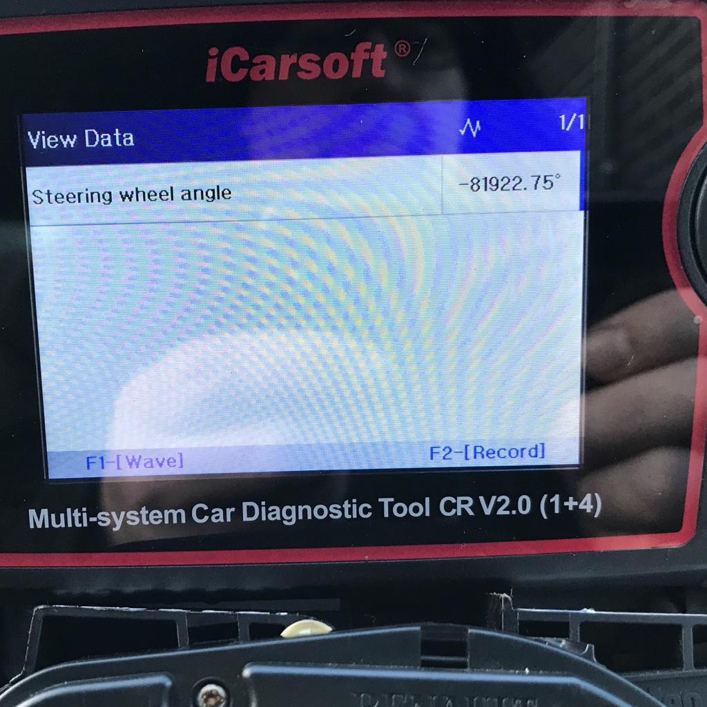

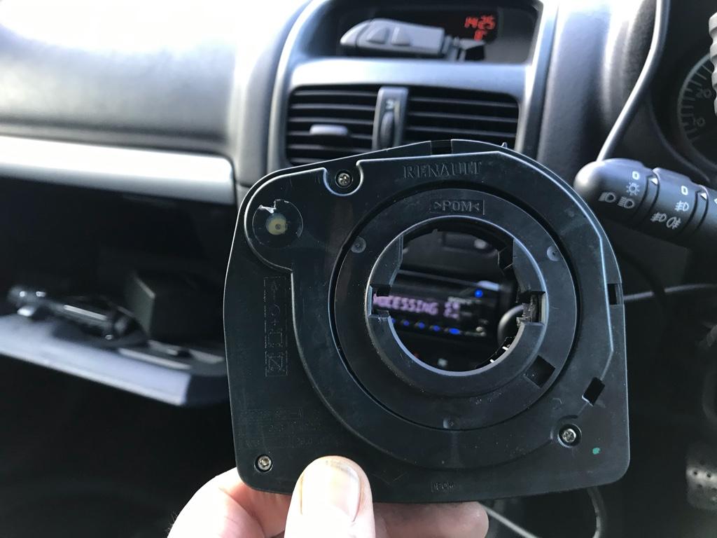

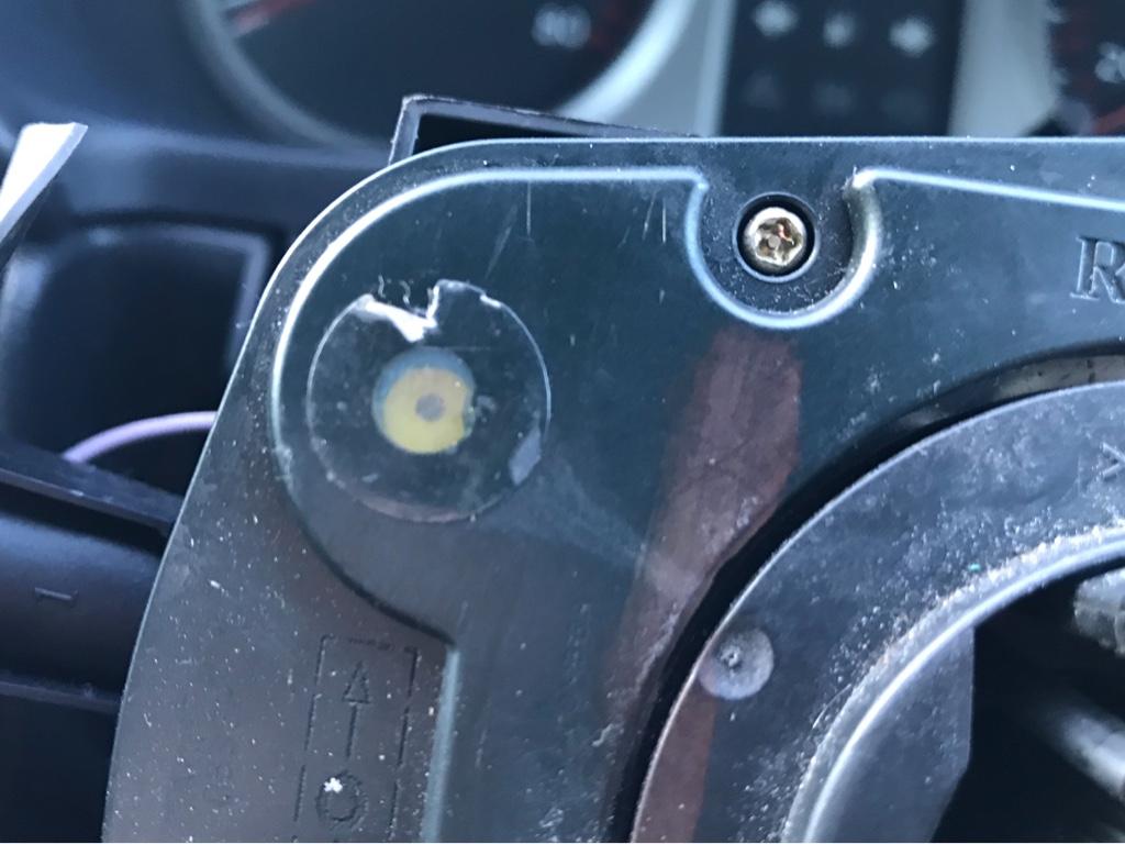

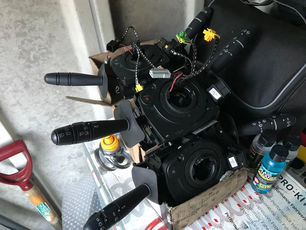

First job was to take my track car steering wheel out and replace it with my newly refurbed ‘Snappy’ wheel.
After removal I got a few extra warning lights that I wasn’t expecting. ABS, ESP and SERV lights usually point to the steering angle sensor. It’s been fine up until now, so I guess it’s just decided to give up the ghost.
The sensor appears to be positioned correctly with the Yellow circle and Black dot centred nicely in the window.
A quick check of the live data on the diagnostic confirm my suspicions. No movement from the sensor when turning and the obligatory -81922.75 degrees fault.
Luckily I have a few spares from when my Track car had issues. It’s a fairly easy process to replace with a few torx screws to remove from the lower steering cowel and the sensor then unclips from the squib.
After replacing the sensor, the diagnostic now shows ‘0’ degrees and a quick turn left and right alters the angle telling me it’s functioning correctly.
After putting it all back together, it was just a case of clearing the old fault codes and no more lights. Happy days.

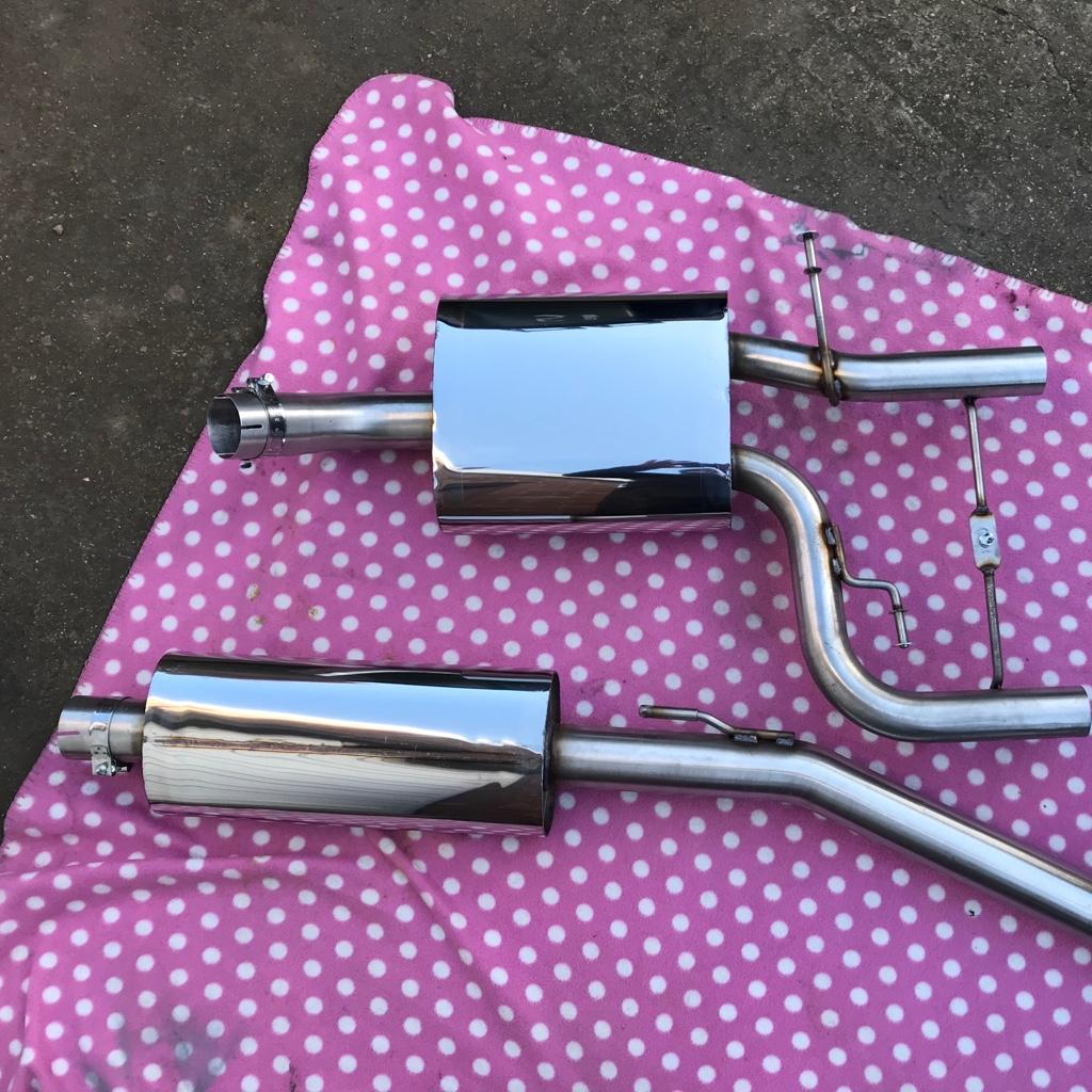

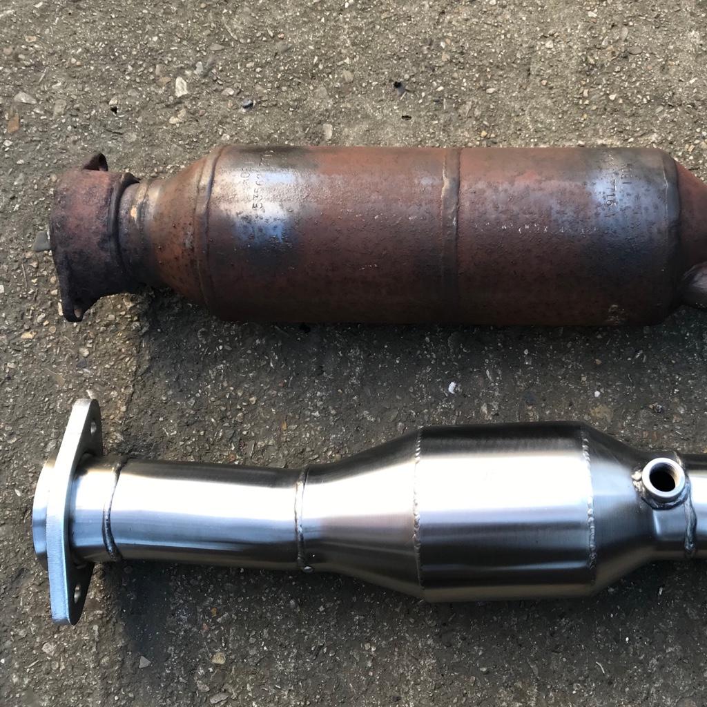

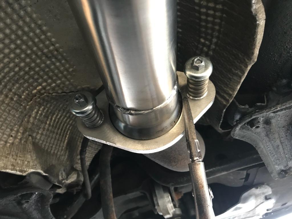

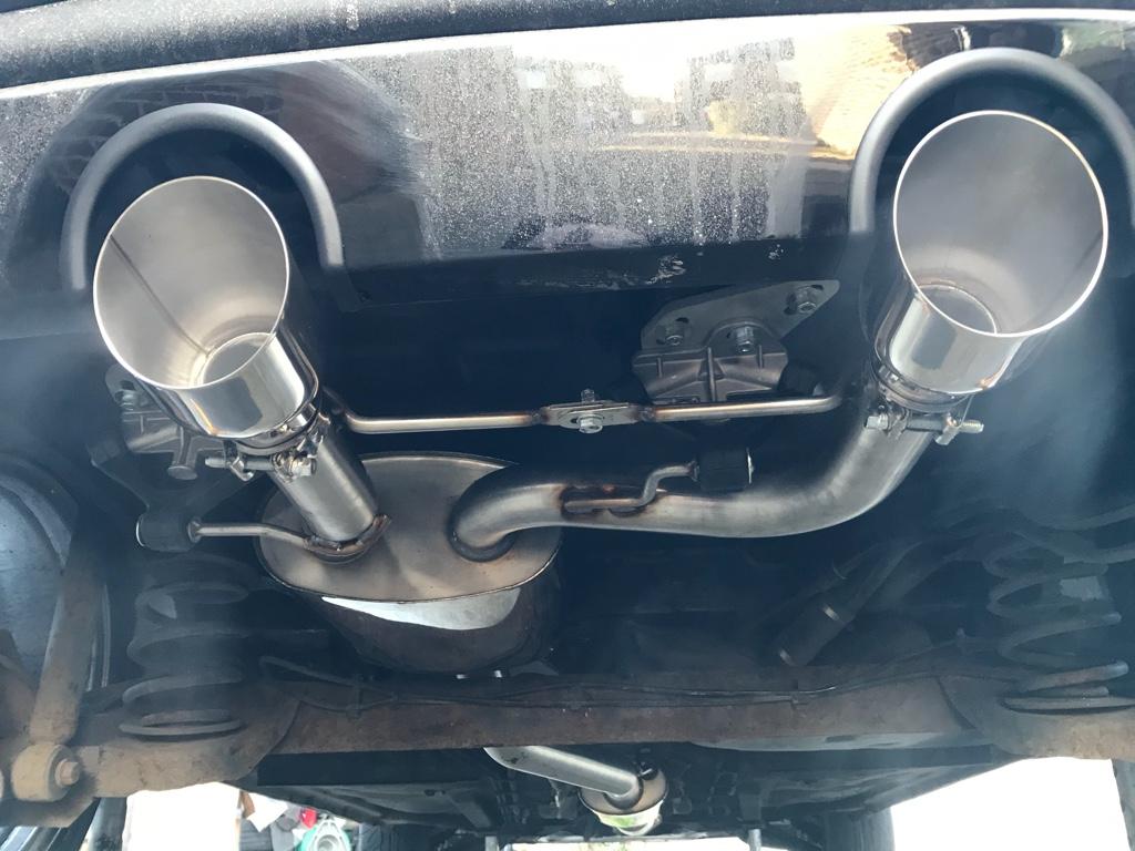

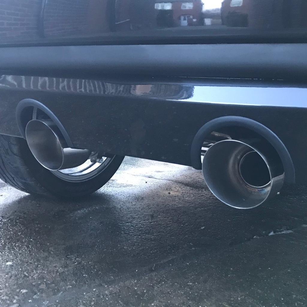

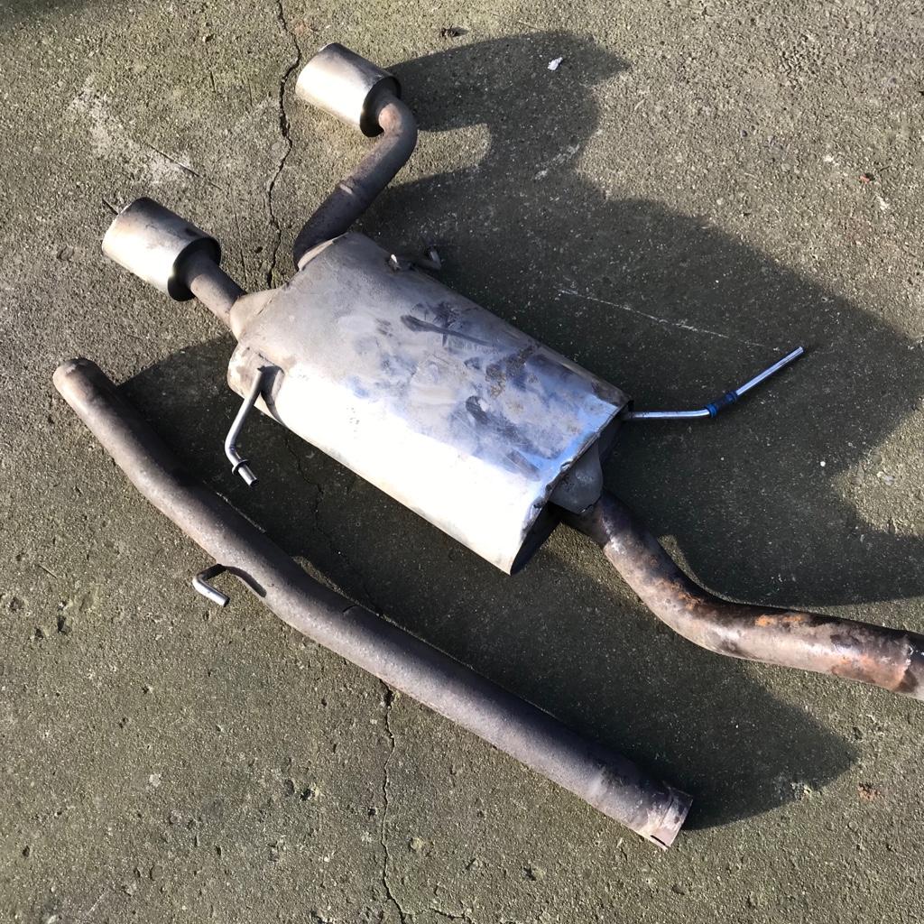

Time to replace the exhaust.
The car currently has a K-Tec variant which is now blowing from the rear box. The exhaust tips are also past their best and I’ve given up patching it up. A quick attack with a cutting grinder and it was off the car in no time.
I’d looked at another K-Tec replacement but my friend has one and it sounds a bit droney. My Track car had a Scorpion 192 which I hated and I’m told the Miltek versions don’t fit properly [emoji2371]
My Track car has a de-catted version of Pure Motorsports Racing Exhaust which is surprisingly quiet. The problem is they’re expensive and I’d need to retain a Catalytic converter for MOT’s.
Looking at how much original Catalytic converters are fetching, I decided to bite the bullet and swap for a Pure Motorsport 200 cell Cat.
It’s a £225 purchase but I’ve been quoted £320 for my old Cat so it’s a no brainier.

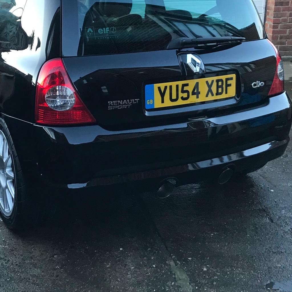

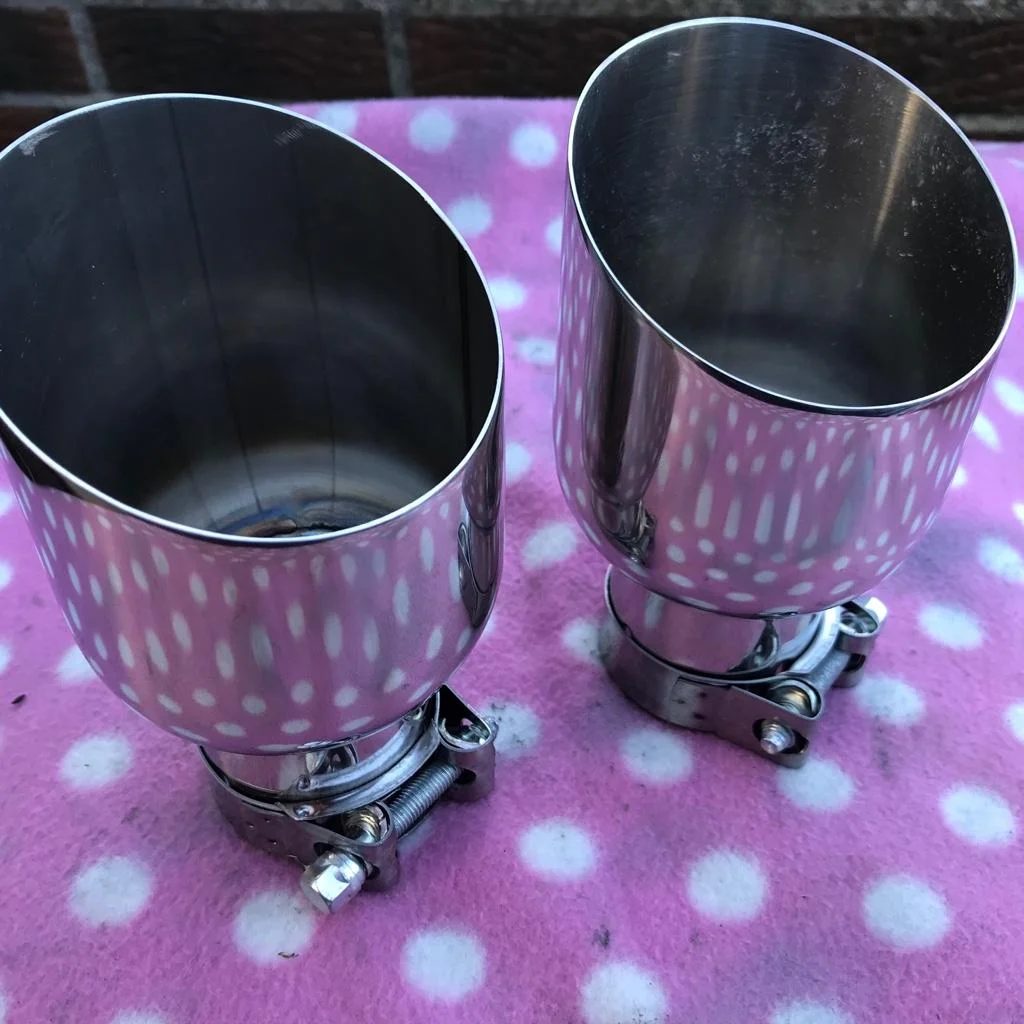

Of course you need the exhaust to go with it [emoji23] so I opted for the resonated centre pipe.
And some rather nice 3.5 inch tapered exhaust tips.
It’s probably a bit excessive for a daily but it’s a beautifully well engineered and designed system and a doddle to fit.
Like the version on my track car it’s really quiet on tick-over, but sounds unreal when you hit 5,500 rpm. Pretty pleased with how it looks and sounds.
