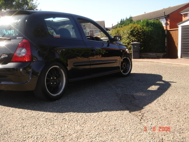

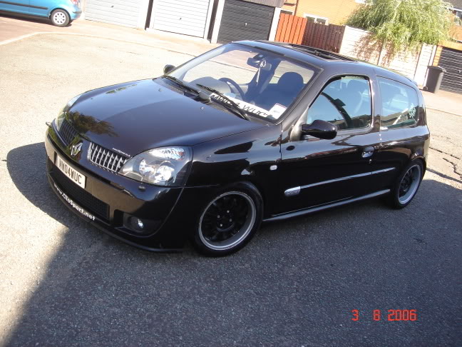

check out pics of Has's clio, as he has a 172 bumper with standard wings

mine :) on standard wings
