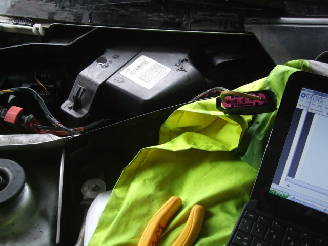

Can someone confirm my findings for faulty Heater Resister??
Rob_Willow
Car  Meg Cup, Tesla, 182
The problem is, the heater blowers fail to work, the panel lights up fine.
I have tried following a guide on here about linking out connectors 1 - 5, which has made the blower come on 'full pelt' Does this confirm the 'Heater Resistor Panel' is at fault?
