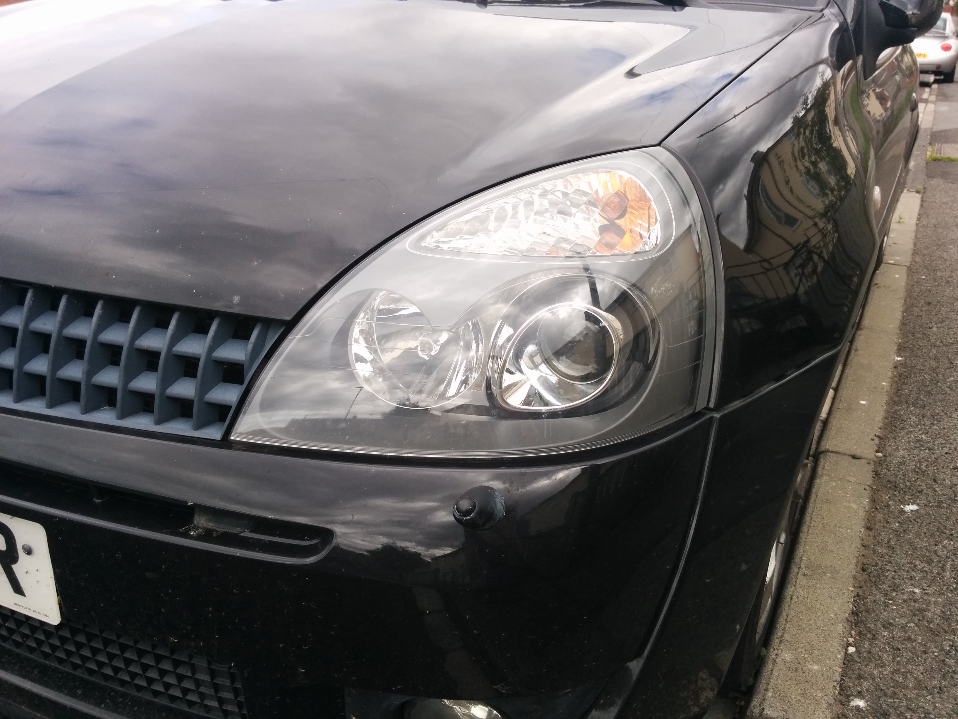

Is the adjuster on the back of this actual headlight? The only one inside car is for this dash board.
I can post a photo of my lights, hold on
They're auto-levelling, you shouldn't need to adjust them at all. As above, try the sensor wiring at the back of the car.
