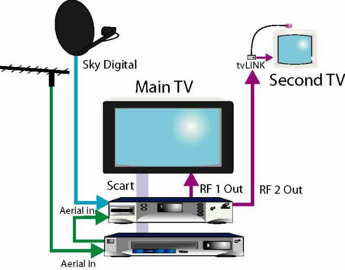

You can if you run you main digital aerial into you satellite box first...then anything coming out of the main satlleite coax (or the second one as your wanting to use) will have Digital on it as well.
Found you a pic...
