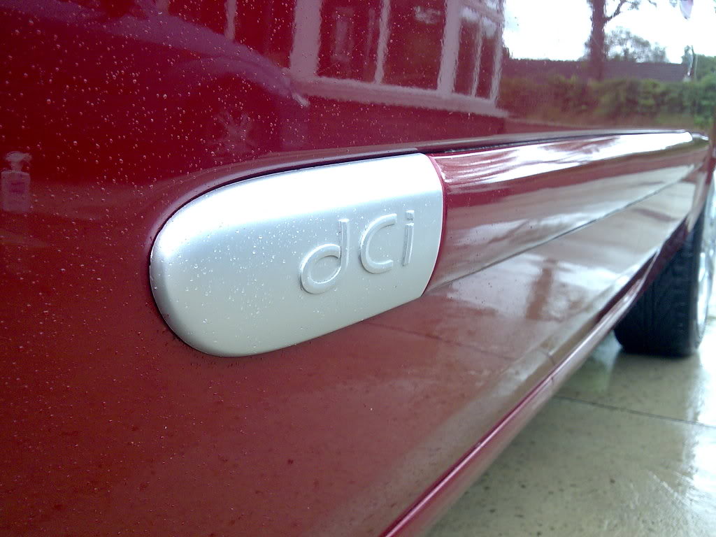

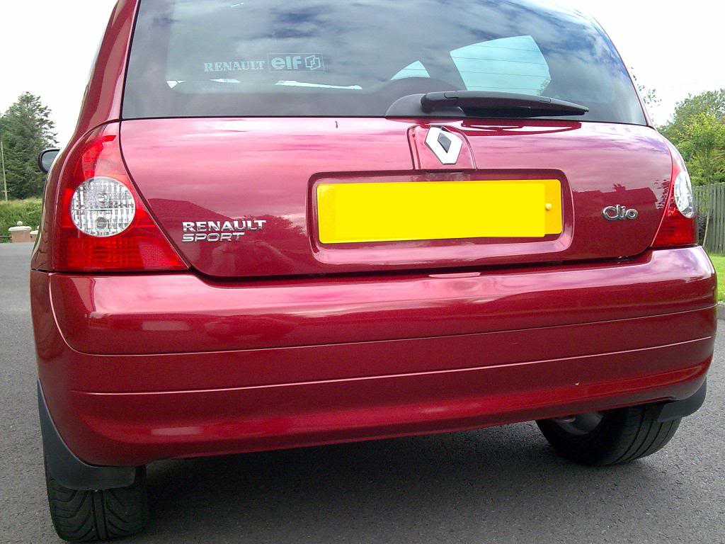

steve, i got a local guy i know to do mine and the paint has stayed on fine, no problem, as long as the correct prep and primer is used its not a problem. price seems a bit steep to imo.
i got full rear bumper spray, spoiler, door handles, front bumper inserts, side strips and bullets for less than 200
and its a top class job believe me
that looks like a good job. your from ni yes? how local is local:rasp:
