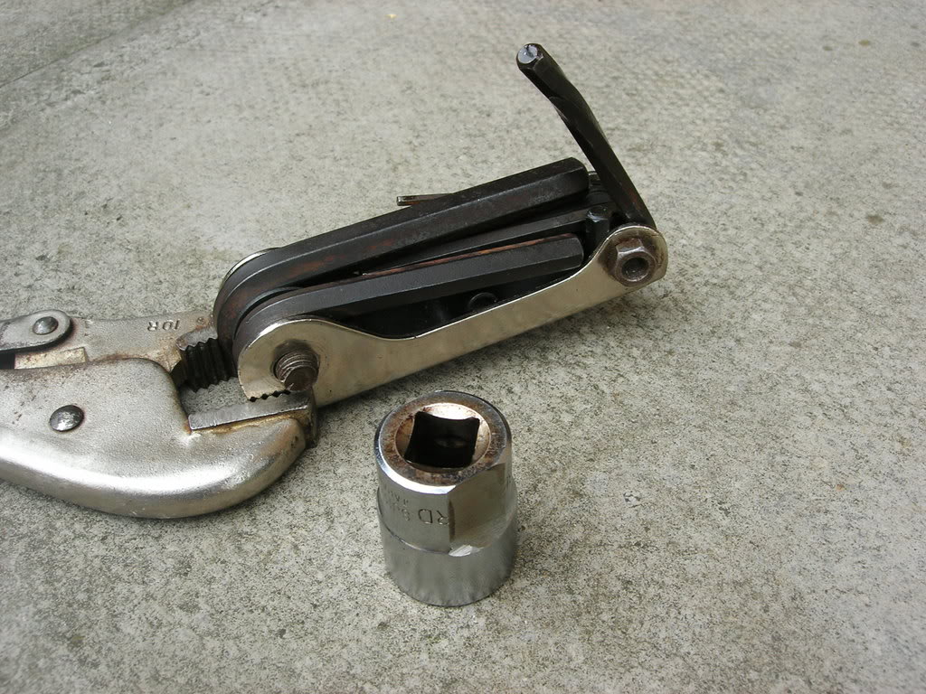

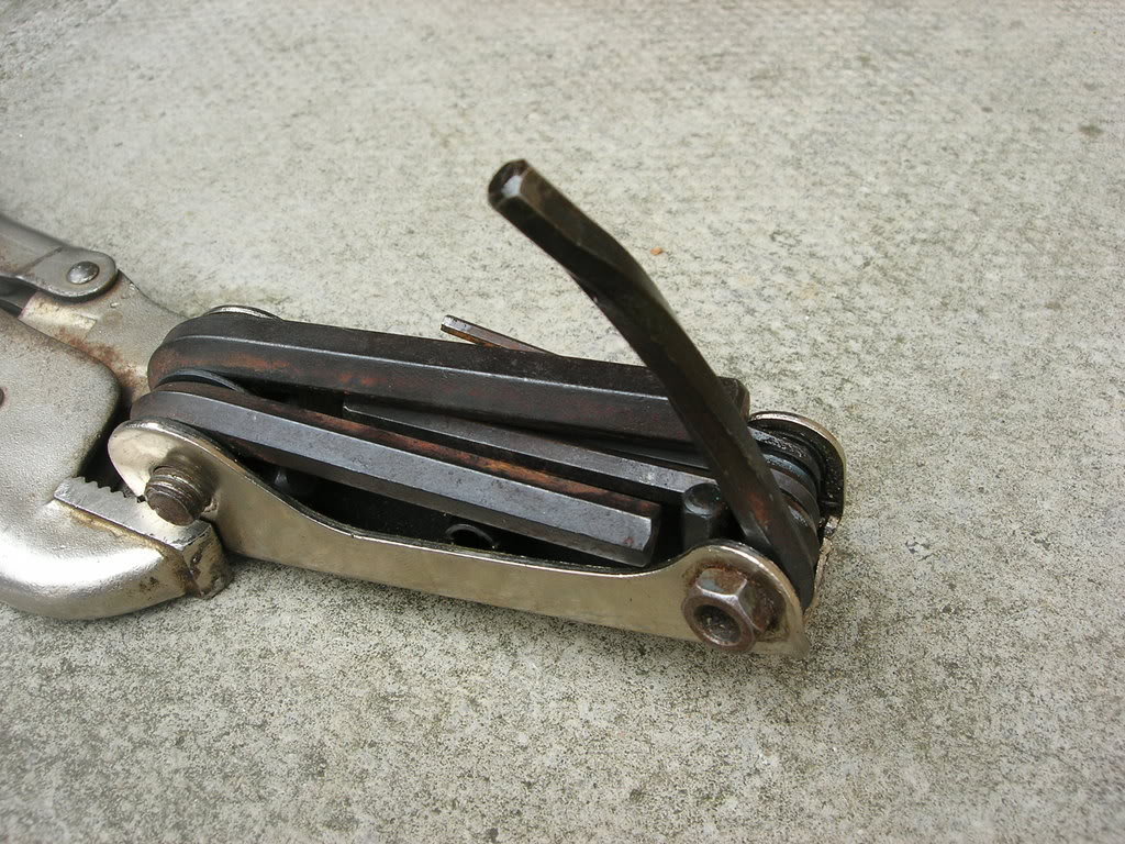

Bent 1 allen key, and snapped another too!

Ground 2 flats onto a socket to get a spanner on and then an allen key through the middle. Was tight:

I snapped 1 allen key, twisted another so I was all out!
Just had a breakdown guy out, he snapped a snap-on allen key socket bit!!
