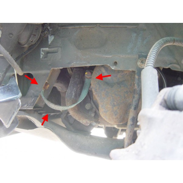

That's the bumper bracket bolt. It won't be anything to do with your problem.
Need the wheel off really as it's straight in front of you as you look at the wheel face
Bit like this
Thanks for the picture. I take it that's front on not top down? Kind of hard to tell. I'm only asking so many questions about it as I've not got time or tools at my new place to get the wheels off atm, whereas if there's other things/ways of checking I can get on with them before the weekend!
So to sum up, the earth points are that one above and the one connected to the actual battery terminal... is there any more?
There's 3 earth points. 1 at the back edge of the gearbox, 1 at the front where the battery earths out and the final one is the earth strap between the gearbox and the chassis as pictured above mate.
The earth point at the back of the box is about smack bang inline with the driveshaft and it's viewable from under the bonnet.

That would point to it being the earth lead from battery to chassis and no others.
