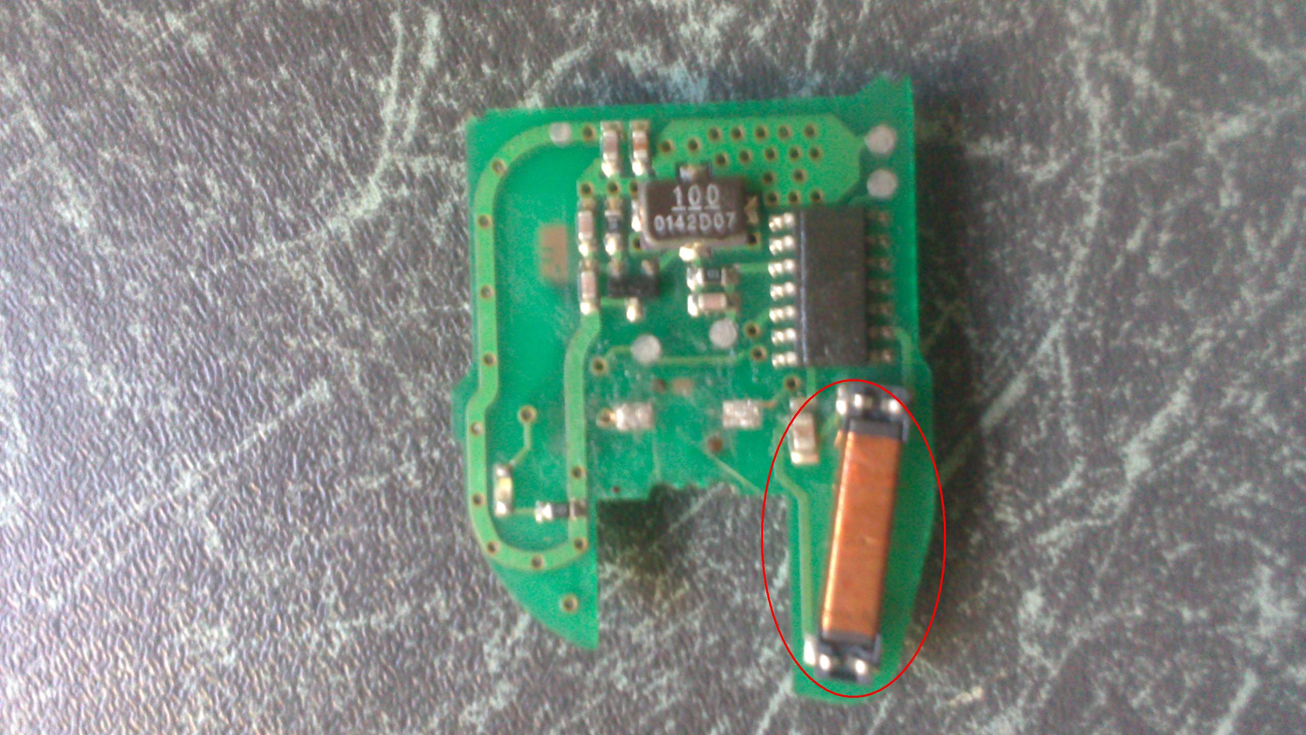

TBH i dont think it has anything to do with resyncing the key, whats more likely is the transponder inside the key has come away from circuit board from the key being dropped ect.
When you put the key in the igniton and push the button on the key it pushes the transponder back onto the contacts on the circuit board. I'll see if i can get a pic of the transponder.

I just opened the key to replace its battery before re-synching with the car... the 'charging coil' is loose (which is most likely the problem) - I cant see any other obvious damage... i can't see anything wrong with the transponder either (although there could be some damage I just can't see)...

Hi
Is the bit that's circled on the picture Ive attached loose?
If so then that's the transponder that disarms the immobilizer,
Without a spare key to try the only options are to either go to Renault and pay in excess of 100 quid for a new key or you can replace the whole system which involves changing;

Thanks mate, yes that is the bit thats broken.. I've been looking up a few key replacement services - all ranging above 100 quid. Looks like i'll be forking out! :disappointed:Thanks for the help! :smile:

Where are you based? I used to send keys to a guy who would read the code from the chip in the picture scott has put up and code a new transponder which u would push into the key casing much like the earlier immobiser systems, Which was half the price of the main dealers so around £90
