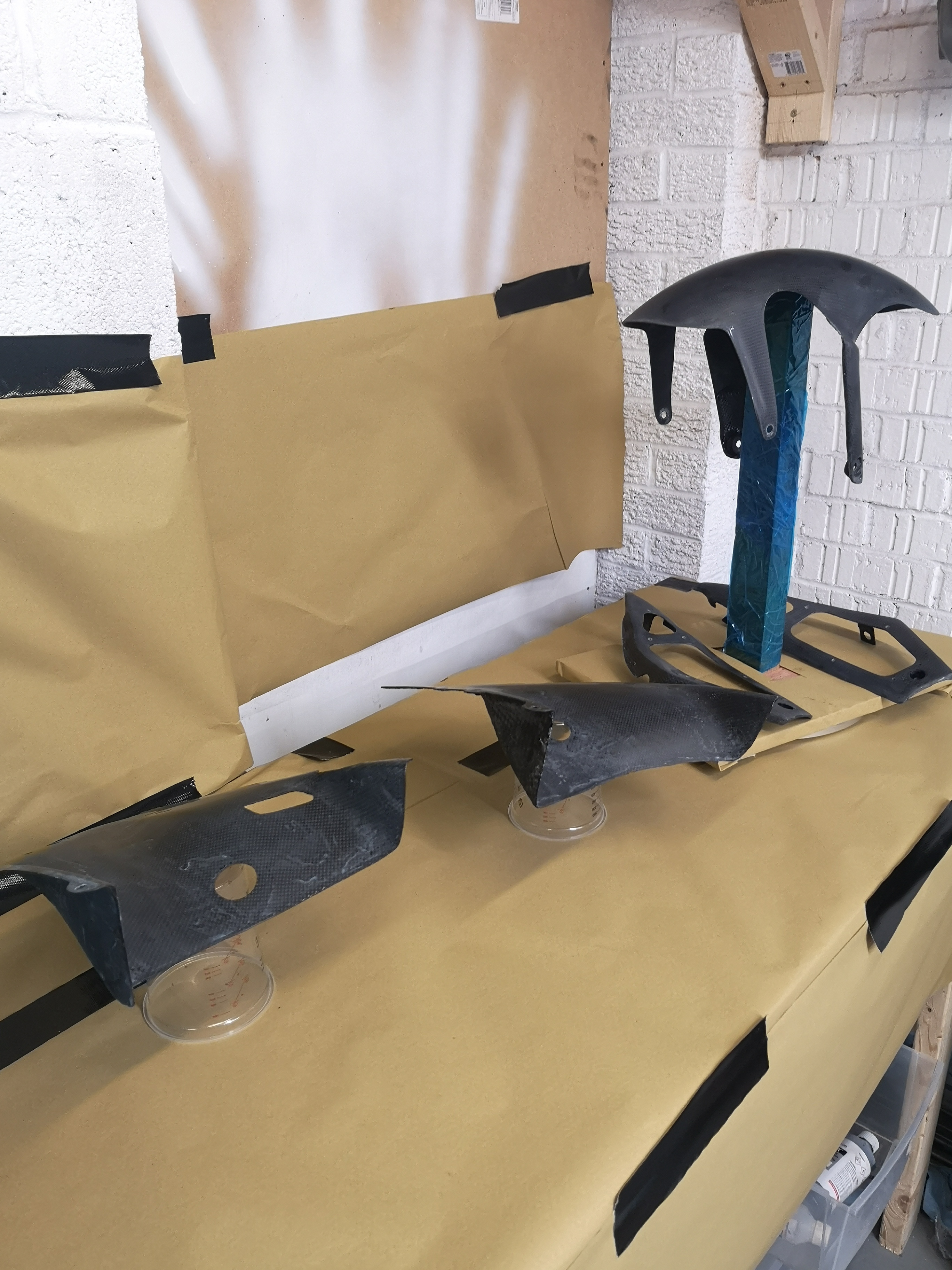

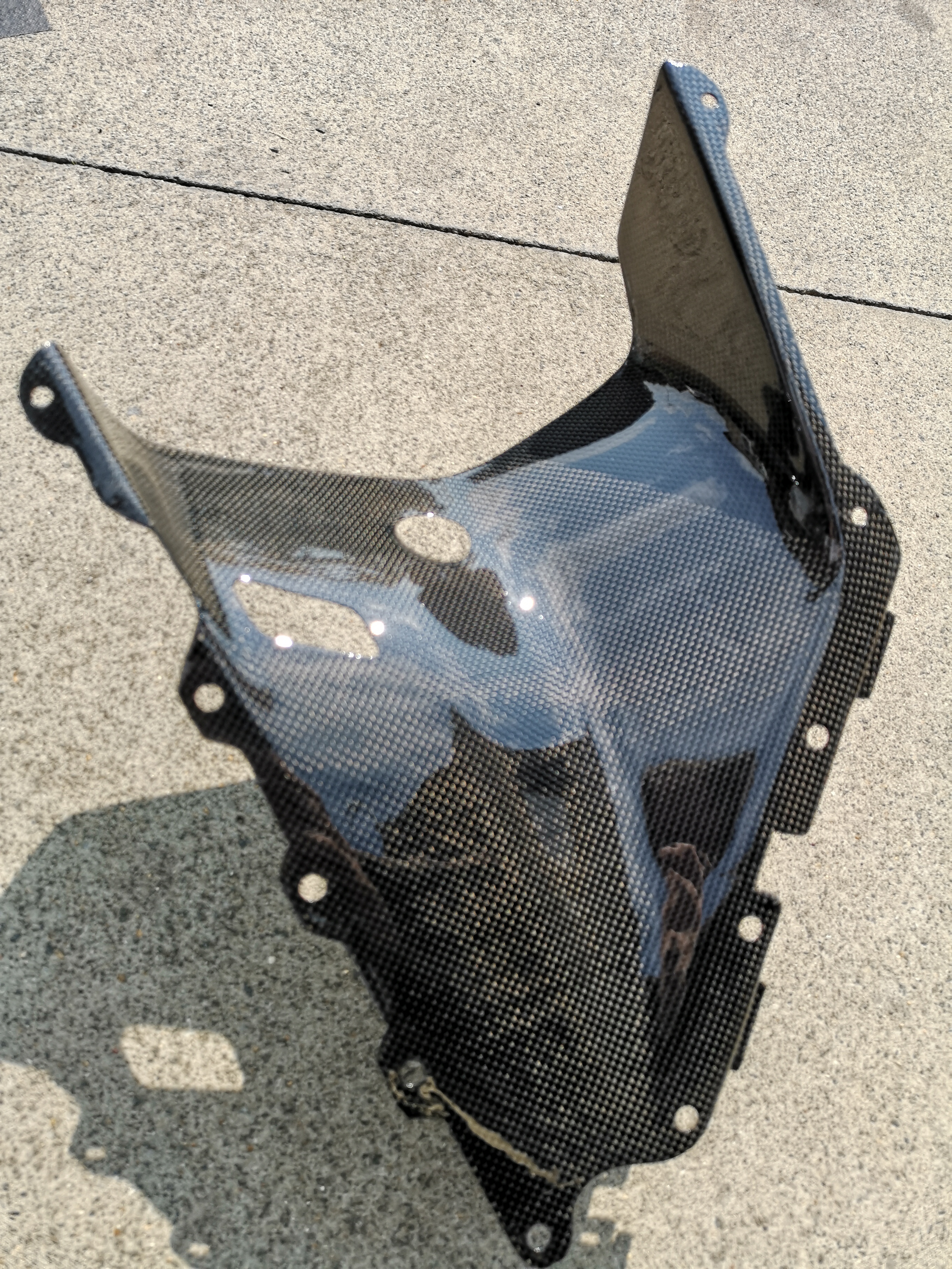

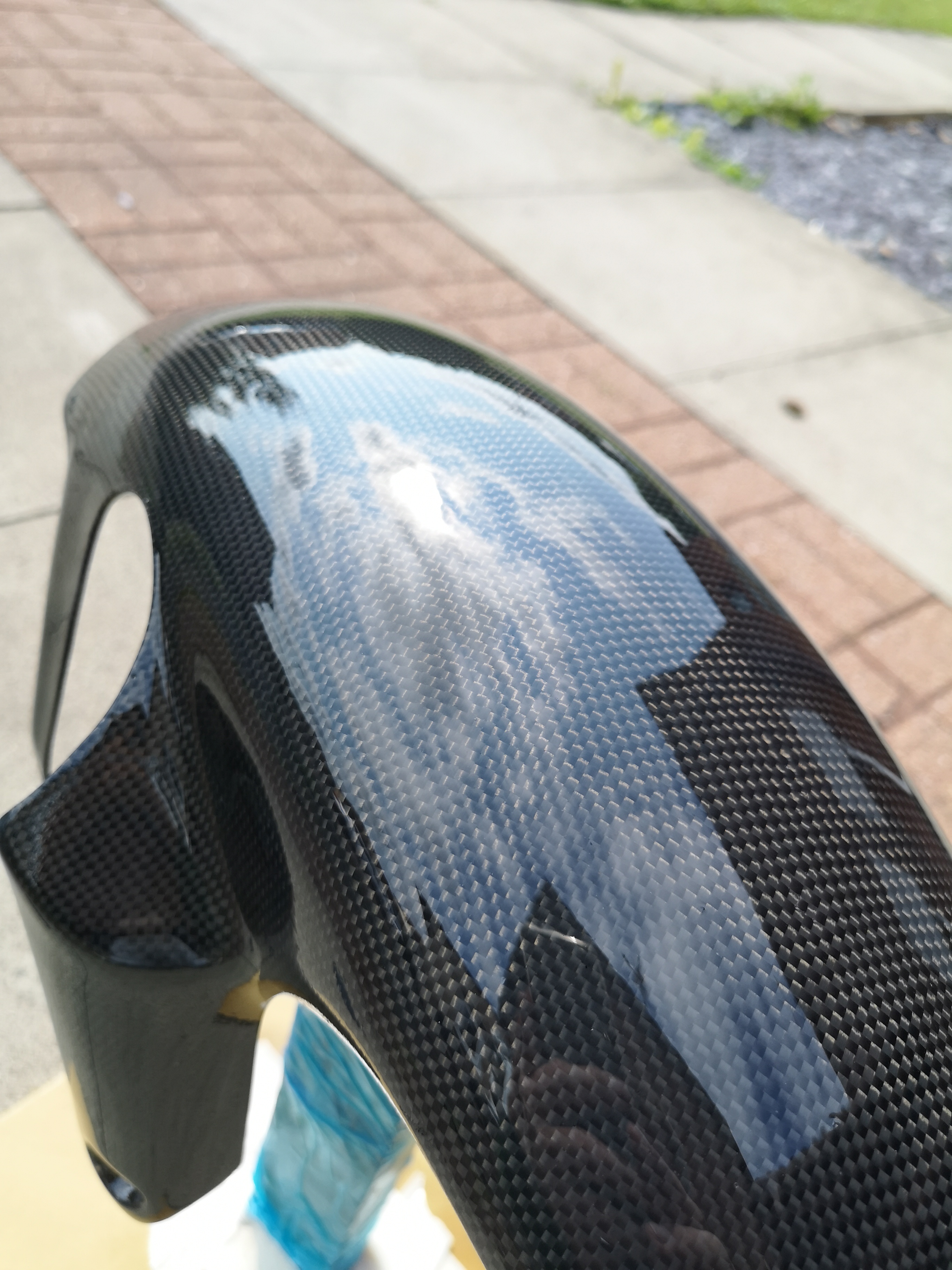

I've done a fair bit of restoring carbon parts, it's just a case of flatting it back and re clearing it, but you really want to be using 2k clear as 1k rattle can stuff is rubbish. If you haven't got access to a compressor, gun and a mask then it'll be cheaper finding a bodyshop that can do it for you.View attachment 1650990View attachment 1650991View attachment 1650992

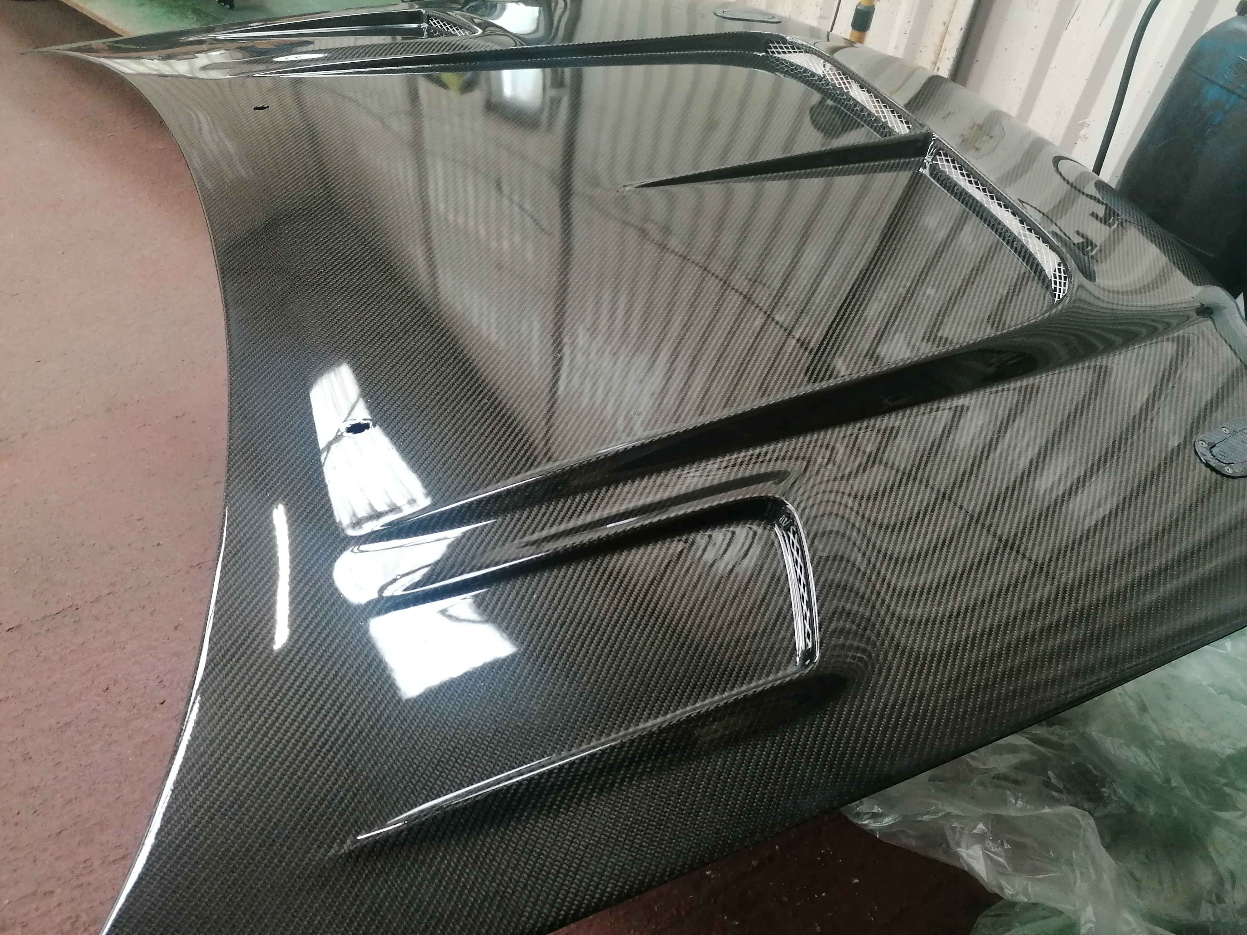

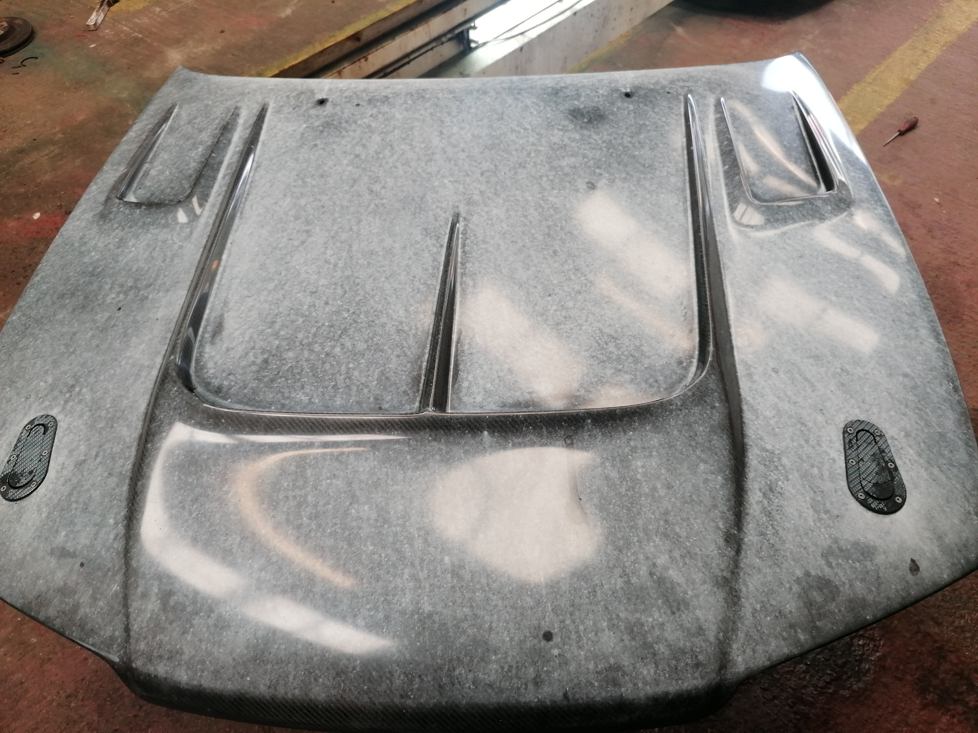

thecrim22
  various
@MAXRUNDOWN managed to finally get a go at me bonnet this morning, the laqure that i had the hardener was buggered so had to get new stuff yesterday, i did try my older stuff on the headlights of the car but it just crazed, and even the new stuff did the same, bloody datsuns but bonnet came out not too bad just give it a wet sand and polish either friday or Saturday as i wont be about work tomorrow or thursday but a wee before and after pic.
