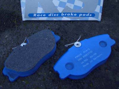

If it helps any here's a pic of some Pagid Blues with spring clips attached...
Maybe the ones you have are actually a different pattern that just happens to fit in (very badly though)?
