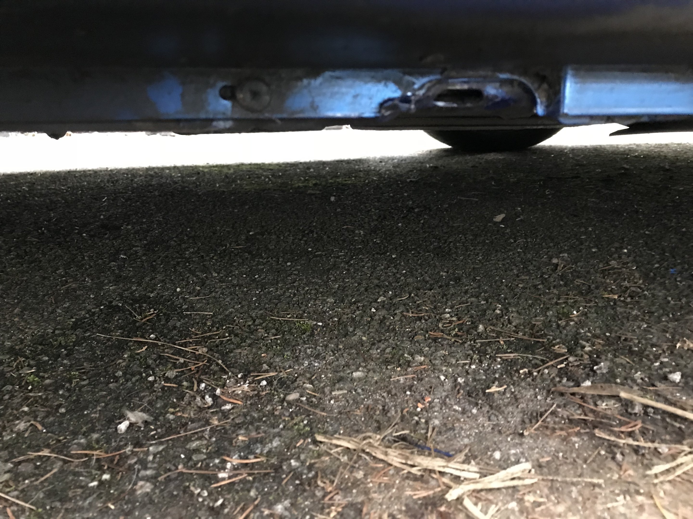

Halfway through jacking my 172 up I heard a massive thump and the whole thing nearly slid off the jack.
Lowered it back down (thankfully still had the wheels on) and was greeted with this.
Photo doesn't show it too well, but what's happened is the whole sill seems to have folded in. :confused:
Unfortunately my Clio is too low to get the jack in anywhere else (even using my low entry one), so will now have to roll it onto some planks from now on before jacking it from elsewhere! Subframe or wishbones?

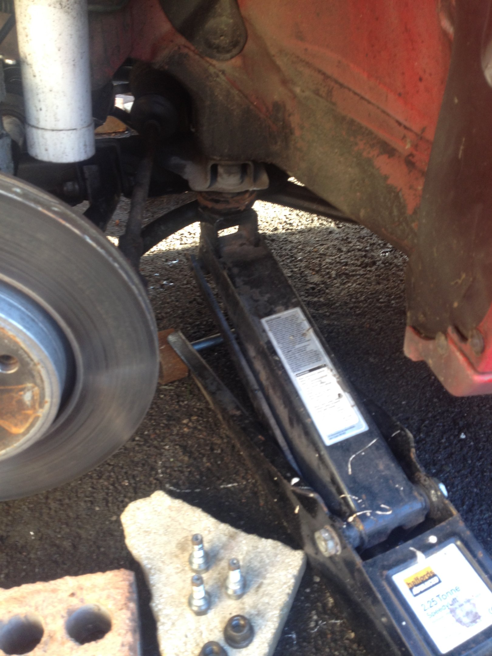

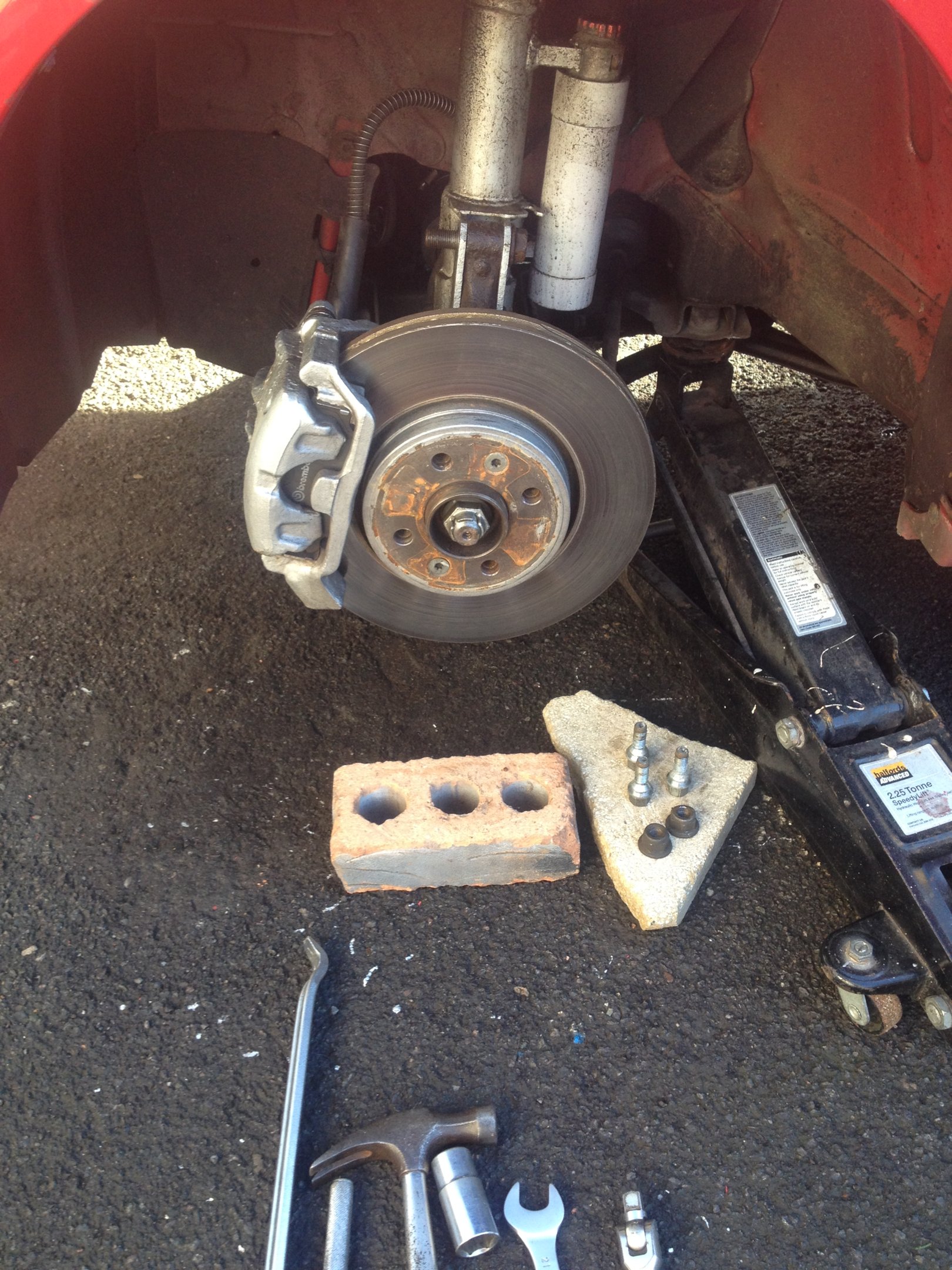

Thought I would just show how I do mine. Drive up on to a brick and jack up on the bottom sub frame bolt.
Rear I drive onto bricks and Jack up on ends of the rear beam.

I jack on the chassis rail further back slightly so there is enough space for an axle stand on the rail too in front of the jack once I'm at height I need
