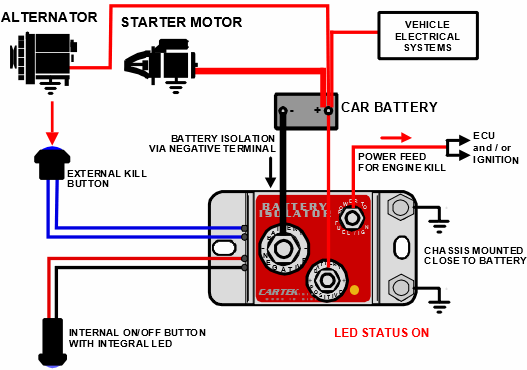

I've recently taken on the maintenance of a friends 197 track car, that's 99% race ready. The last bit is the battery isolater, a Cartek GT, which needs to run a power feed to the ECU.
Unless I've missed something obvious on here I don't seem to be able to find any wiring diagrams/ECU pinouts so wondered if anyone had any or knows which wire is the power feed to the ECU.

Can't you use the ignition wire instead of the ECU power ?
Quite possibly, I haven't yet seen it in person to have a proper look at, I'm just going by what I've been told so far. My 172 currently utilises an armtech cutoff, although with it's current rewire that'll go to an XR from cartek.
I was hoping to come across some wiring diagrams so I'd at least have an idea of what's what
