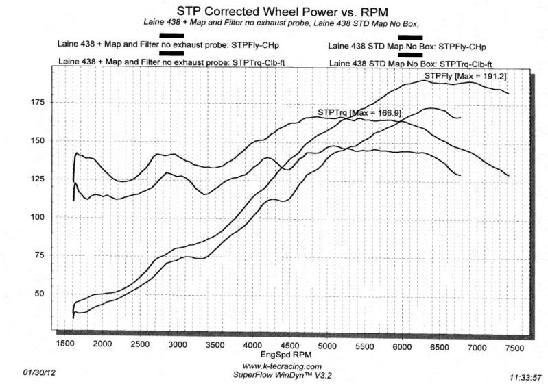

Had it all mapped in at Ktec yesterday, it provides some probably slightly dissapointing results. WHen we got there we initally ran the car to see what it did on the stock map and airbox, it produced only 174bhp / 148 ft lb's! All my power gone :(
Mapped it up and fitted a better air filter and some other tweaking see it sat finally at 191.2bhp / 167ft lb's. So there we go, i guess if the results produced on a standard engine are good, it wont always mean good gains from cams and other such mods? (all part of the gambling game that is engine modifications..)
But... it doesn't half shift now!! Goes like a rocket! Overall perhaps not worth the overlay, but im sure as hell going to be enjoying it more now on :)
There are some other things that i will change (Ktec stealth and some modifications to the cat), also advised a set of matched inlets should help out a good deal.

My graph is a bit more consistent than Doms from what i can remember, it holds 160ft lb's+ for a good amount of time, and doesnt die off quite so harshly.

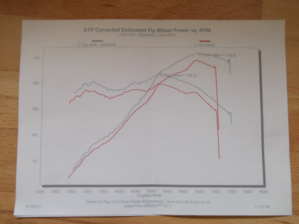

My map could do with a tweak as like I said before v6 box and cup set fitted afterwards,having ITBS fitted next month so not to worry.
From most of the graphs I have seen of cammed cars the torque does tend to drop of quite a bit at higher revs but this is true of most NA cars of this type
This is my graph prior to having cams fitted,sorry I don't have a overlay.
  HBT 172 Cup
Here ya go, its only black and white sorry, but it should be obvious what is what.
Unfortunately i dont have a graph comparing the 186bhp to the cammed results (gains were there but relatively minimal), this is pre and post "438 map".
  182/RS2/ Turbo/Mk1
Dom, TBH that looks pretty horrid, not that it will bother you as im sure the bodies will sort it out, but to drive it must be a case of:
2500rpm - 140lbft - not bad
3000rpm - 150lbft - yay its starting to pull
4000rpm - 140lbft - oh its died off slightly again
4500rpm - 150lbft - yeah man, starting to pull
5400rpm - 160lbft - awesome its properly on song
6000rpm - 150lbft - oh its dieing off again, still ok though
7000rpm - 130lbft - really dieing off now
7500rpm - 110lbft - hello? is the engine still there? why doenst the throttle work?
On the bodies it will be epic though im sure, so as a stepping stone towards a final point its well worth doing, but those cams really dont seem to be working well on the standard inlet on your engine Dom.

Laine, do you have a before graph anywhere at all? not one you can post later when you get home or something?
Just to really see the difference its made?
End result looks cracking though, certainly a lot better than Dom's one was, still dies off at the top but at least it doesnt plummet like his one does.

It will be good I am sure,don't know why you listed the above that was before the cams went in do you have problems reading.
  182/RS2/ Turbo/Mk1
Doms, clearly yes I did have a problem reading, sorry mate got the two graphs confused, impressive starting BHP then for a standard engine 179! Thats what threw me I think!
Very similar story even after the cams though, in terms of the dieing on its arse at high rpm, but just better figures all round in general :)
Did a lot more for you then they did for Laine clearly!
  KTM 990 SD / S60 D5
That graph shows before and after mapping of a standard car,my car has picked up gains across the rev range each time it has been mapped to suit,I would not be happy losing a massive chunk of torque low down in the rev range as seems to be the case with laine's car,that's were these cars need the torque as I am sure most people who know these car's well will agree with I am sure
Standard 174 bhp 150 ft/lbs
Remap 179.6 bhp 159.2 ft/lbs
Cams and remap 189.9 bhp 164.2 ft/lbs

I havent really got an issue with low down torque IMO, you put your foot down and it still f***s off and goes! I have more to squeeze yet, matched inlets and a different exhaust setup and a few other tweaks and ill be back with a vengeance.
