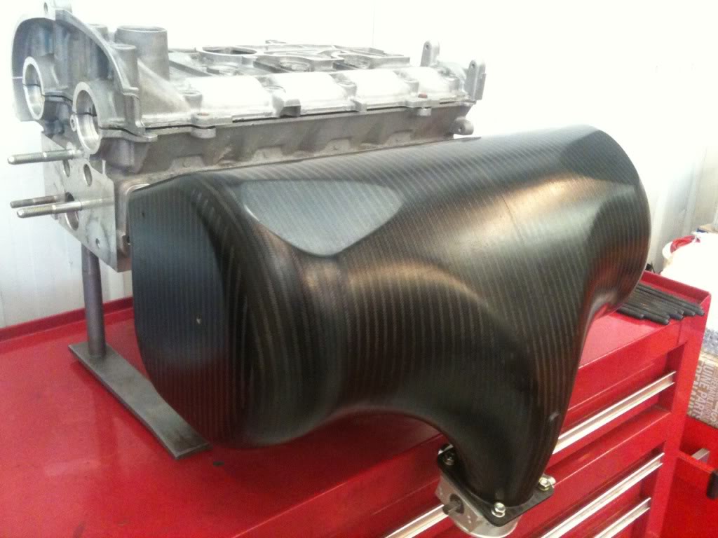

I still need to find time to graft something up with this:
One of our old S2000 plenums. It was good enough for 287bhp back in the day so it should go well once crammed into the engine bay of my cup.

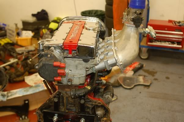

Here's a similar thing I did on my nova turbo engine:
Plenum nicked off a ford RS200 this time, I like finding things that already work well rather than having to make them, im very lazy, ha ha
That time as I had more space I added some jenvey 50mm spacers to increase the runner length, worked really well.
Thats WAY beyond epic! Seen that pic before on here and it really does look a total work of art.

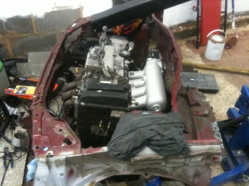

I found this in a civic revving to 8500rpm on solid lifters and with a LSD box and thought it might fit in a mk1 clio bay:

Would fit well in a volvo or similar where the engine is spun around the other way I guess if not in a clio, lol
Don't mind the Honda into Clio plan at all! One of the chaps at Jabba is currently 20V'ing his Cup. I can confirm a 4G63 fits as well :) Keep the stock clocks in yours and see how far off the end the standard tach goes!
I did look at the vw engine but I dont like their boxes the rods are weak and they dont have lsds and worst of all they are on hydraulics so wont pull the revs. All stuff that can be sorted but the idea with the B18C4 lump is that I can whack a turbo on it and see the 220-240lbft and 300bhp ish that I want (looking for that elusive totally flat line again!) and if it goes wrong I just throw another standard engine in, rather than having to keep building one like I would with the audi lump.
