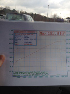

C&B's worked fine for James to give over 200bhp does show that at least some cams work with the RS2
Little birdy told me his timing was off on the C&B's as well, so with that done correctly, it could possibly have done even more!!

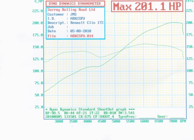

The 201bhp result was after the previous "mechanic" had there way, so graph is as good as she gets in terms of cam timing! the graph in question -

Laine is there any chance you'll be back at Surrey RR to compare to your previous results? I'm honestly saying that in the sense to see what you have genuinely gained as chip has said, there have been many instances of cars going in "under-powered" on the first run, When Paul at RS tuning had mapped a previous 182 customers car of JMS it left there with 182/183 bhp then a few weeks later went into K-tec where they RR'd it at 170bhp "before" it had the camshafts fitted & Paul's rollers are known for being strict so I can't see how he lost over 10bhp, which in the NA game is a fair chunk!
  HBT 172 Cup
Yeah next SRR day thats organised, and ill be there :) Although i guess that may be a while as one has only just been and gone!

J's Graph in the surrey RR thread -
That would be mine, to say I was a little surprised is an understatement...
Your reply -
torque's still pisch but you can see where the vvt is switching off on the standard map, you'll definitely have a great bhp figure if the map's adjusted right
If looked at the results that day, Most cars (not all) were just touching 150ftb where's J's just made it for 4,000rpm un-mapped! so how does the torque seem "pisch"

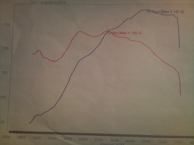

My cup with a decat exhaust, panel filter, matched inlets and 421's on TDF's rollers made 191.5bhp with 169.3lbs/ft so this RR print out is a good comparison of the two cam types for those of you interested :)

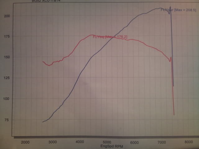

Then last week I had ITB's fitted :D
And now the graph looks like this.... (shorter trumpets)
208.5bhp with 176.2 lbs/ft
Drives real nice!
  KTM 990 SD / S60 D5
Nice result considering you have the shorter trumpets,getting my bodies fitted next month(longer trumpets)so hope to see similar if not a bit more maybe:)

  182 FF
Alex, thats some monster midrange torque right there!
208 isnt shy either :)
Quick little car I bet.
Yeh goes well :) quite impressed with the torque spread compared to just having cams, certainly feels alot stronger!

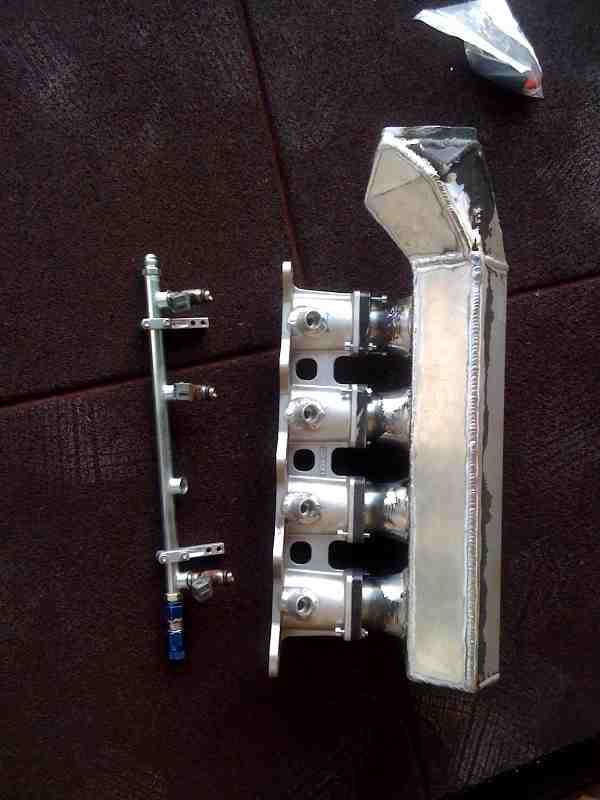

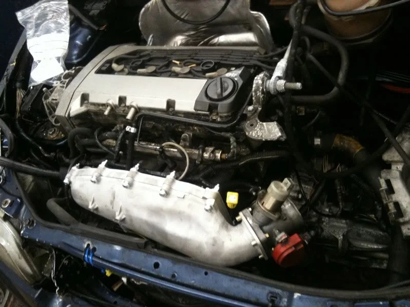

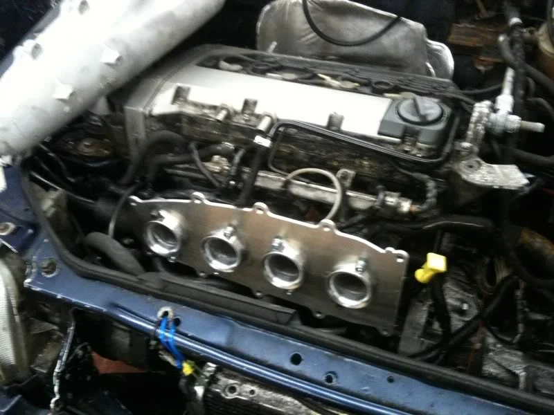

  182/RS2/ Turbo/Mk1
ol, good effort!
Ive done similar with my williams engine, single throttle only for some of the local motorsport, but nothing stopping me using throttle body manifold, trumpets, shared plenum and a single body ;)
Luckily for me im not competitive enough driving at anything to ever get banned, ha ha
Bit more effort went into your plenum shape than ours though by the looks of things, our primary design requirement for that was how can we quickly tig it up from some flat sheet and not intrude too much on a straight run from throttle to plenum ;) It's all Jenvey stuff in the one above, boggo SF 730 manifold with injector bosses welded in and if memory serves Jenvey did the 4 bolt SF flange trumpets as a special order. Quick hour on GT to work out about the right plenum volume and job was good enough to get told off for ;)
  182/RS2/ Turbo/Mk1
LOL @ "good enough to get told off for"
Thousands of manhours and hundreds of thousands of pounds went into the design of my plenum, by nissan, its lifted off a pulsar gtir, lol
Seems to work ok though and just happened to fit well in the space, all we had to do was knock up a spacer to get a little more volume.

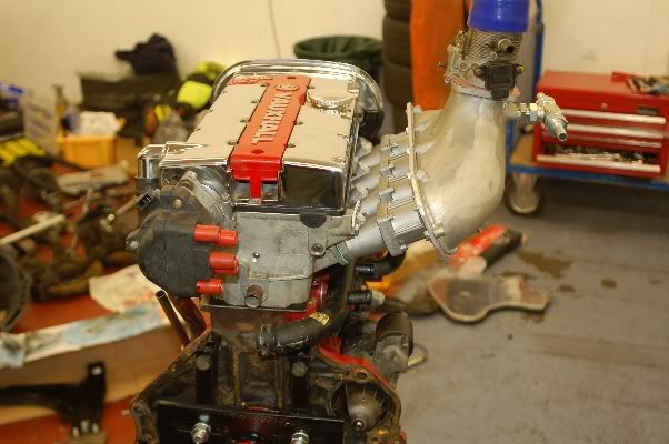

  182/RS2/ Turbo/Mk1
Here's a similar thing I did on my nova turbo engine:
Plenum nicked off a ford RS200 this time, I like finding things that already work well rather than having to make them, im very lazy, ha ha
That time as I had more space I added some jenvey 50mm spacers to increase the runner length, worked really well.
We have an RS2 on our clio 172 that my mrs uses as a daily, I desperately want to bin the slam panel and aircon and increase the runner lengths as I know it would gain torque right through the rev range but sadly she has a point it would make it a bit of a s**t daily then compared to currently just for the sake of a few lbft of torque, lol
