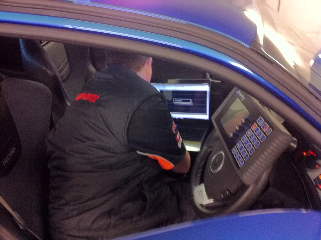

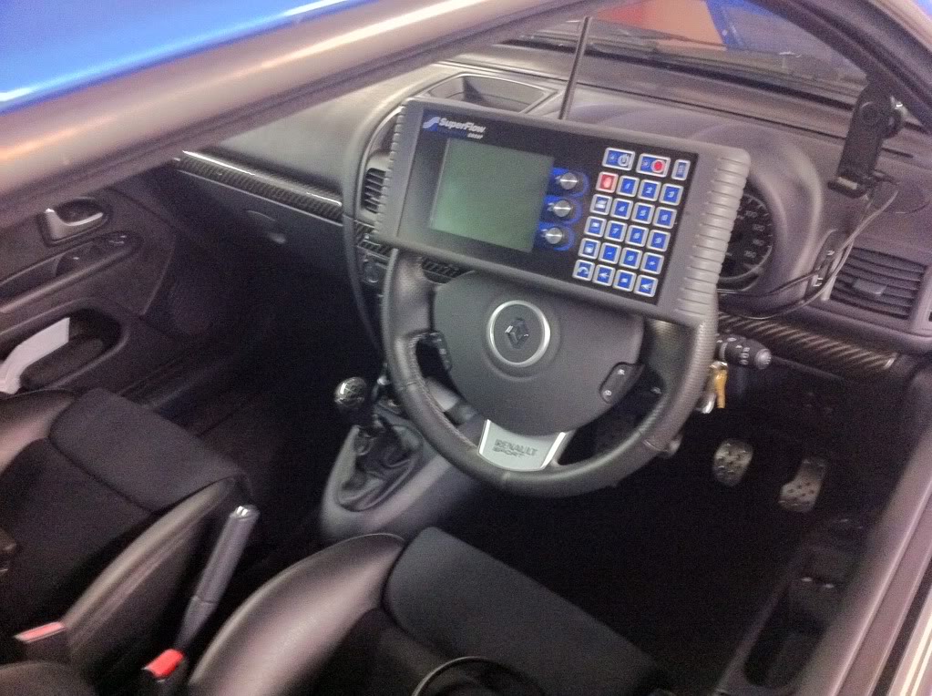

The car went on the rollers prior to mapping to see how it was doing witht he generic JMS P&B map and the cams..
The car did 176 bhp so it had lost 3 Bhp but the fuelling was all over the lace v rich in places and very lean in others due to the cams.
Matt then did his stuff and go knows how many dyno runs!
And then then after a good while of tweaking etc the finished map...

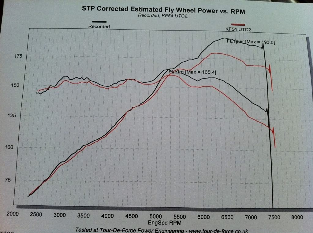

The Dyno plot over the graph prior to fitting the cams...
193 Bhp & 165.4 ft lbs
Im really happy, the car is a lot less peaky when driving and the car pulls really nicely all the wa to the redline now, it very impressive the difference! Overall i am very happy and would reccomend both Danny @ 519 Automotive and Matt at Tour-De-Force any day, top blokes!

Was there for about 2 1/2 hours, car was on dyno for about an hour or so, matt had a basic base map for a 182 with 428's so was able to load that and it gave about 188 Bhp, he then fiddled and tweaked the fuelling etc to 193 :)
