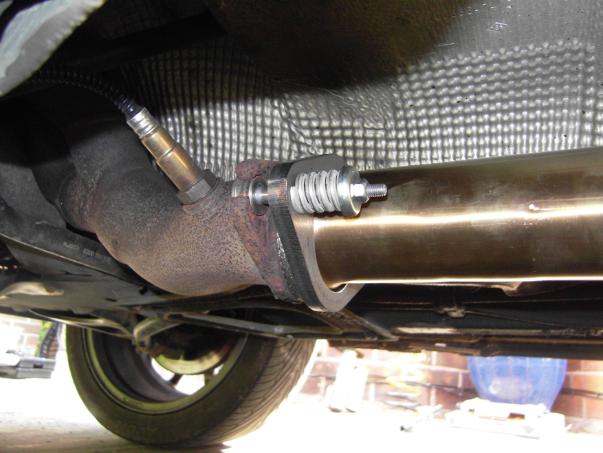

Looking for some advice. I've been out the loop a while on clio's, but now i've got myself another 182, i thought id put a fresh change of oil through it for piece of mind. Whilst doing so, i went under the car to check the health of the exhaust which was fine, but the CAT is shot and its rattling under hard acceleration. The two spring bolts that hold it together are wobbly so the whole thing needs replacing.
What are my options these days? i've got a full SS exhaust on already which is perfect for me sound wise as i don't want loud. Worried if i go de-cat its going to be too loud? Any other suggestions?

is the actual cat broken or just the joining kit?
the kit is cheap around £20

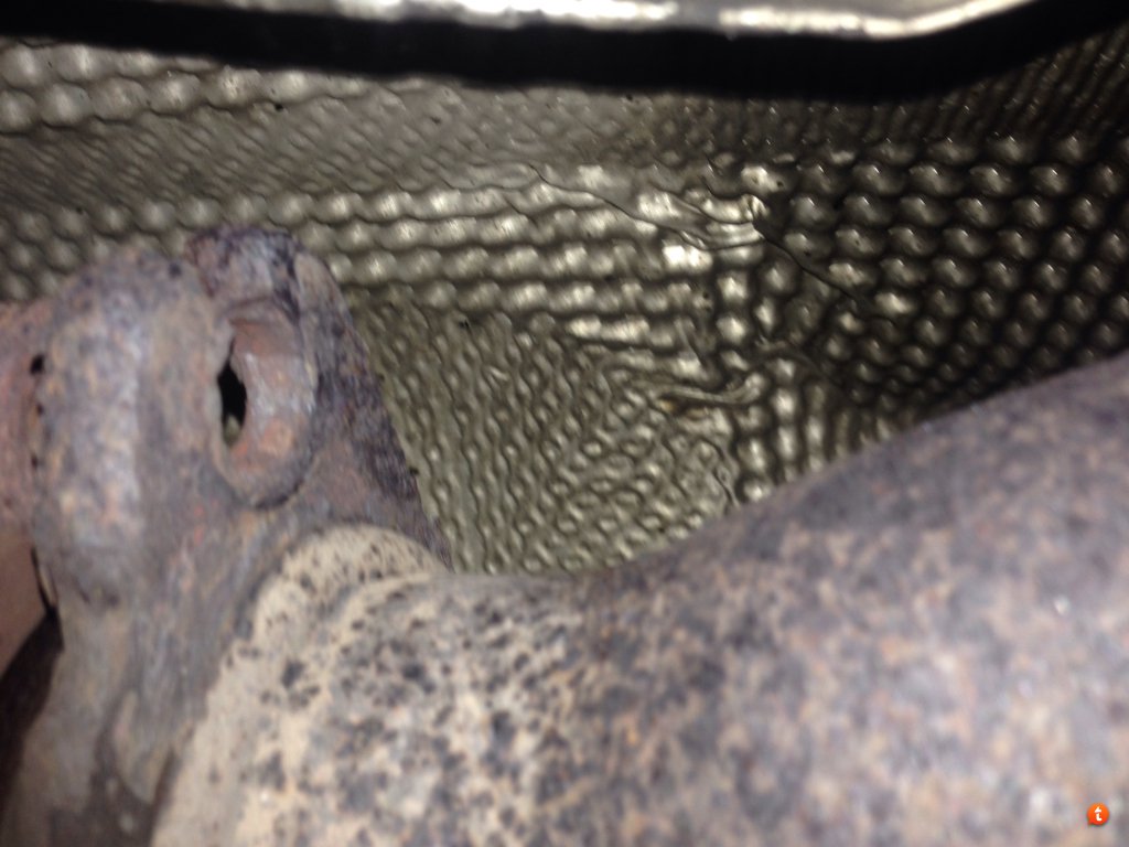

I think its the CAT as the bit where the joining kit goes is all corroded and has nothing to join to... i'll double check later though.
If this is the case, any cost effective ideas?

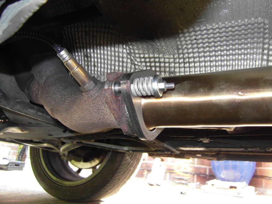

Sure you need a new cat?
There are sacrificial cups that slot into the manifold side which can be hammered out and replaced with a new cat fitting kit are the usual weak part:
