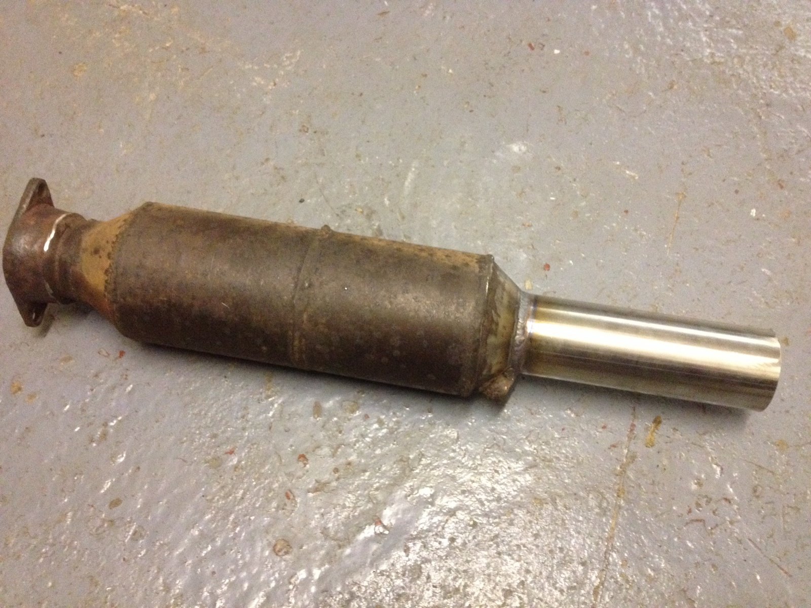

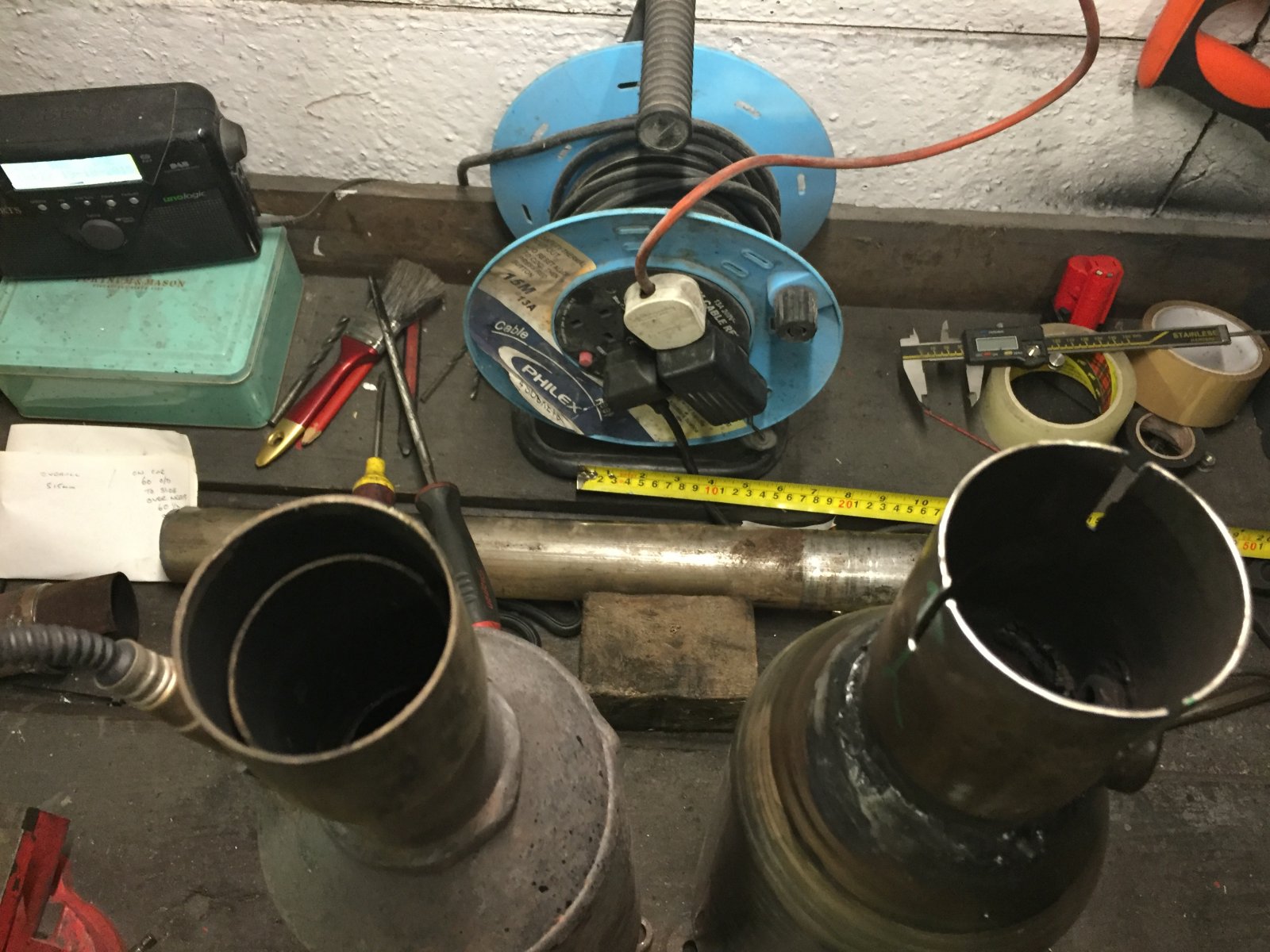

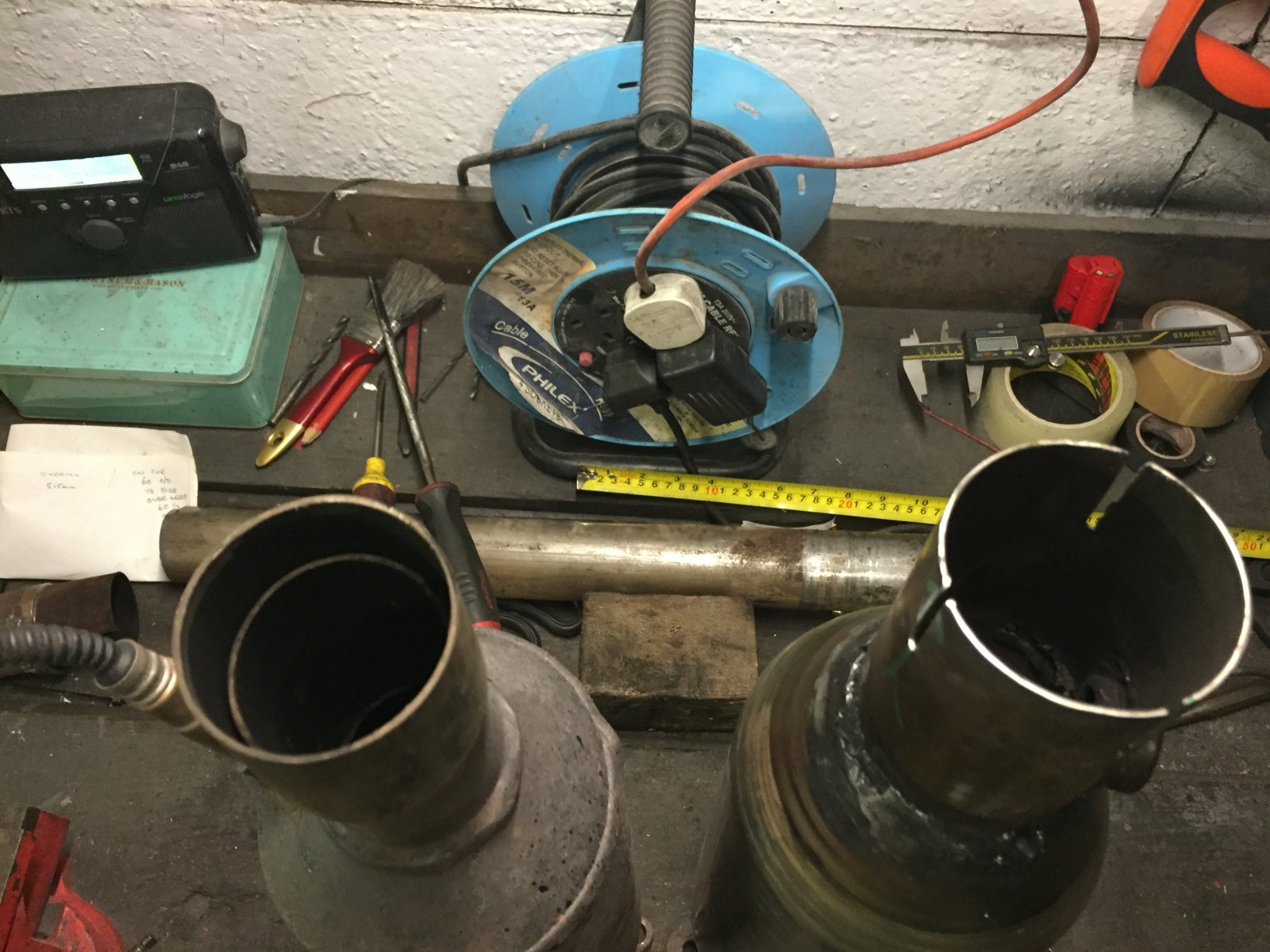

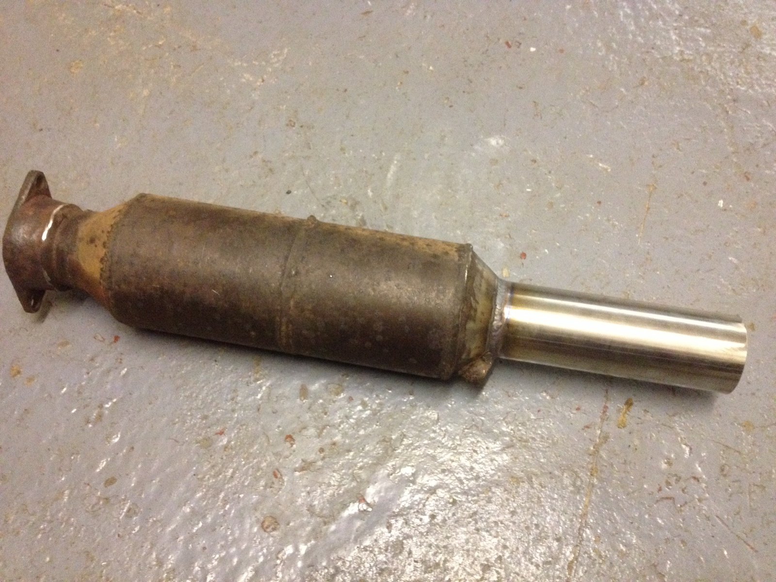

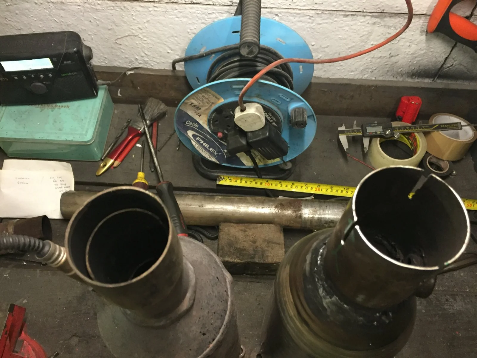

My exhaust is 2.5 inch so I just got a vernier caliper and marked the cat at 2.5 inch and cut the joint off and then trimmed it to fit some 2.5 tube.
Hope that makes sense.

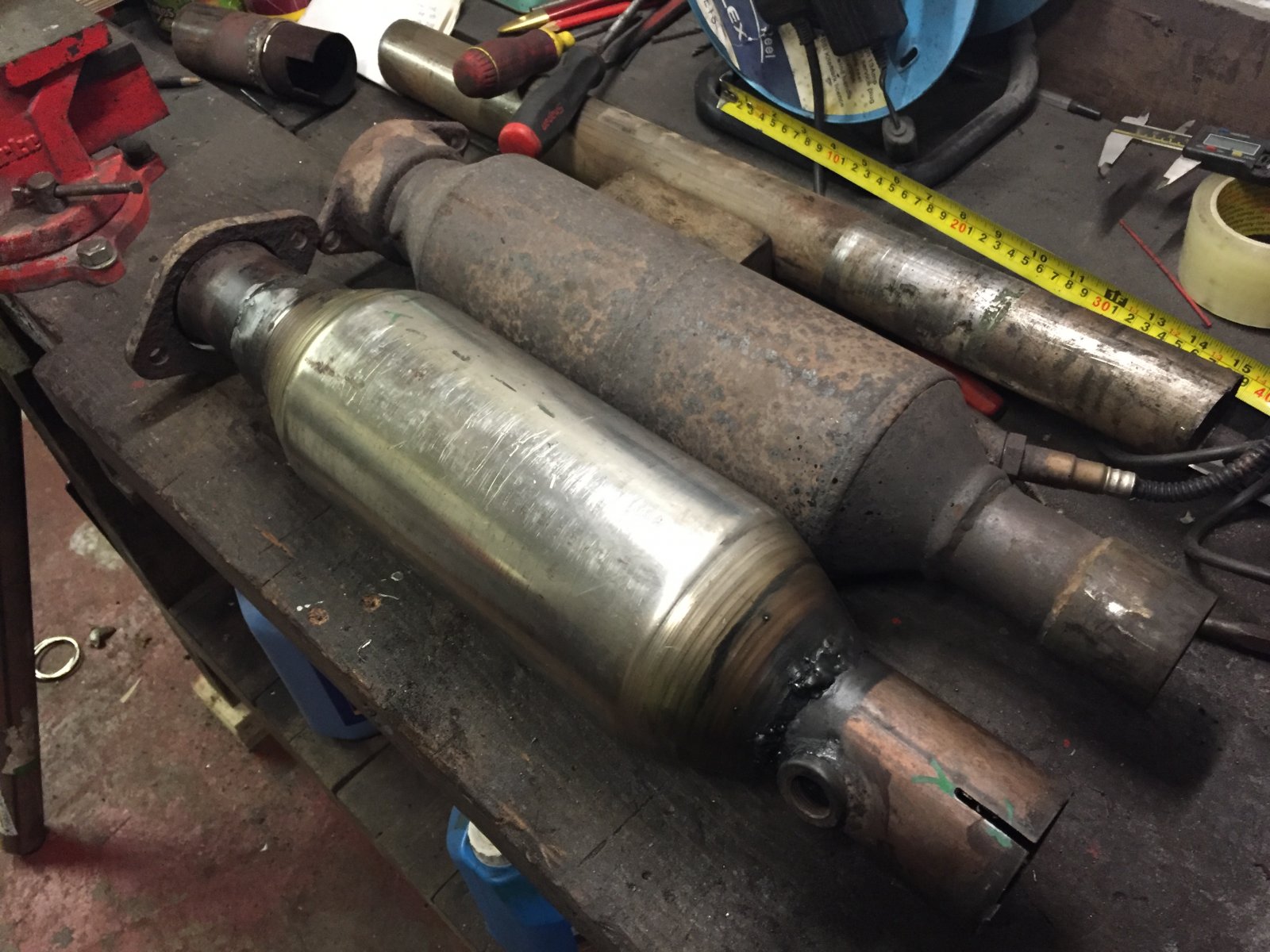

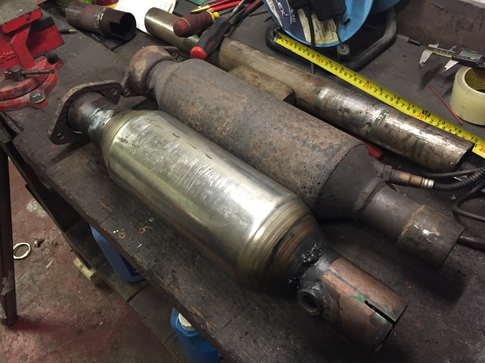

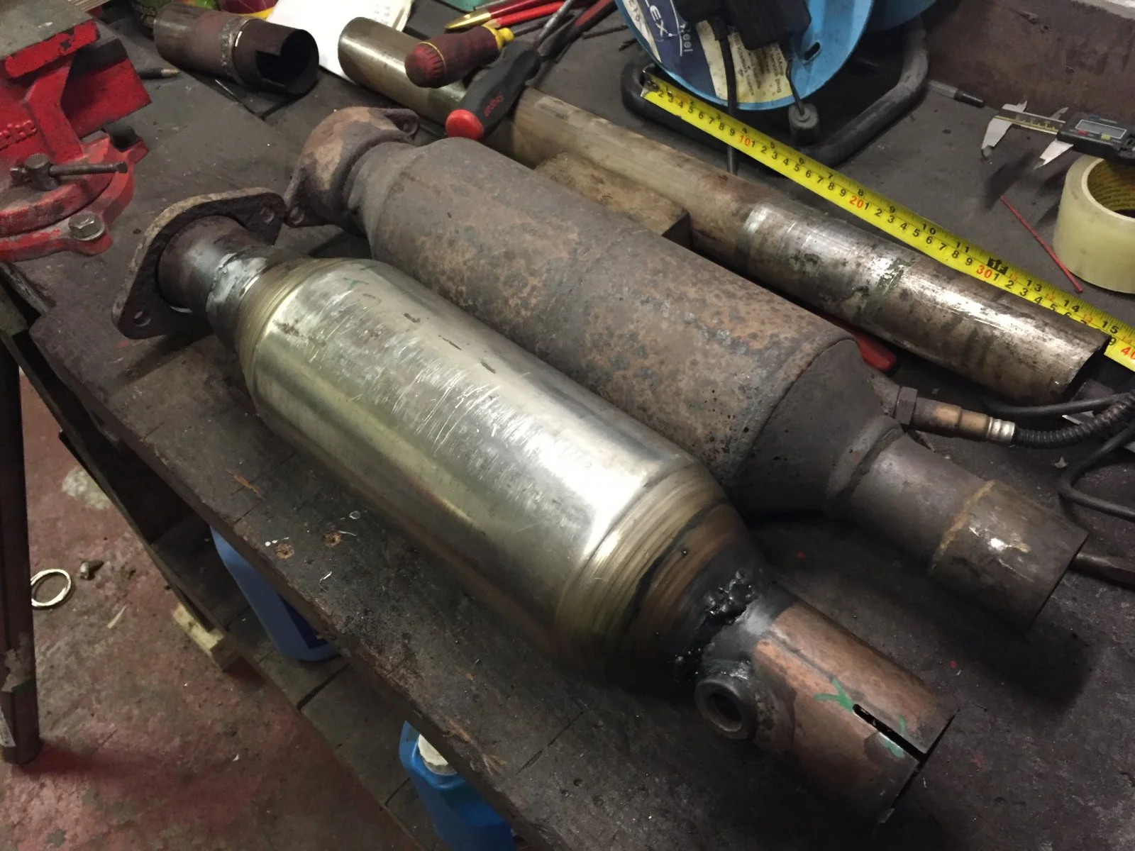

my solution was to make a resonated de cat out of a centre box from an RX-8, still as quiet as a cat but flow better and sleeves over the rear exhaust rather than in to it, (shiny one is rx8),

Don't have any more of them RX8 ones knocking around do you? Need to sleeve mine and that seems like a good idea.
I had mine modified about 4 years back. It was chopped just above the lambda sensor port. I'm sure mine goes over the centre section not inside it. I may be wrong though.
Can't say I noticed any difference with performance, it was done because olive flange on cat pipe was knackered.
