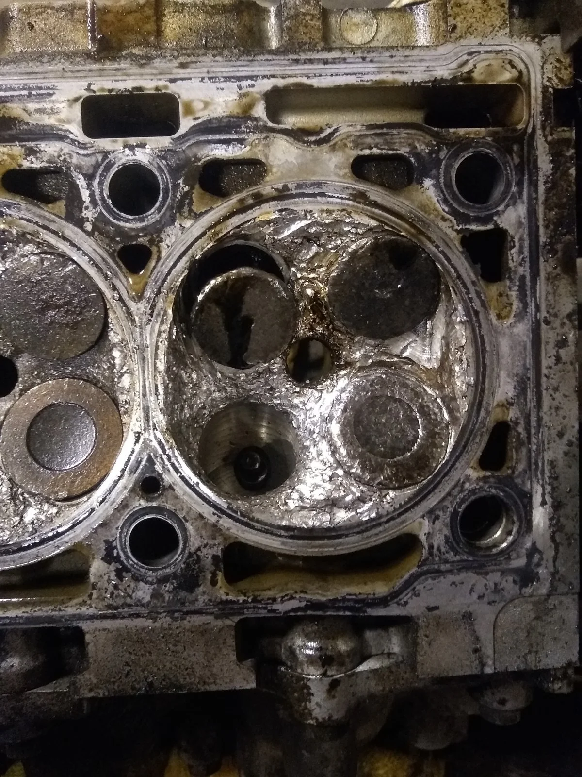

Last Sunday, I was headed off to drop some polish off to one of the boys in my 2004 Clio 182. Driving onto the bypass, 3rd gear @ WOT, 4K rpm, I heared a big bang, bits of engine coming out of the exhaust and a whole lot of smoke.
The car sat for a week until my new engine arrived, pulled the old engine out, new one in etc etc.

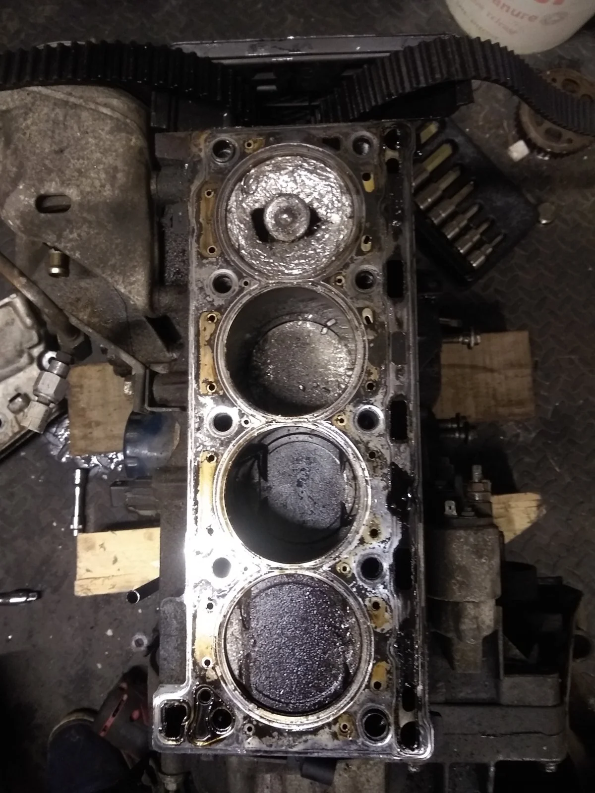

Now, in the meantime I thought I'd strip the original engine just to see what actually when wrong.

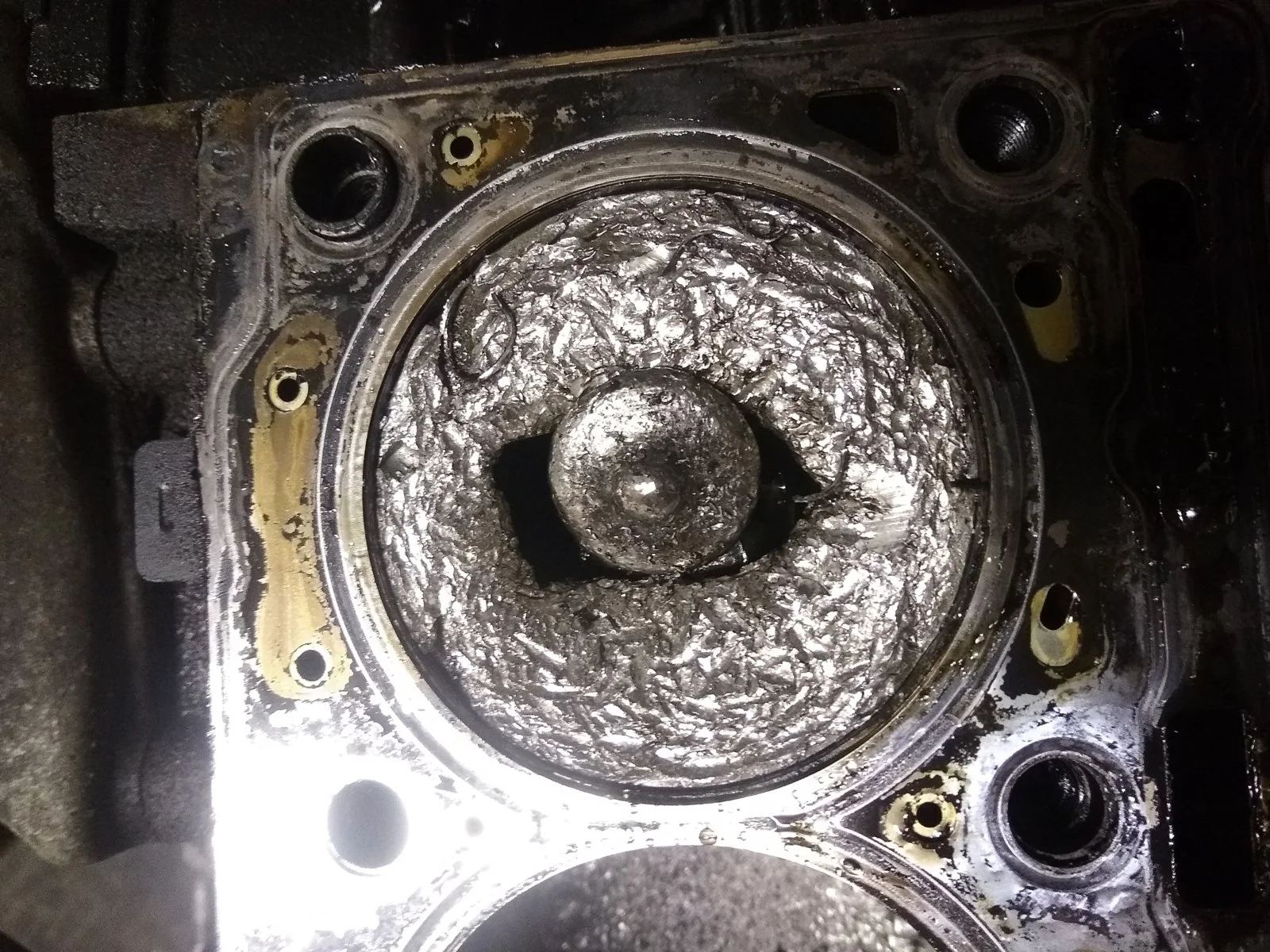

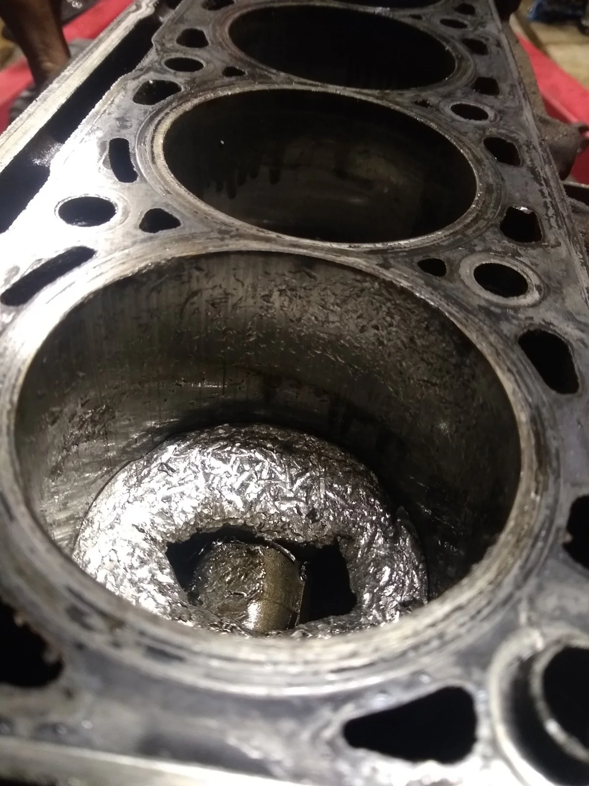

Number 4 intake valve was sat on top of the wrist pin, with a lovely big hole in the top of the piston. Exhaust valve bent like a dog's back leg. Timing belt covered in oil however timing seemed fairly good, but I couldn't be certain as I had no timing tools to check. Nothing at all salvageable. The car has been overfuelling at WOT since I bought it, with black smoke on WOT mixed with blue smoke, and the timing belt looked very ropey indeed.
Anybody feel as though they have some sort of explanation for this failure? Piston looks as though it's melted however I can't imagine that causing valvetrain failure, moreso a lot of smoke and a misfire.
I have a few ideas but I can't settle on one.
- Timing slipped, smashed valves, snapped number 4 intake valve and the subsequent rattling about put a hole in the very hot piston
- The valve just decided to fail, and caused the hole by the valve head flying about
- Overfuelling caused the piston to melt, however this doesn't explain the valve going Pete tong.

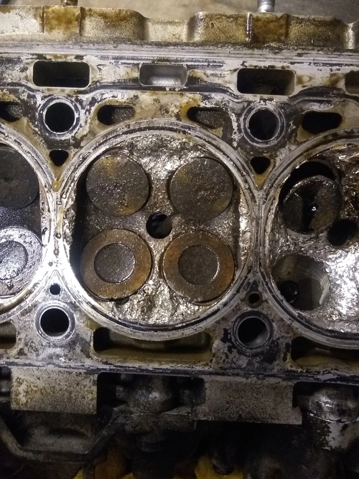

Are two cylinder showing damage above?
Nothing has melted there, thats just the valve which has pounded the absolute s**t out of everything. But no3 is damaged too? With all valves still in place?
Thinking about it, occasionally when one cylinder fails badly bits of piston/valves can be ejected back into the intake manifold and sucked into an adjacent cylinder - think this is what has happened here?
