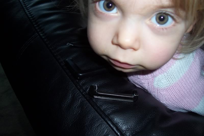

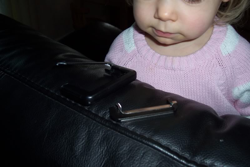

I'm at Rockingham in a week, so in advance the Cup got some long overdue TLC today, Tesco carwash followed by a pathetic attempt to rid the wheels of baked on brake dust, tyre pressure check etc.

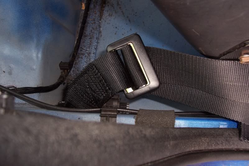

So I'm out giving it its first proper drive since before Christmas tonight, about 40 miles from home and I pull over to tighten my lap belt. I'm pulling the adjusting strap when BANG - my hands fly up and I get hit in the face by the retaining buckle, leaving the harness no longer attached on one side.
I drove the 40 miles home like a pu*sy.
Thank f*** it happened tonight, and not as I connect with the wall sometime next Saturday.
As it should be...
What's left of the other side...
Has anyone had this happen before?
I fitted it in April 2008 (bought from Tweeks), so I guess it's out of standard manufacturers warranty, but surely I should be able to get a complete replacement harness from them?

What make are they. I have never seen them with plastic adjusters before. Manufacturers usually cover the metal adjuster with plastic. More pics.
that's^ what i'd been thinking, having had a look at mine

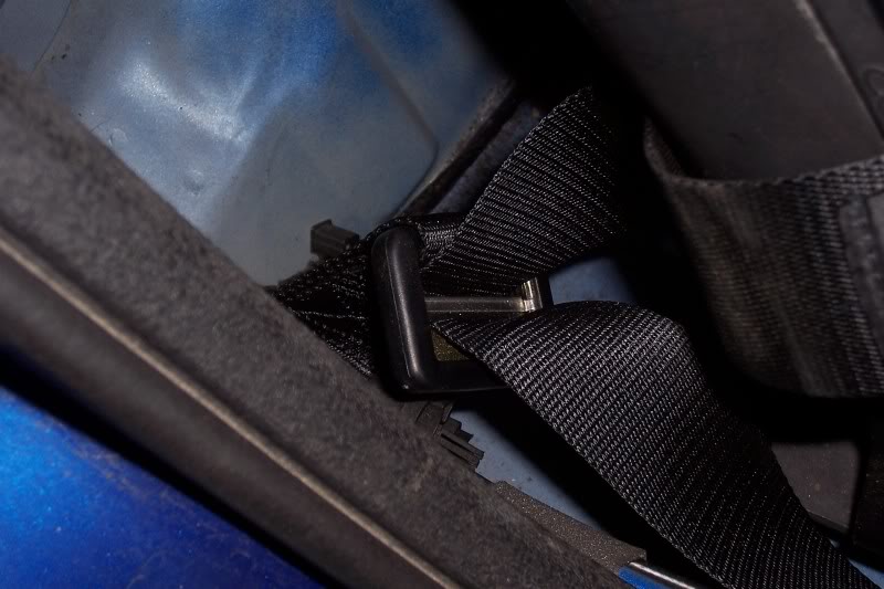

i don't think the belt angle is relevant - seems (from Mark's top pic) that the belt has been looped back against the plastic trim? the belts only run against the steel on mine
seems odd that it's unravelled itself, though?
i'd defo be kicking up a fuss about it, esp. given that's how they were delivered and that they've not been altered subsequently

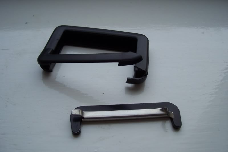

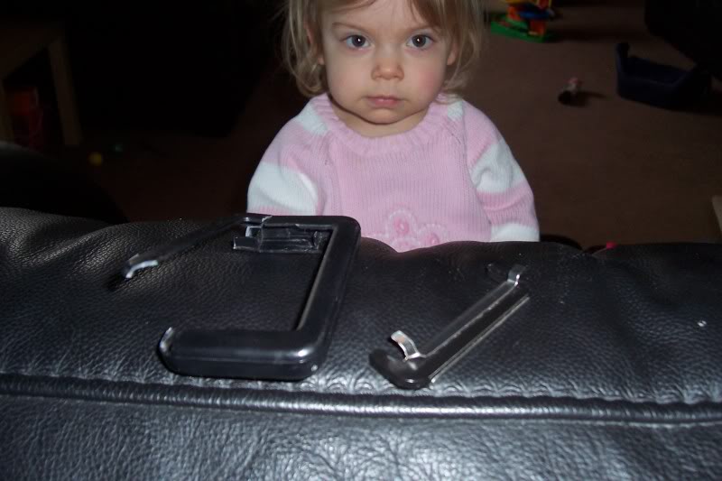

In that second pic, it looks like the metal has snapped??
The top piece is the plastic cover, the bottom being the metal bracket!!
Either way, i'd be ringing them first thing monday morning!!
I've got cobra harnesses (think TRS make them) and the adjustment bits in question are metal with plastic around them. How the hell the snap though is beyond me. You'd have to be giving some serious force put it that way.
i see what car.crash is suggesting - does look as though the trim has come away from the steel; unless the steel has also broken? presumably the belts were threaded in such a way that the plastic acted as a friction brake. can't really tell without more info
either way, they're designed to restrain 70+kg, decellerating from speed in an instant - there's no way you should be able to compromise them just by tugging on the belt

Thats what I was thinking. Saying that the steel should still be sufficient to hold the straps in place. On mine the plastic bit is just for show from what I can tell

I've just looked at my old (really old, really really old...) sparco harnesses in the airing cupboard, and they have a metal bracket as a sort of brake, covered in a plastic coating. Looks prett much identical to a lap belt in the middle of a rear bench seat.
If Marks are the same, the metal has deffinately snapped judging by his pics!
  Clio 182
May I suggest you look again and this time, you open your eyes?
I can only see snapped plastic and no metal. As the buckles are made from metal I assume they are still intact. Who would make plastic seatbelts. I agree it should not have broken off.

The first picture is how it should be. The second picture is the broken plastic, but no broken metal is present. May I suggest you look again and this time open your eyes!
As I said it certainly should not have happend but it will be enough to get you home. The strenght is in the belt and the metal buckles and not the plastic as it would snap on impact. Tweeks should replace immediatly.

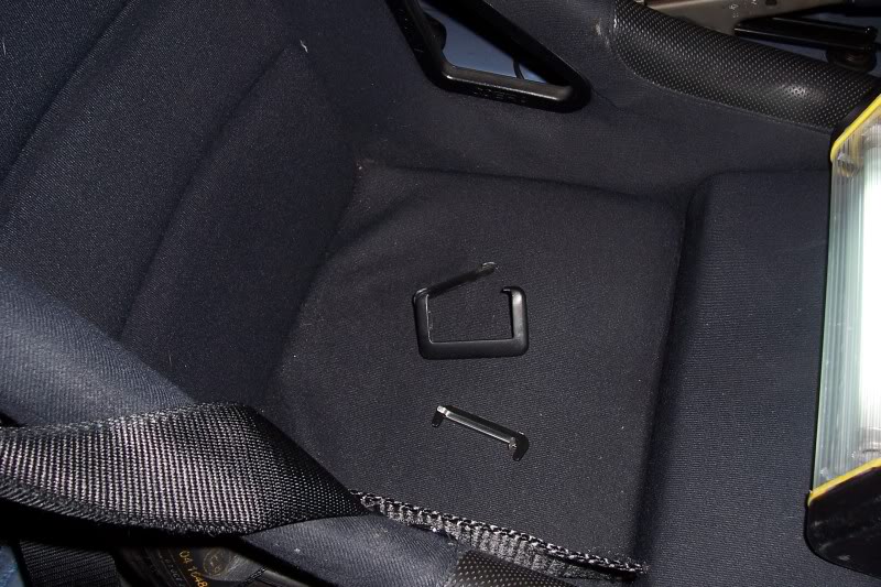

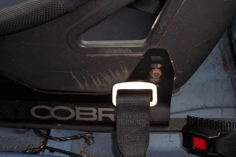

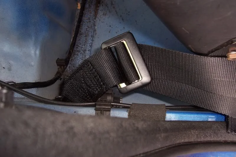

Right, spent a bit of time piecing it all together, and the news is.........it was fitted wrong!!!
Here's the other side which is fitted correctly;
In the second picture you can just make out the centre cross bar (black) which takes the load.
What I'm left with from the failed side;
Note, no cross bar left here
Excuse the ASP
The simple error of having the belt threaded through the wrong way had the load on this cross bar reversed, and instead of a piece of 3mm steel holing me in place, I've done countless trackdays with nothing more than a thin bendy piece of tin meant only to retain the centre cross bar in place for security, which finally gave up when when I pulled over and gave it a bit of a yank.
The actual harness is an OMP basic affair...but I'd imagine other makes have similar buckles; I urge anyone with a harness to go and check yours are fitted the right way around now.

to my untrained eye i can't see any picture there which has the strap in the correct place.
the bit which has snapped should not be taking any load merely acting as a brake to stop the straps moving after adjusting length, the strap should pass through the big brass square and then the locking bar.

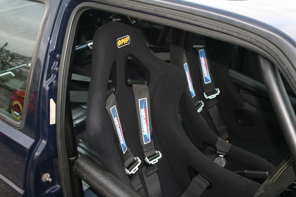

i've checked my Willans and think the buckles are a different construction, thankfully
