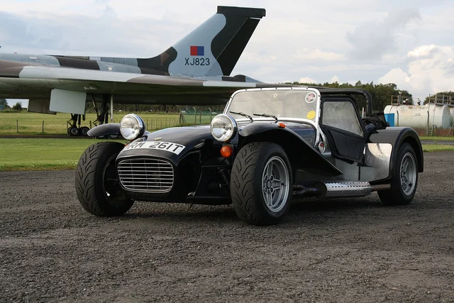

Right so, some of you may *remember the 1979 Caterham Lotus Super 7 I was driving. Which I was getting fixed up & back on the road, 6/7months later and here it was in it's prime, last Aug/Sept.
Super 7 by PSJHodgson, on Flickr

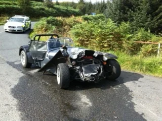

..Then on the 18th of september It ended up looking like this! The result of a Head on with a Vectra!
(sorry on the quality, it's the only photo)
Crash by PSJHodgson, on Flickr

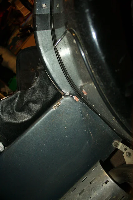

Here's a few closer pics of front the damage.
Damage by PSJHodgson, on Flickr

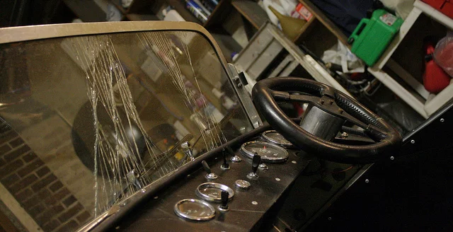

Signs of the bent chassis
Note that steering wheel, yes my face did that!

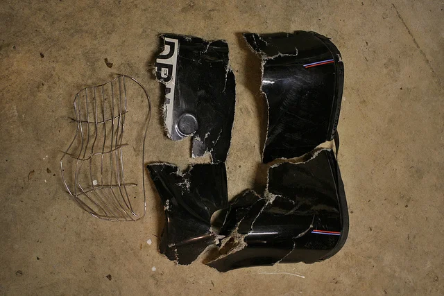

What's left of the nose cone & grill

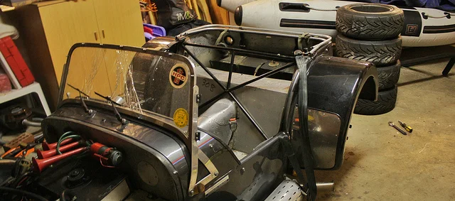

This is how it is now looking after starting stripping.
Stripping by PSJHodgson, on Flickr
Plan it to keep it original! Old school and retro with a few modern tweaks for reliability purposes mainly.*

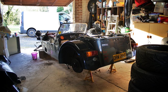

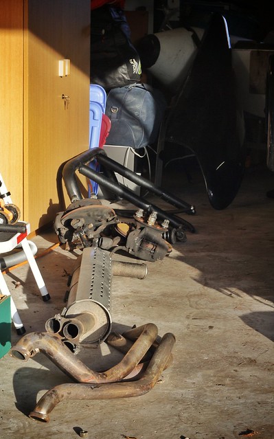

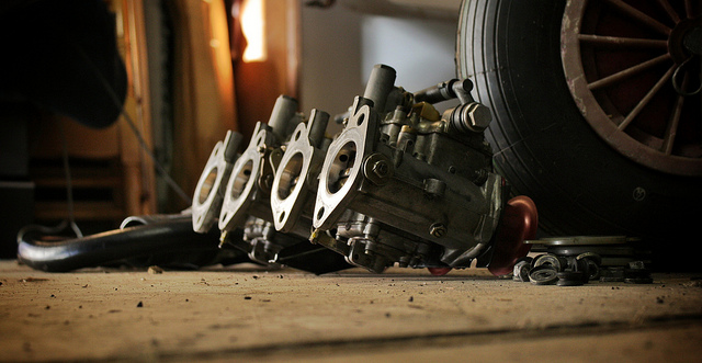

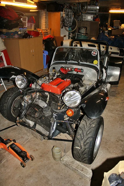

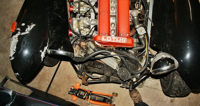

Spent a good few hours on it today with the help of a good pal,
Got the front wings off, front suspension & brakes off. Plus removed the Centre tunnel to get good look & access at the prop shaft etc. Exhaust and Dellorto Carbs were also removed.
Here how she's looking to date..
Good parts by PSJHodgson, on Flickr
Most likely going to have to get the grinder out next time to tear away most of the front! Then I guess it's engine & gear box out.

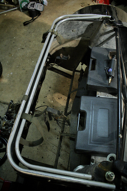

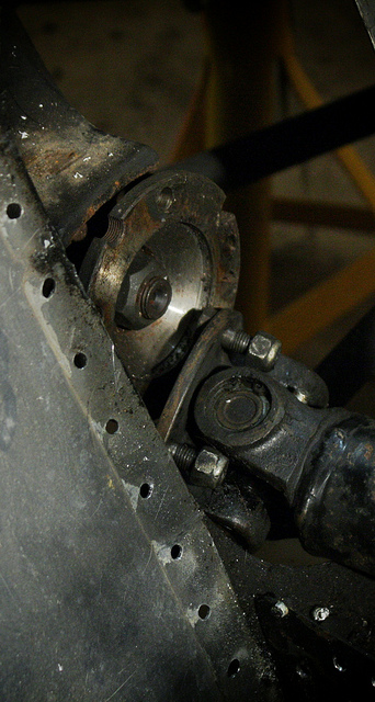

Tuesday night we spent a couple hours stripping loads more stuff.. Ripping away body pannels to get access etc.. Here's a few pics..

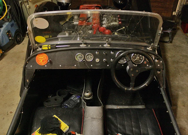

Dismantled prop-shaft from the mexico rear axle..
Super 7 strip by PSJHodgson, on Flickr

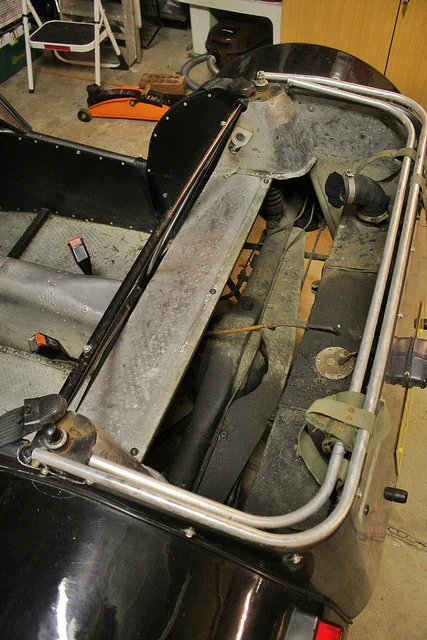

Removed fuel tank, lines, filter and pump..
Removed heater, horns etc..

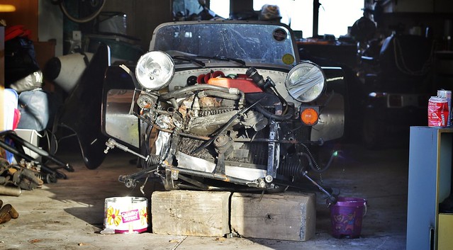

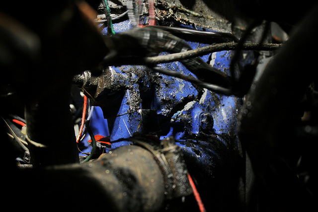

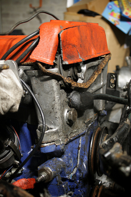

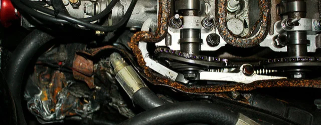

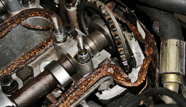

We also managed to leaver back the crushed front and got a better look at the engine. Unfortunately it is looking worse than expected or what we had hoped :(. Cracked from top to bottom. Fortunately its the timing case which is easy replaceable but we still don't know what the story is inside the engine.

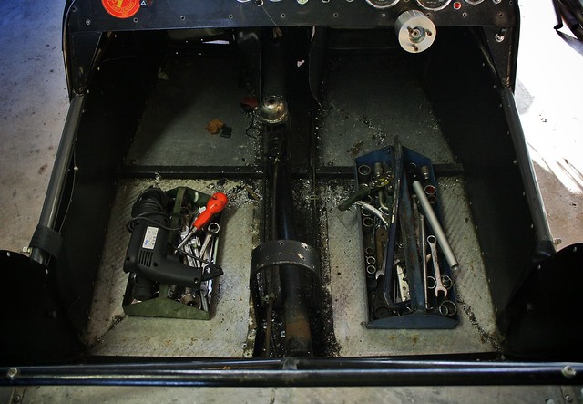

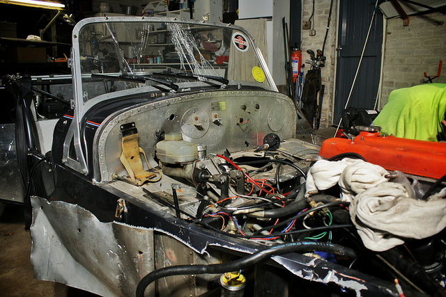

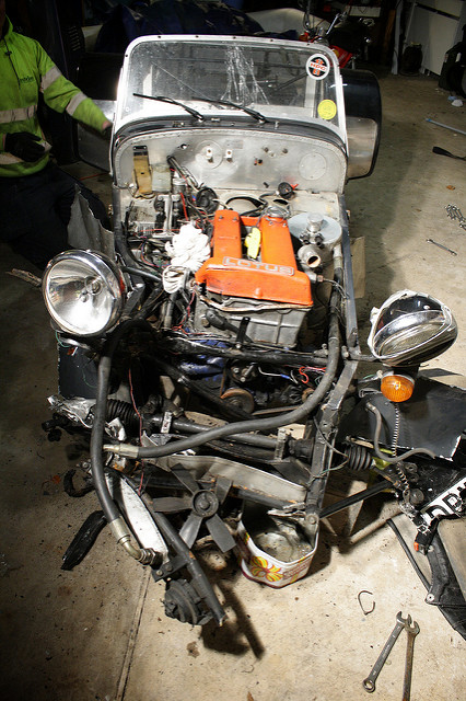

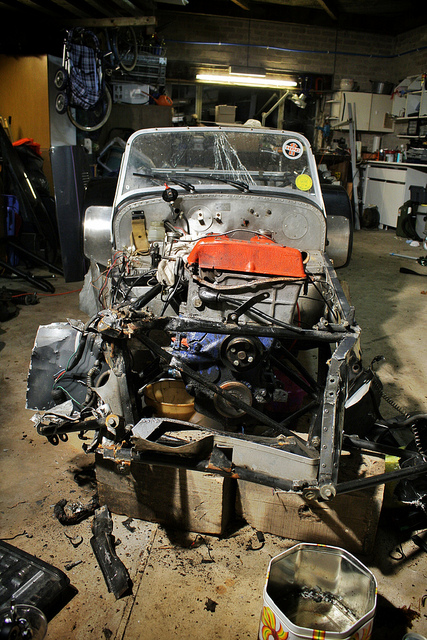

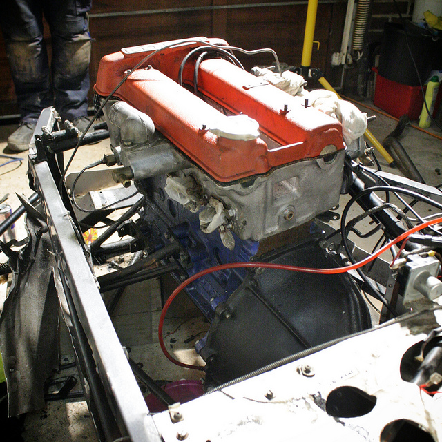

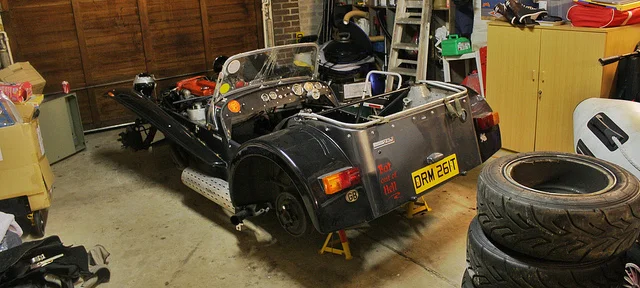

Then tonight we spent another couple hours on further stripping - drained engine oil, removed oil tank and hoses, dry sump, oil cooler, radiator steering rack, alternator and loads of other bits..
Mid proccess..

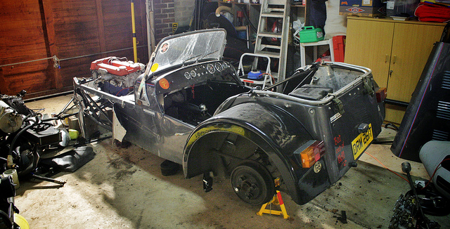

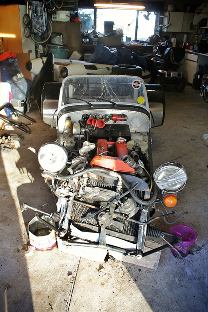

How the 7 stands to date..
