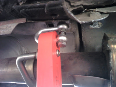

Hi. I have a Clio Mk2 1.5 DCi and need to fit a new centre exhaust mount. I have linked to a picture below that I found in another thread. This one below is a modified mount but I have bought a standard mount.
Basically mine corroded badly and snapped off (millage is 125k and probably original mount). The hole where the pictured hanger is mounted to; is this what the hole on the standard mount lines up with? Mine is blocked off because the bolt, it would appear, sheared in two and is still in there. How does the original fit? Is it a bolt up through the hole with a nut above the hole? If so what is the bolt and nut I need?
Also how would be best to remove the sheared bolt? It is completely corroded and sits flush with hole. Would it be ok to drill through it?
