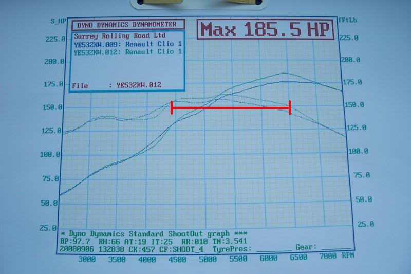

It's all about the torque - that's ultimately what accelerates/pushes the car along, and you have none above 6,500 rpm...and masses from 4,500 up to 6,500...
^^^ from 6,500 EVERYTHING is going downhill, and from 7,000 look at how little torque there is...less than at any other point in the rev range almost.
In the lower gears (1st/2nd) when wind resistance isn't such a factor then it can be worth holding it until say 7,000, but from 3rd onwards I've found my car hits a brick wall at 6,500 rpm as soon as the torque drops off. At those speeds in those gears changing at 6.5 drops you right back into the meat of the torque at 5k and you keep on going.
Watch this video of my rev counter and speedo during some acceleration runs, 3rd gear is at 0:44 and 4th is at 1:04 - watch how the speedo needle slows as soon as it gets to 6.5k...it's painful after that in 4th, takes forever to get there...really noticable how no torque sees a drop in acceleration.
[youtube]odTwrUXNlsM[/youtube]
On track the only reason I'll go higher is if a corner's coming up and I need to save a pointless shift - aside from that I stay between 4.5 and 6.5.

Change just before the limiter in 1st and 2nd a lot. Might try shifting earlier though after seeing the dyno print out above. On my general everyday routes, no space or not safe to push to limiter in 3rd.

Well looking at that I'd suggest 5,000/5,500 to 6,500. If your changing at 4,000 in the time you've taken to change gear you've lost a load of torque and power.

I do share the same sentiments as you though, I always change where peak power is made. There's no more pulling power after that, just momentum.
you want to chnage gear where the car will make the most adverage hp to work this out you need to know rpm drop an a rr printout. For mine chnage up point depends on gear but for first its about 4.5k then goes down to about 4k in 4th gear
