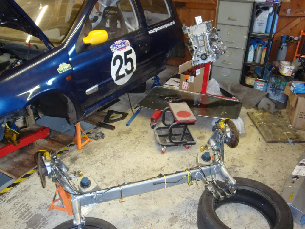

powdercoated rear beam, hes a long way offHe's nearly there.

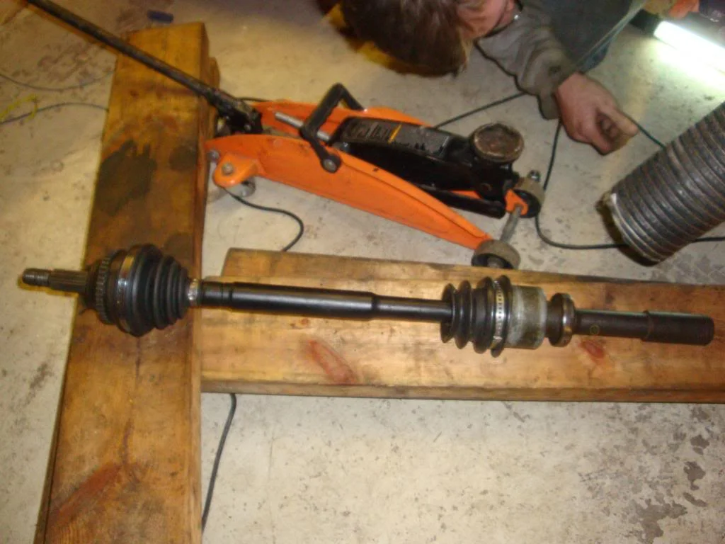

I like that they have tried something different and ultimately this solution is very good once it is working. Popping a drive shaft is not unexpected and I imagine they guys weren't surprised but maybe a little disappointed. This is a great idea, it maybe a little over kill for this level of racing, but when they get it sorted I wouldn't be surprised to see more people doing it.

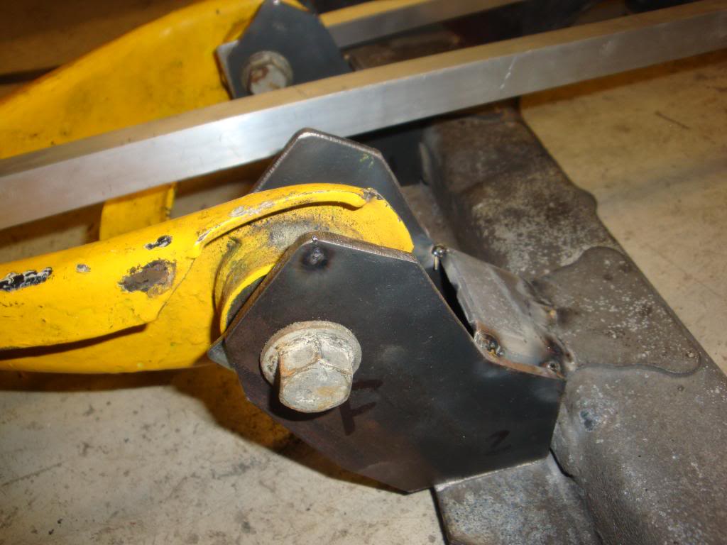

These mods are pointing towards what has been with the racers except I think it could have been tackled slightly different by using cup track rods and ends (no rack spacers) extended driveshafts and rather than raising inner pivot points on the wishbones, making the adjustment on the outside with a taller and longer bottom ball joint( RCA pin) the way chase have done it is to adjust the roll centre without having the correct relation between the crossover points of tyre contacts etc of roll centre.
This is the same way I am going about raising the roll center! I cant see the need for extended drive shafts unless your changing the location of the ball joint to a position further out though.

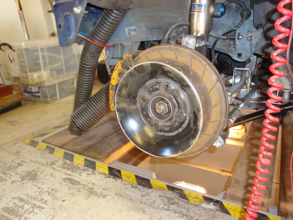

You've certainly been busy.

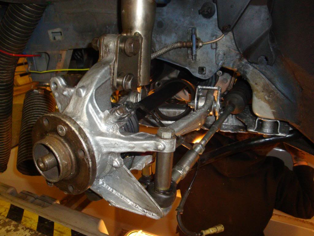

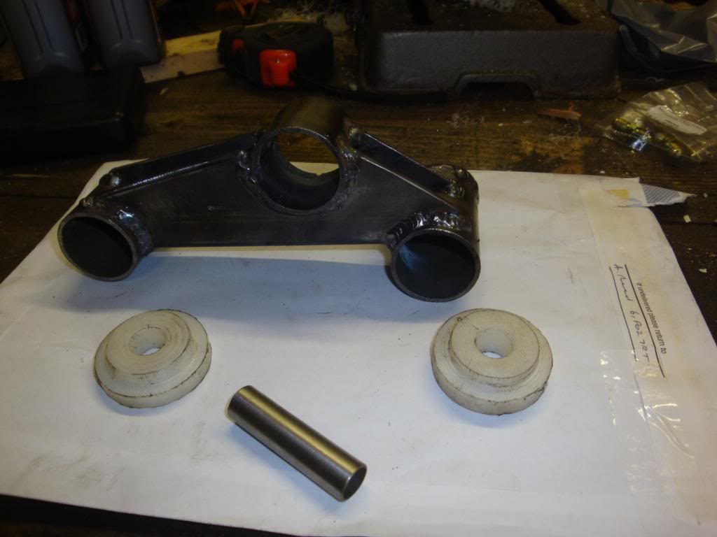

Plenty scope to adjust bumpsteer now! Who did you get to weld the brackets onto the uprights? Assume it welded ok? pre-heated and cooled slowly?

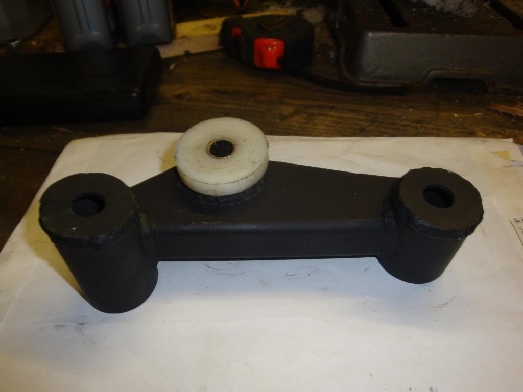

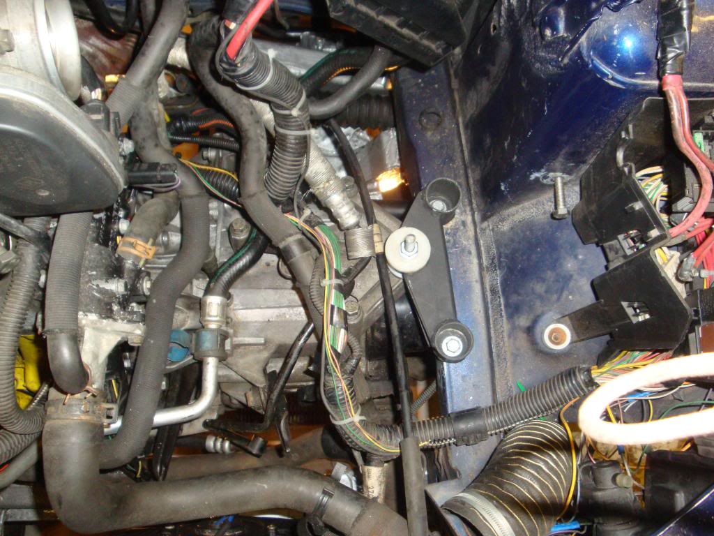

One point on the gearbox mounting, that is now unquestionably the stiffest mounting on the engine&gearbox as such it will take significantly more load than the others. Hopefully it does the trick for you but I suspect the original alloy bit may be the next weakest link.

Some good progress. I will echo what others have said, the gearbox mount and hub setup looks questionable for strength. Neat idea on the hub for adjustability but cast metal doesn't take to being welded in high stress areas...even with the correct welding process of heating and annealing.

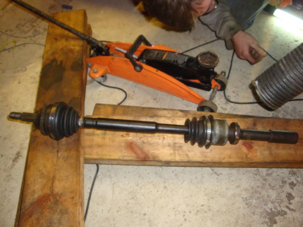

Did drivelink do your friction welding?
