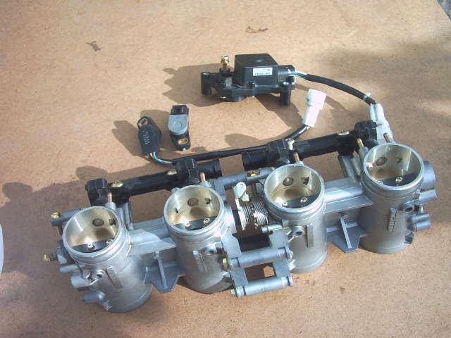

Following on from my/our 205 R1 build (which almost works)
Ive decided to (slowly) work on trying to fit a similar system to the 182.
Ive got hold of these
For not alot (£75 thats not the actual ones in the pic.)
All i need to do now is get an ecu and a manifold made up.
I will keep you updated as i go, just need to to a bit more research.
  Milltek'd 182

im intrested in doing this to as my mates dad does all metal work so could get the manifold made up easy were did u get the itb's from are they off a bike mate
  Lionel Richie
yeah they'd work, we did it to my mates rover k-series 1400 engine (ran on the std ecu too!!)
not as good as Jenvey's etc, but a hell of alot cheaper!
get an inlet manifold gasket as a template and then get a copy of that machined/lasercut out of ali and then weld some tubes on, couple of bits of silicone pipe and off you go

i assume its not quite as easy as getting bike trumpets and a new inlet, ecu and away we go?! does look like a nice halfway point from the jenveys though as they are pricey!

Yeah I'm sure some problems would be met along the way. It has been done to a Vtec engine searching on google. And I'm sure others have done it. I'd be very interested in doing this if it works out.
Well thats what you do with jenvey.
So yes it is.
But dont get too excited, i only have one part sorted.
