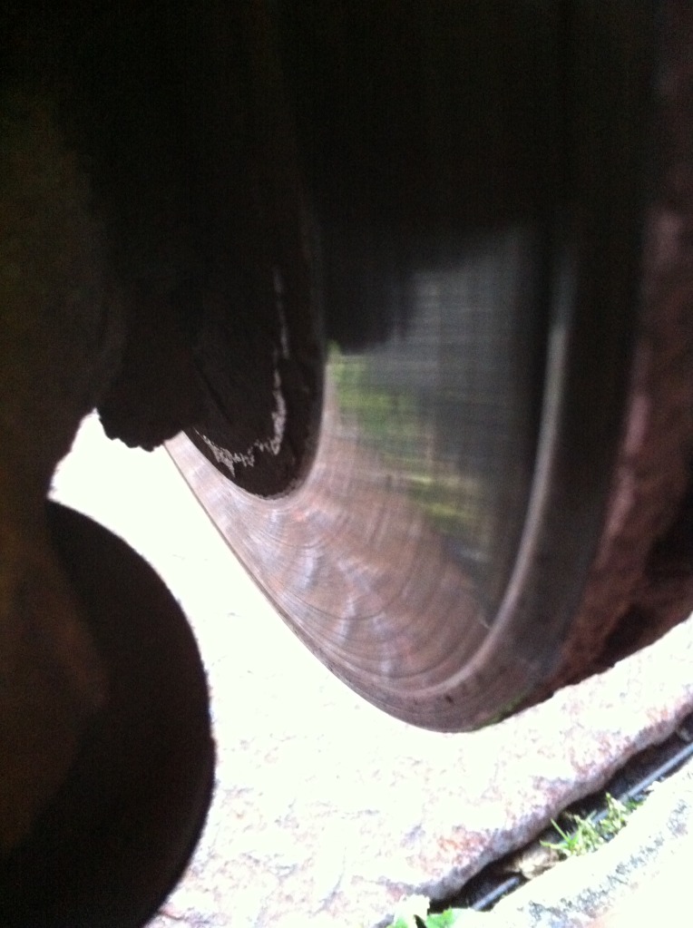

This noise is doing my head in! Started yesterday, and only does it when I'm at a constant speed in a straight line. Initially I thought "wheel bearing" as it went quiet when I turned right but then I soon realised it goes silent whether I turn left or right. It disappears under braking, is there when I'm coasting along (in gear foot off accelerator.) I've jacked the car up and theres the slightest bit of play in the wheel and a very faint dull clunk which I'm not sure is the bearing. My only other thoughts were brake pads/discs. Anyone ever had this and know exactly what it is? I'm saving up for dephaser/cambelt etc so ideally would like to get this sorted on the first attempt.
This is said noise:

I'm pretty sure I've narrowed this down.

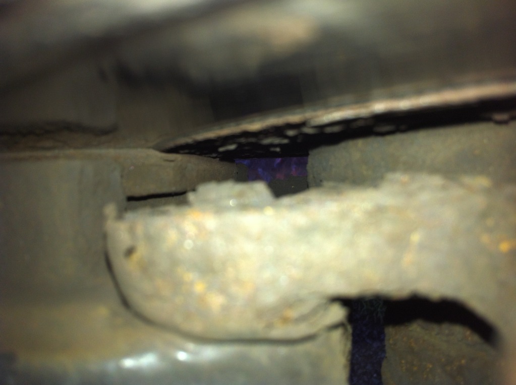

Took the wheel off, inspected the disc and the side facing away from the car was fine. I check the other side and:
Now I'm not mechanic but that doesn't look normal at all to me!
The culprit?
Just need some discs & pads it seems (I hope!)
