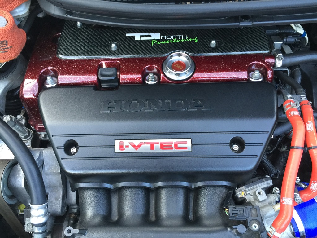

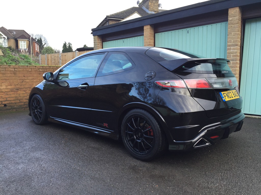

Since breaking my clio at the back end of last year I was left needing something to fill the void. I couldn't help but look at jap cars again since selling my Civic Type R EP3 4 years ago. It's just something about Honda's and there high revving engines that is so addictive.
After looking around for a bit I decided on an FN2 type r.
Fast forward a little I now have a 2008 Honda Civic Type R GT in pearlescent deep pearl bronze.

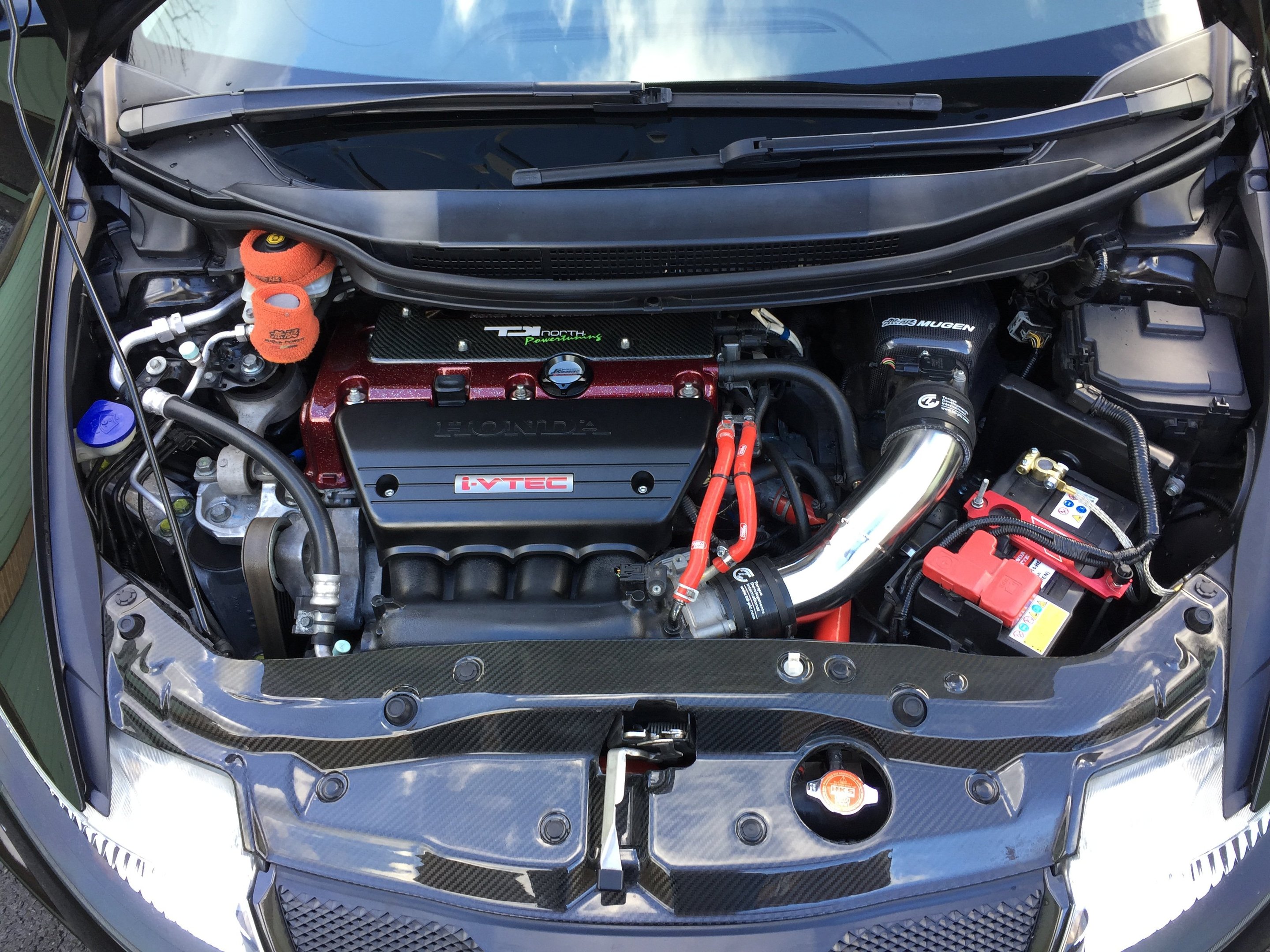

Full spec

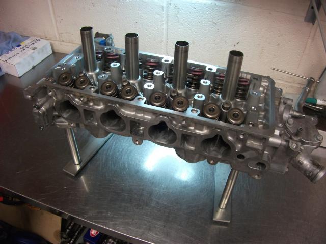

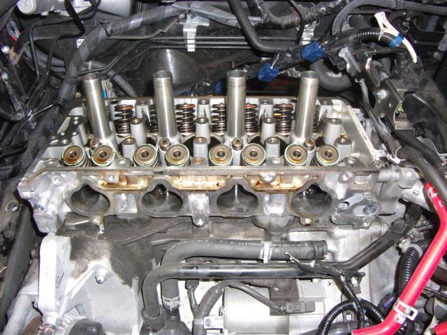

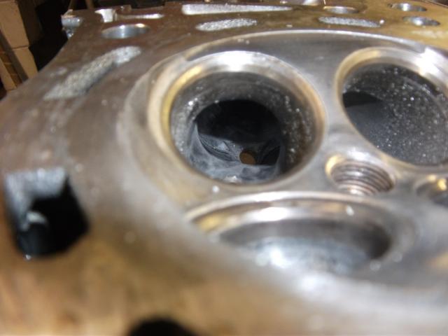

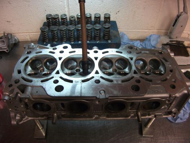

Ported head
Cosworth Thinner head gasket for increased compression
TDi North stage 2 cams
FD2 air intake manifold (RRC) ported to head
RRC intake manifold cover painted black
FD2 throttle body
FD2 oil pump & balancer shaft delete kit
Toda valve springs
Walbro 255 fuel pump
RDX 410cc injectors
Mugen intake kit & hard pipe
Mugen Sump
Clockwise drop in baffle
MFactory magnetic sump plug
Hondata Flashpro with custom map by TDi North
Polybushed engine mounts
Samco hose kit
Custom spooner cam cover
Carbon fibre spark plug cover
Carbon fibre slam panel cover
Engine is currently at 253bhp & 158 lb-ft

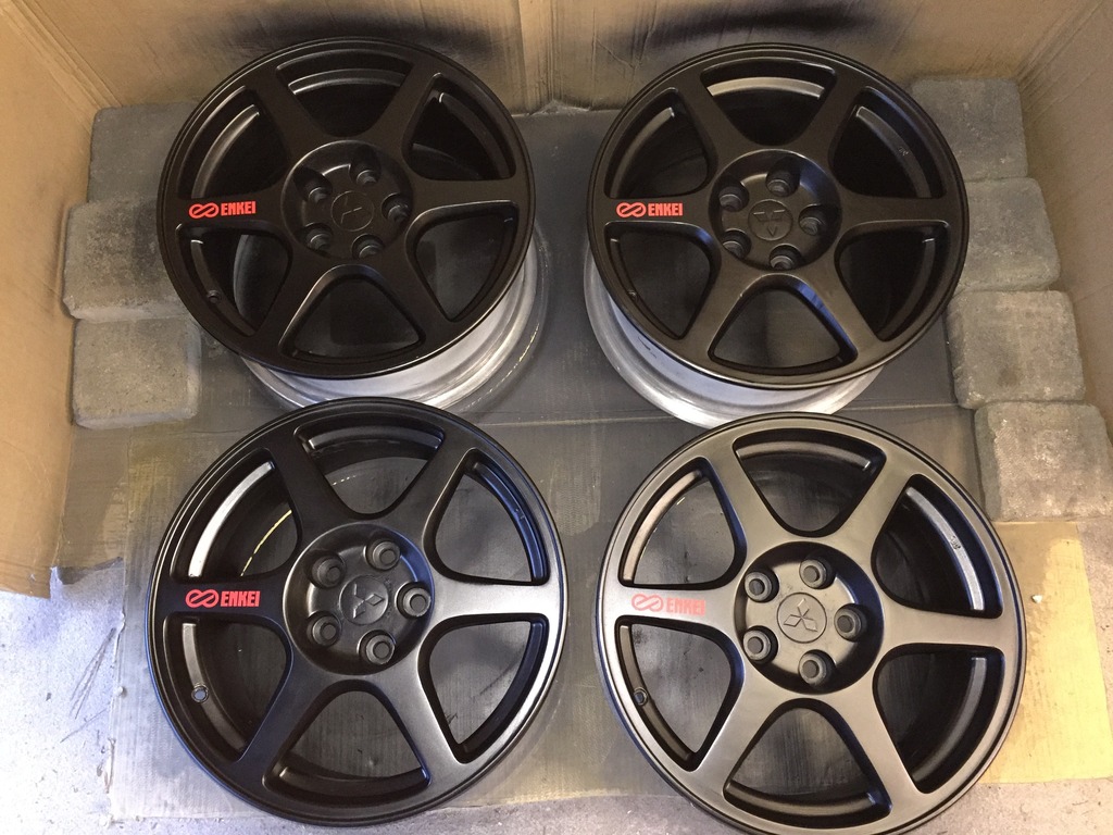

Evo 8 Enkei 17x8 et38 wheels - track
235/45/17 Toyo R888 GG - track

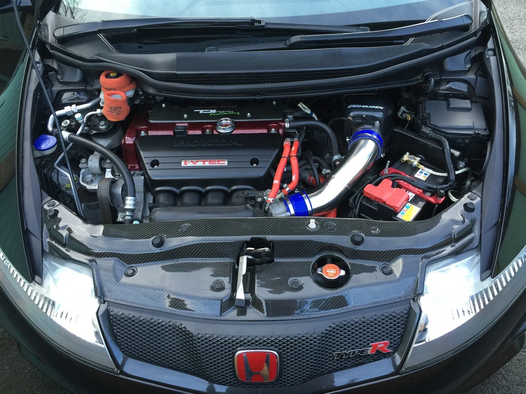

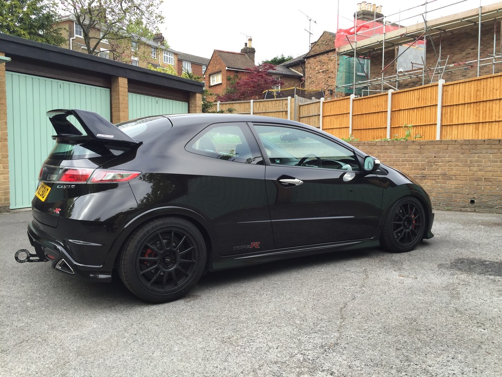

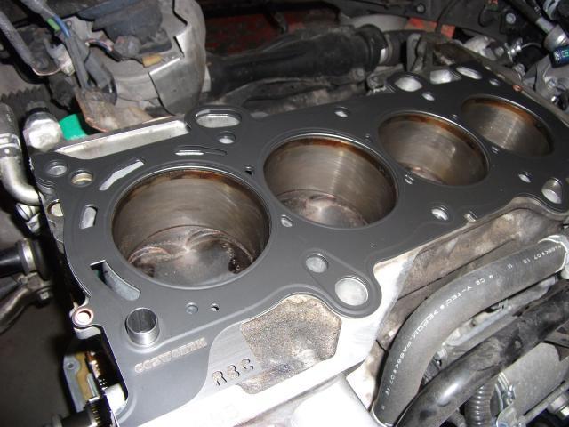

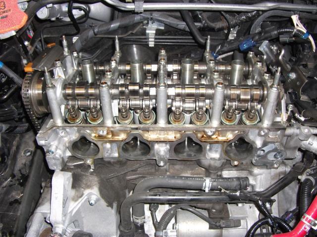

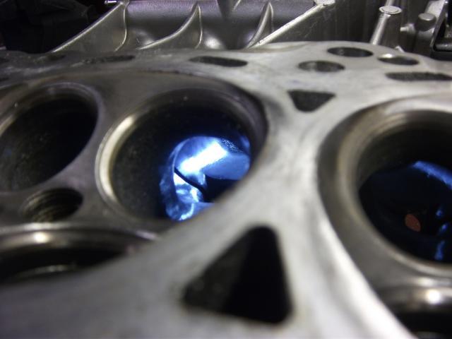

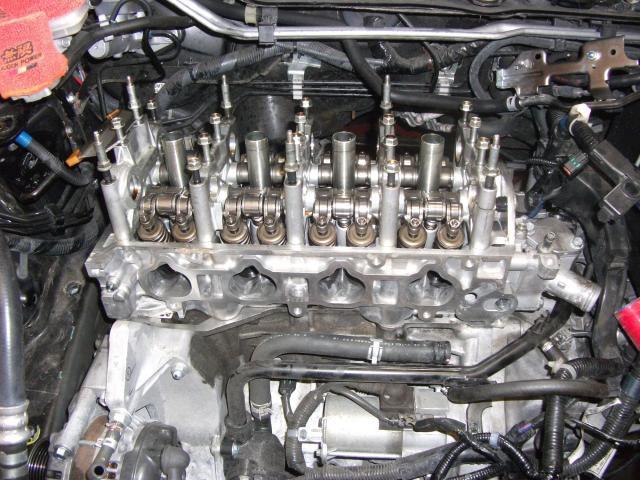

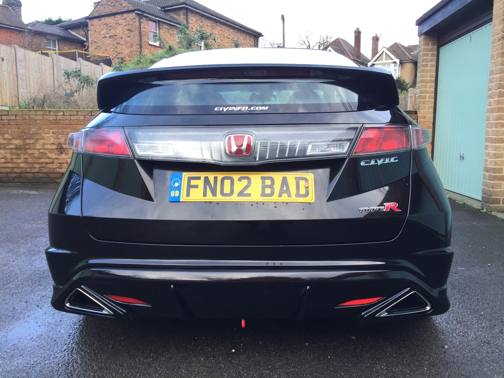

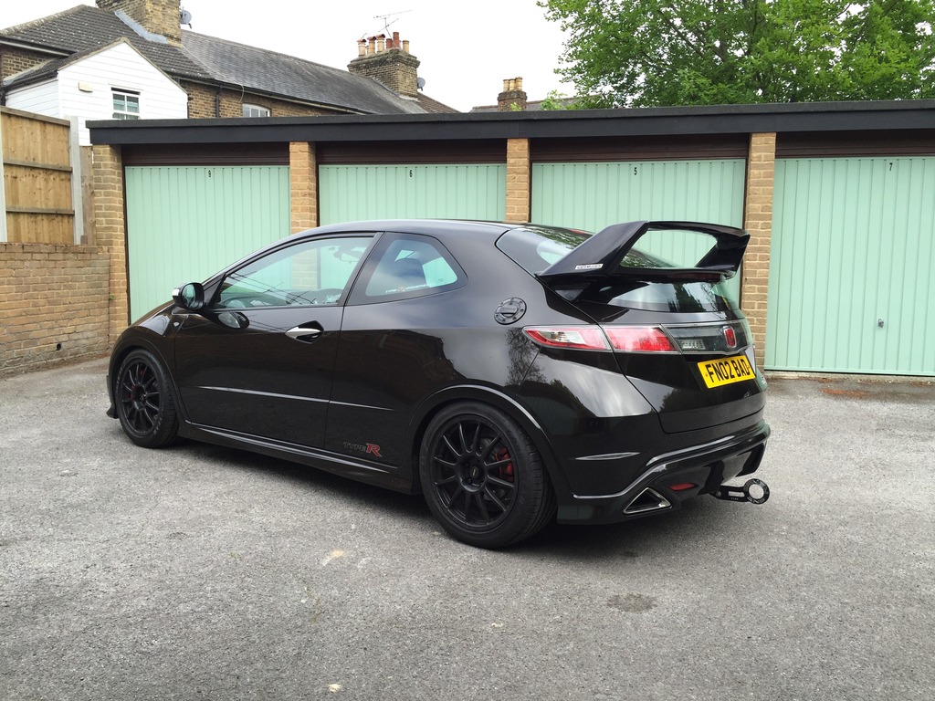

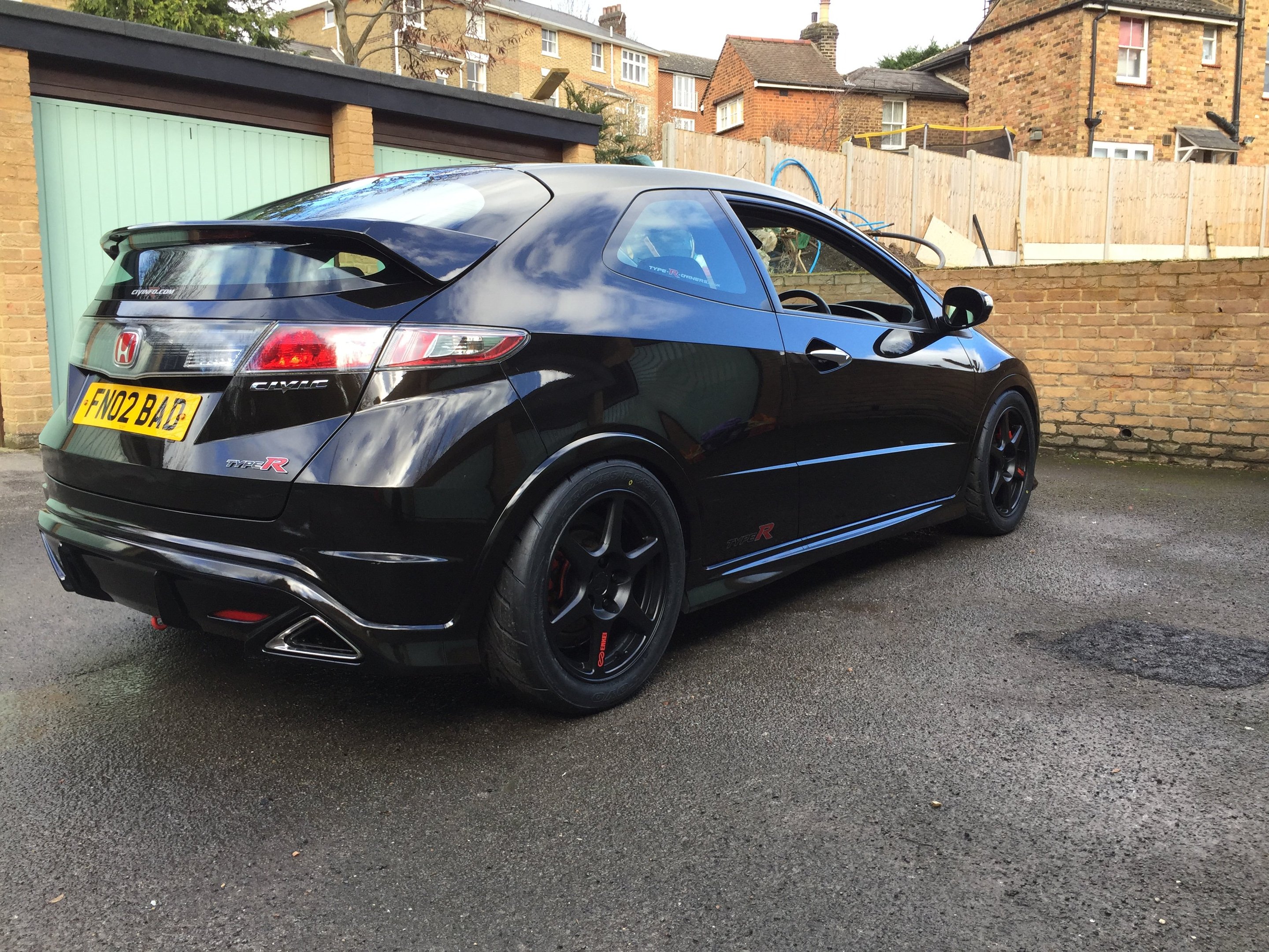

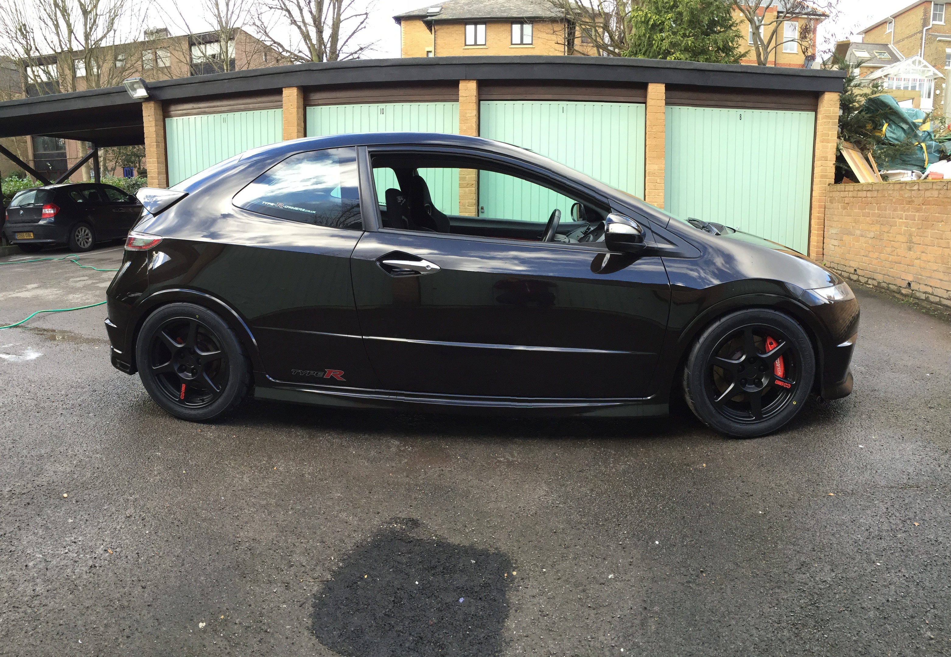

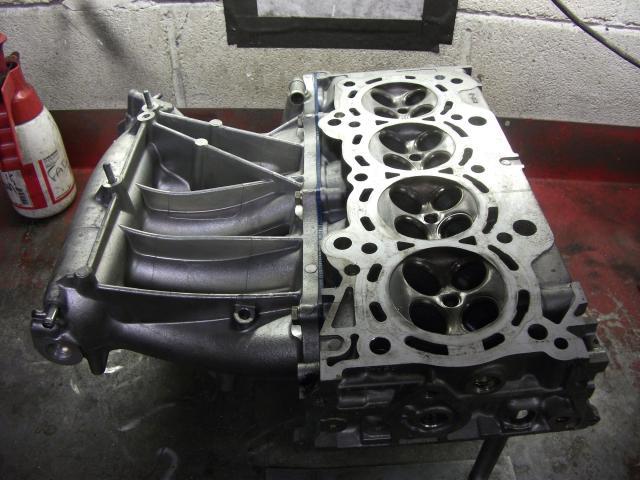

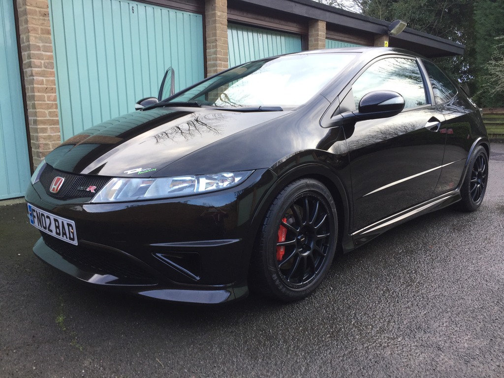

Anyway hers some pictures, a couple of the head work and some of what the car looks like now after a quick wash today.
Thanks for reading
That's had some money chucked at it. Id want to keep that nice myself, not waste iton a track. Bet it flies though.
That looks awesome mate. Thats had quite a lot done to it. I bet it's pretty nippy too
Welcome to the world of Jap.
Well done mate, car looks awesome I bet you're over the moon. [emoji106]
It is pretty quick, but all the money that's been spent on the car has been to turn it in too a weapon on track, just can't wait to try it out properly

looks very nice! what are the sweatbands things for on those reservoirs though?
What cookie and phase1sr said, genuine Mugen ones add loads of scene points :D

Car looks nice OP, don't think I've ever seen a brown one before
The Bronze ones are quite rare I only know of 3 others. Most people bought them in Red, Silver or Black
Mine is red but I did look at the black/brown/bronze colour because in the sun it looks ace.

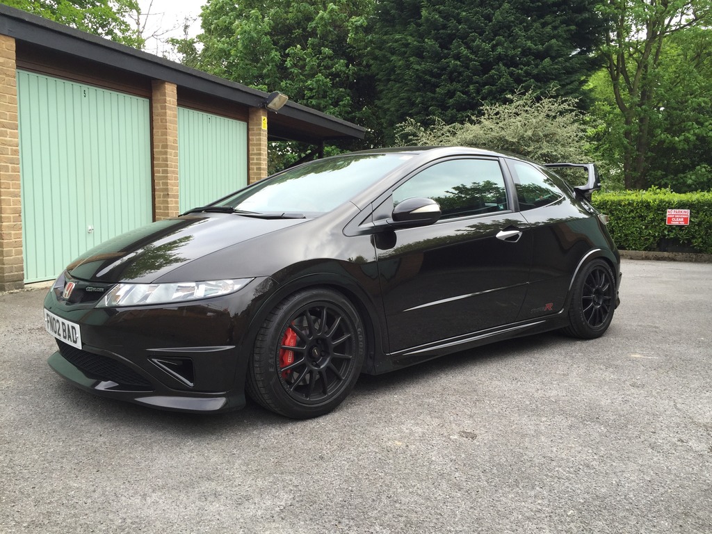

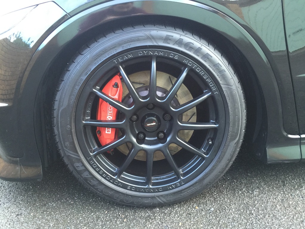

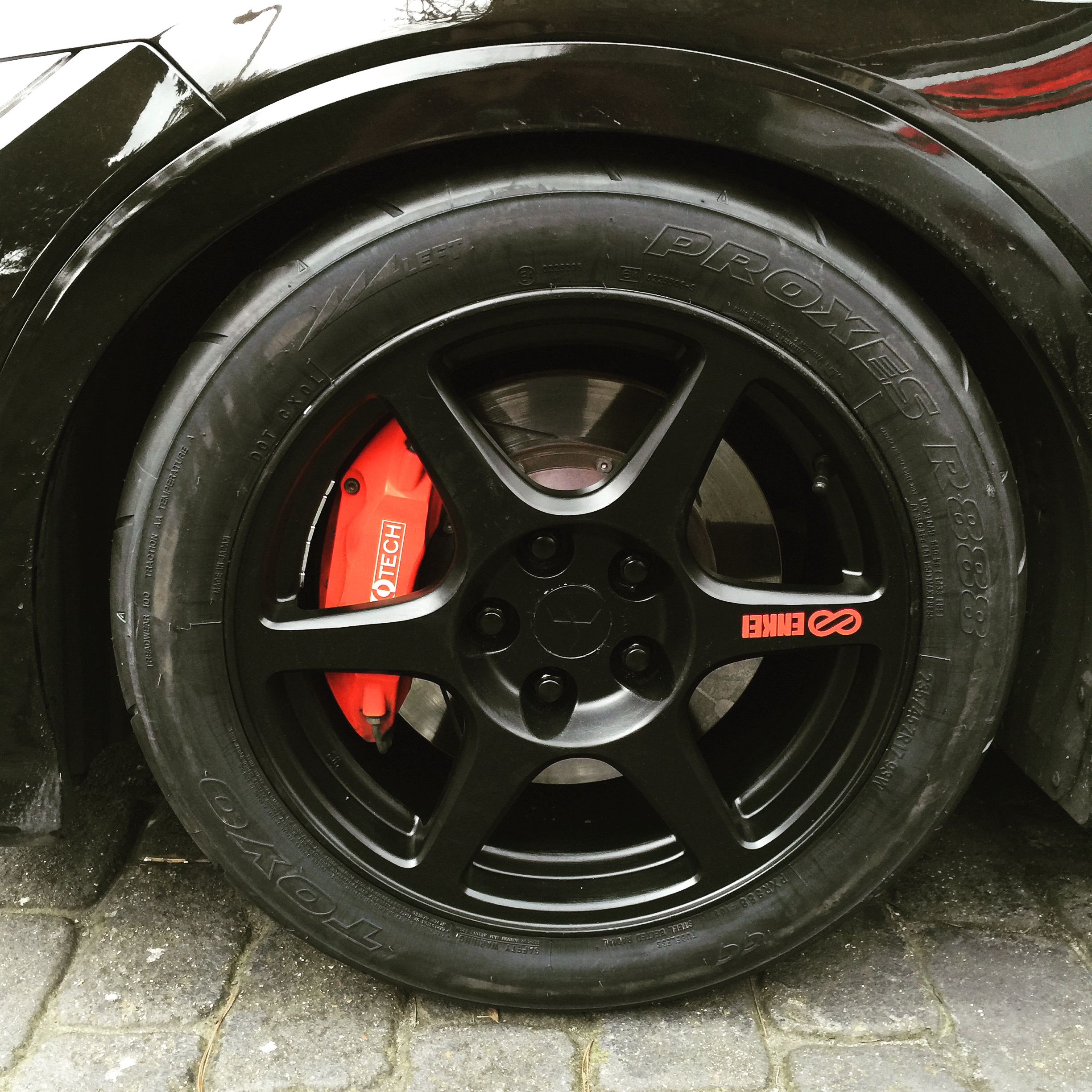

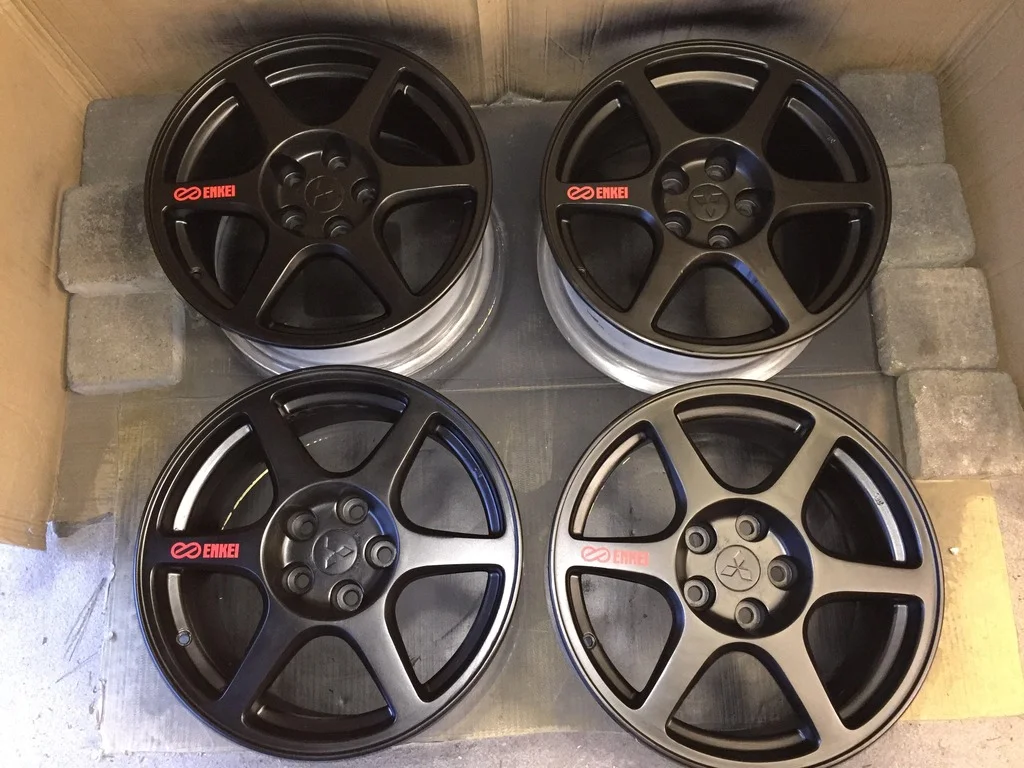

Hate is a bit of a strong word to use. There not my favourite wheels but the arches on the FN2 are quite narrow and with the BBK fitted you need to fit an et40 wheel to clear the brakes. The OEM wheels are et55 and as I don't want to run spacers there aren't many wheels out there that are 17x8 et40 :( The Evo wheels at et38 should just about fit in the arches but et35 would rub to hell.

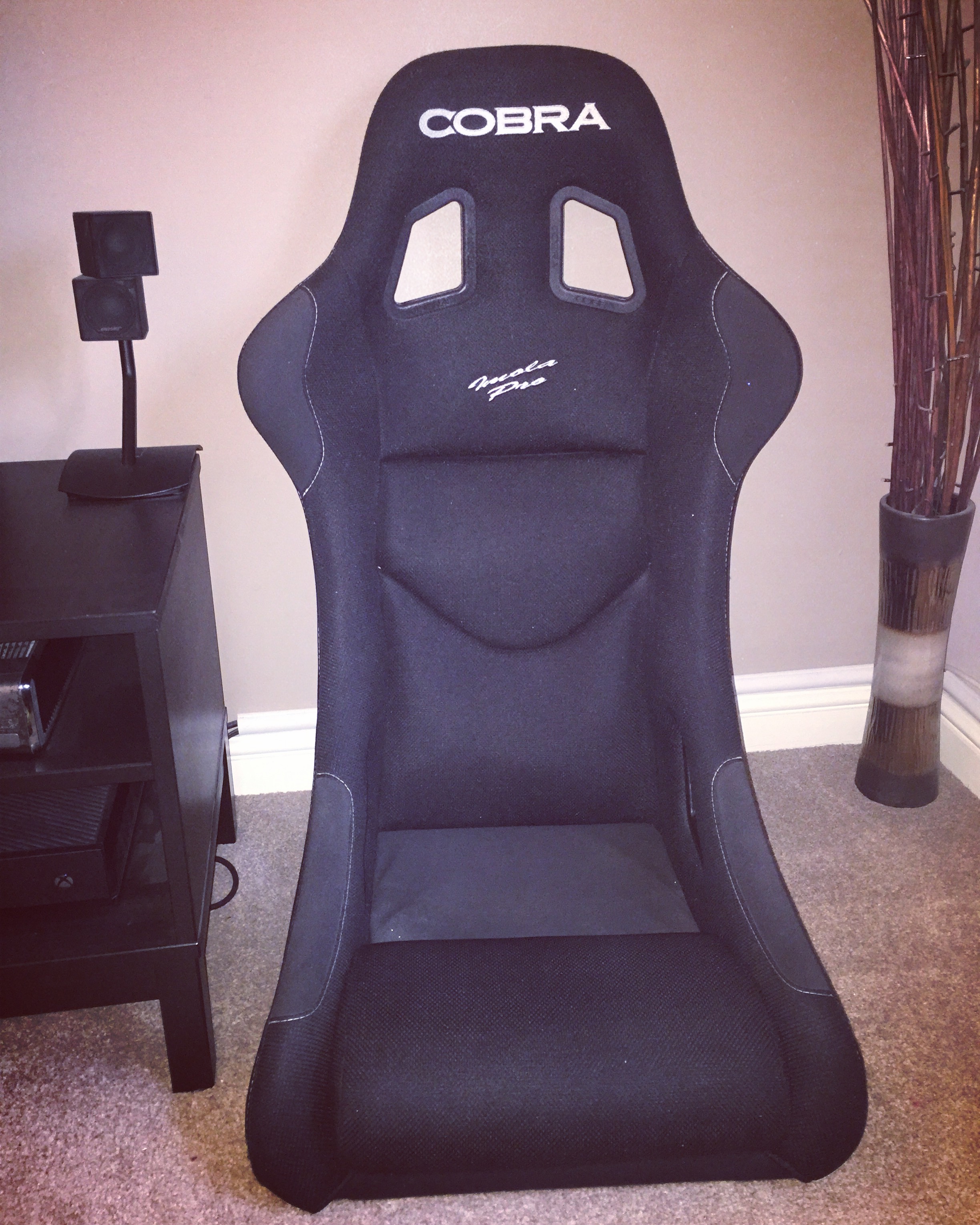

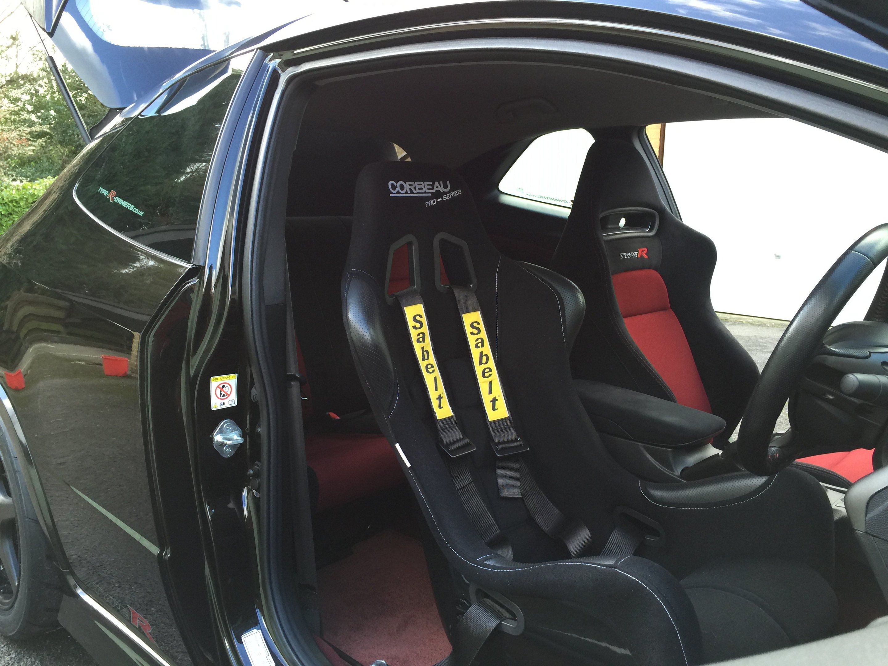

My new cobra Imola seat turned up yesterday, so fingers crossed if the weather is dry on Saturday I'll get a chance to fit this along with some other bits I have.
Now the eagle eyed people will realise it's not a pro fit seat. Although it's brand new it's old stock bought direct from cobra with a tidy discount :up:
Small update
I sold the K-Tuned dipstick I bought and the Cobra Imola seat
Although the dipstick looked really good as it fits the contours of the cam cover I couldn't have it fitted with the RRC inlet cover. Also for some reason the cobra Imola seat was really narrow. Now I'm no fatty (34" waist) but the Imola was way too small for me so this has now been sold and I've refitted my Corbeau Pro Series seat. Still rediculously light compared to OEM and so much more supportive and lower.

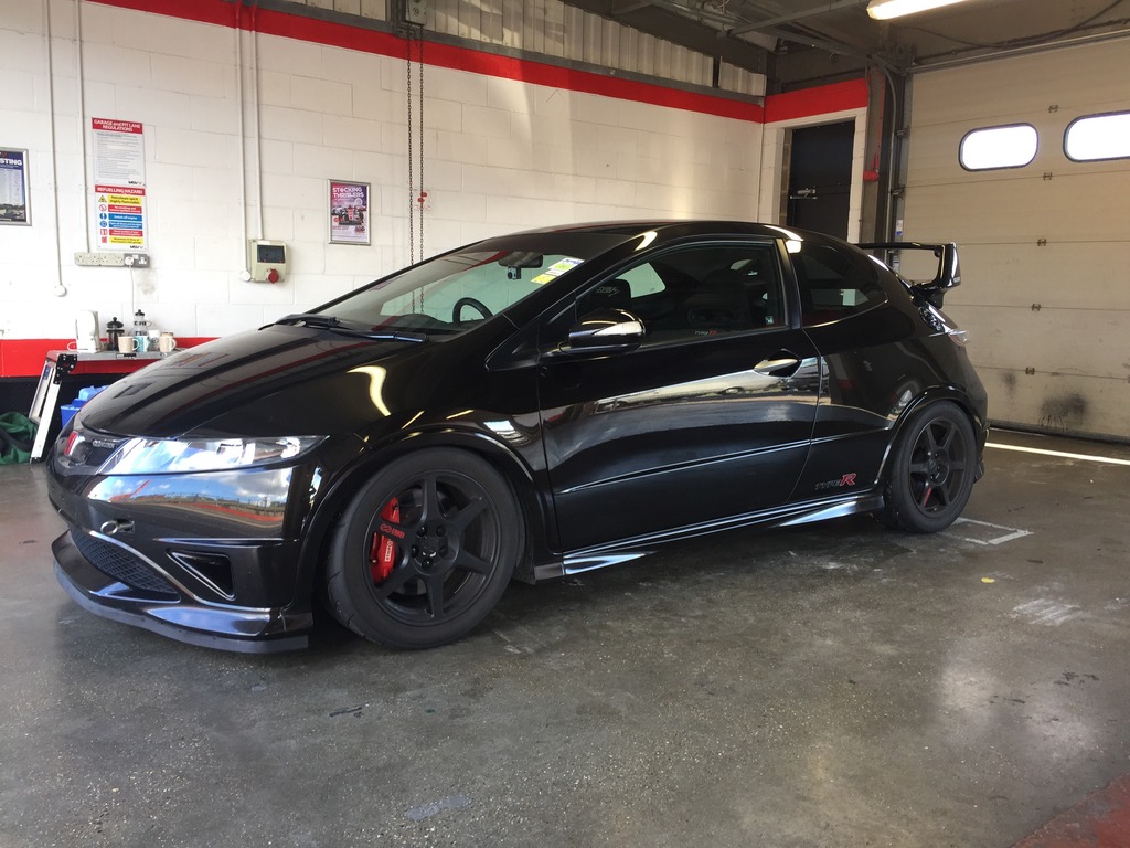

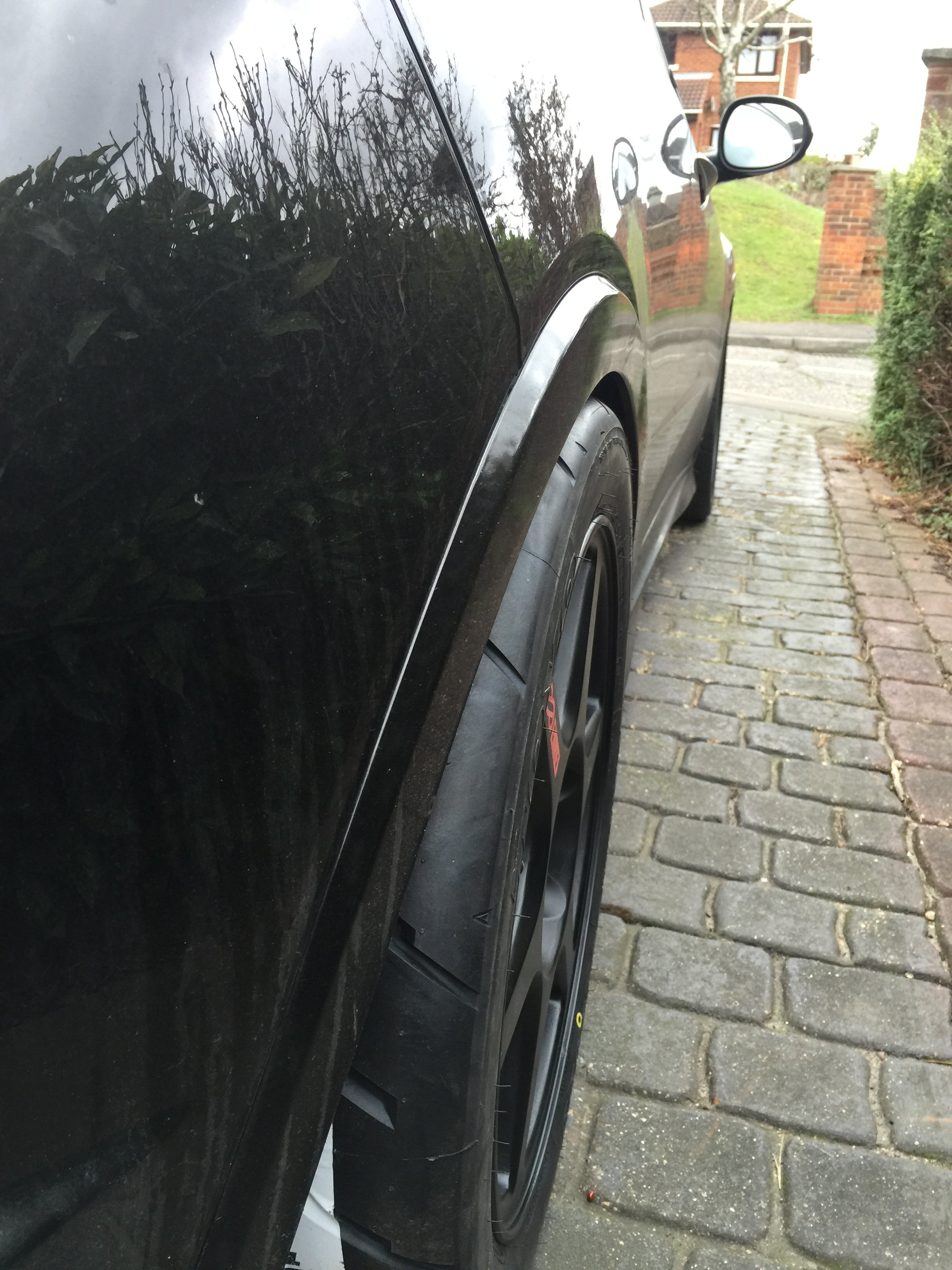

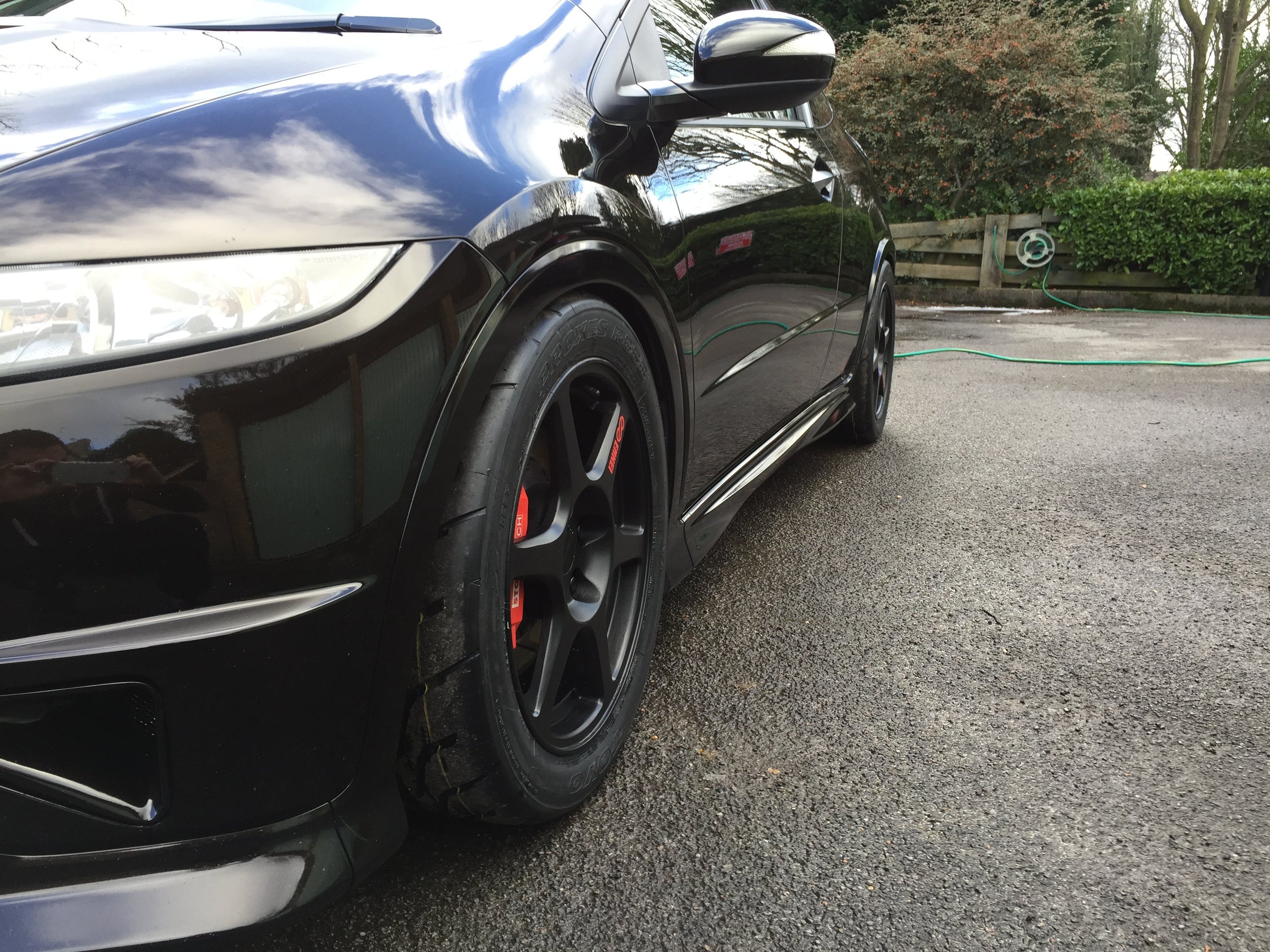

In other news I've also finally got my track tyres fitted to my track wheels
Here's a few pics. Need to get the geo redone as they are mighty tight on the rear arches so need to add a little more camber there.

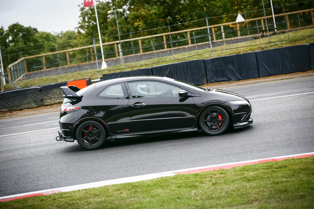

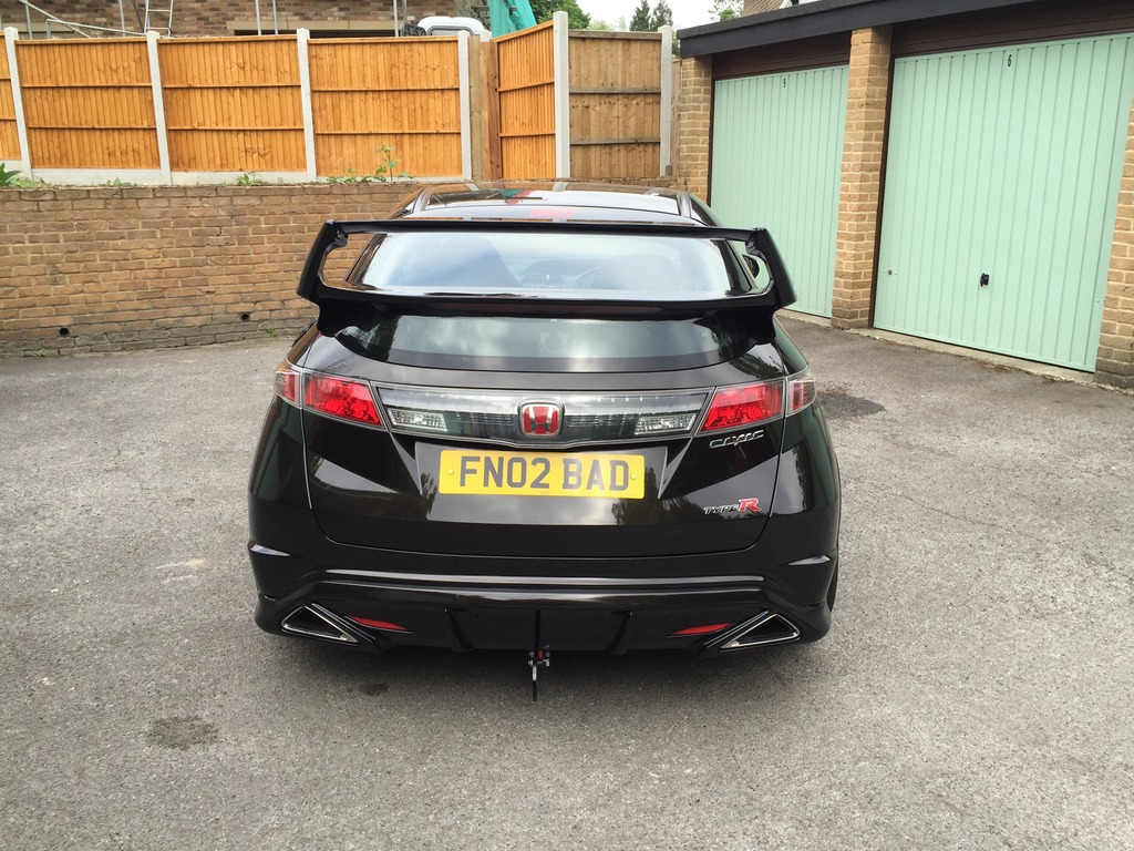

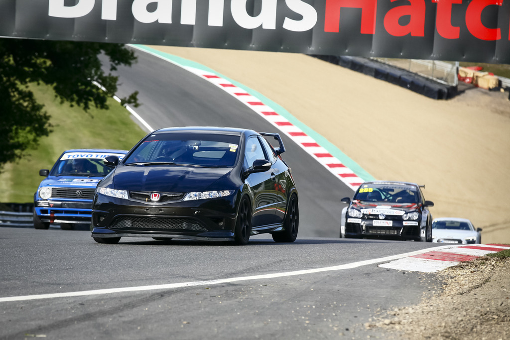

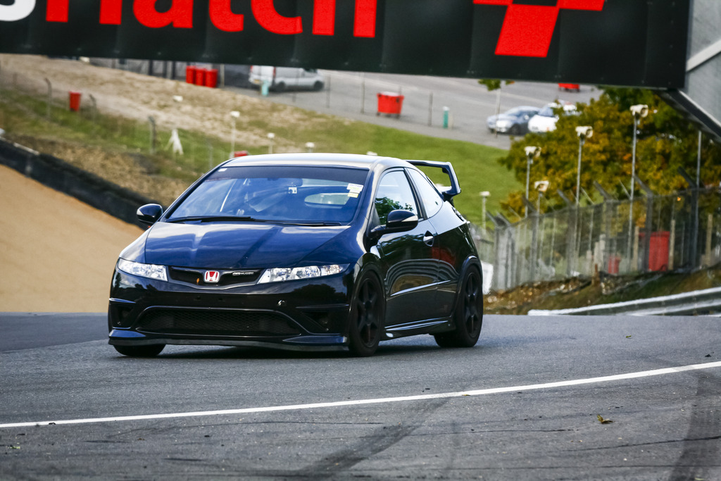

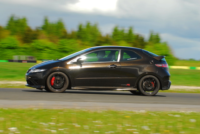

Its been a while since I've updated this so here goes.
I haven't really done any more big mods to the car just been enjoying it on track.
Since my last update I've driven -
Snetterton 300
Blyton Park
Anglesey
Brands Indy
Overall the car is nearly where i want it, i still have a couple of things i want to do to finish it off.

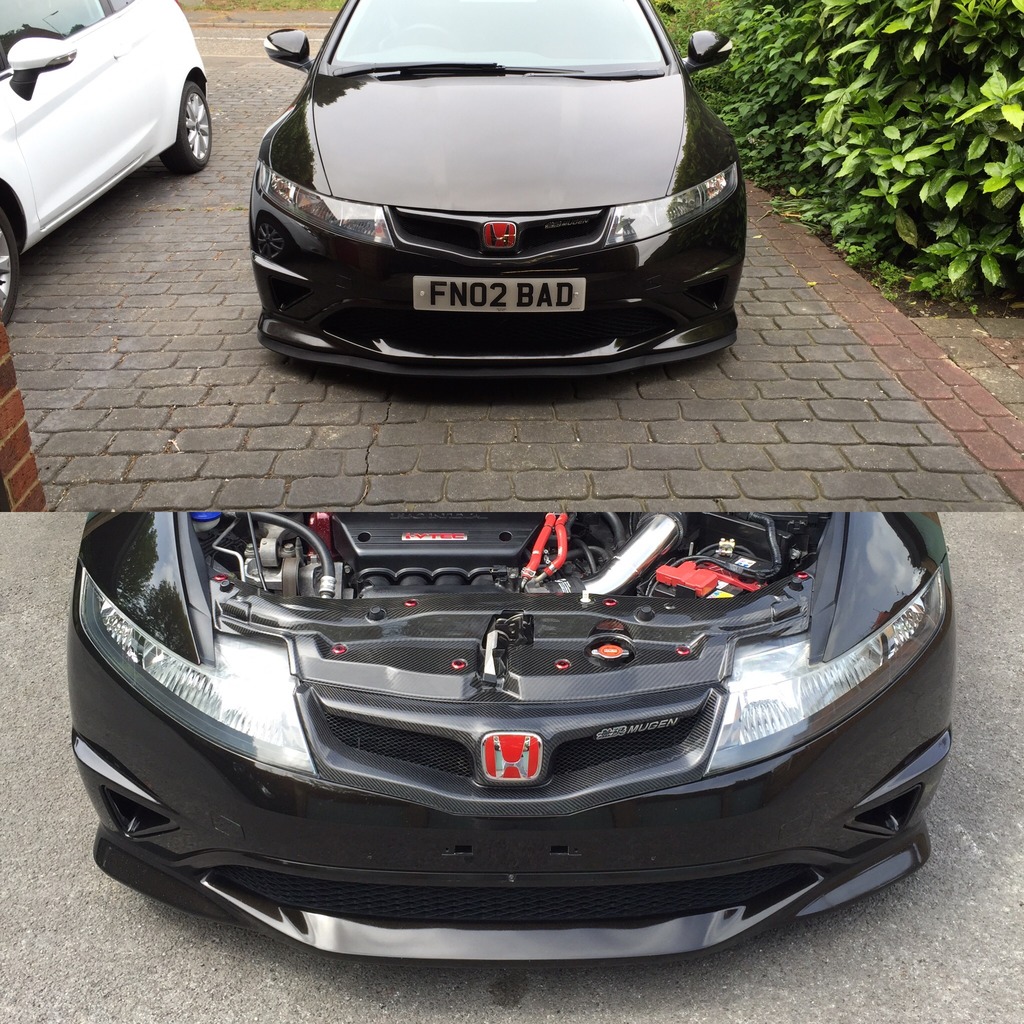

Mugen front bumper
Front end respray
Decat pipe with map to suit
Convert from MAF to MAP
All my videos from my recent track days are on my youtube channel - https://www.youtube.com/channel/UCp9nXW1Xh_kdsLE9wa3myJg

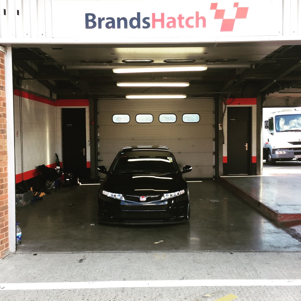

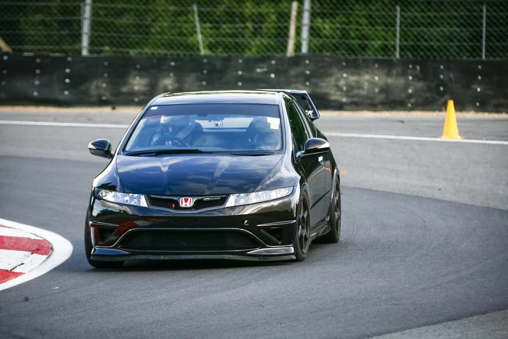

Heres some pictures as well.
