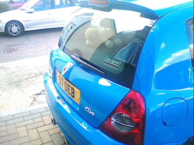

Here's mine after, but the phone qualities a bit crap!
