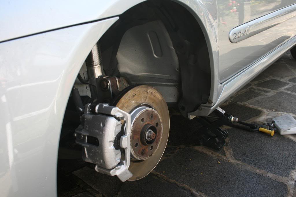

Well after I got over that I tackled the arches -

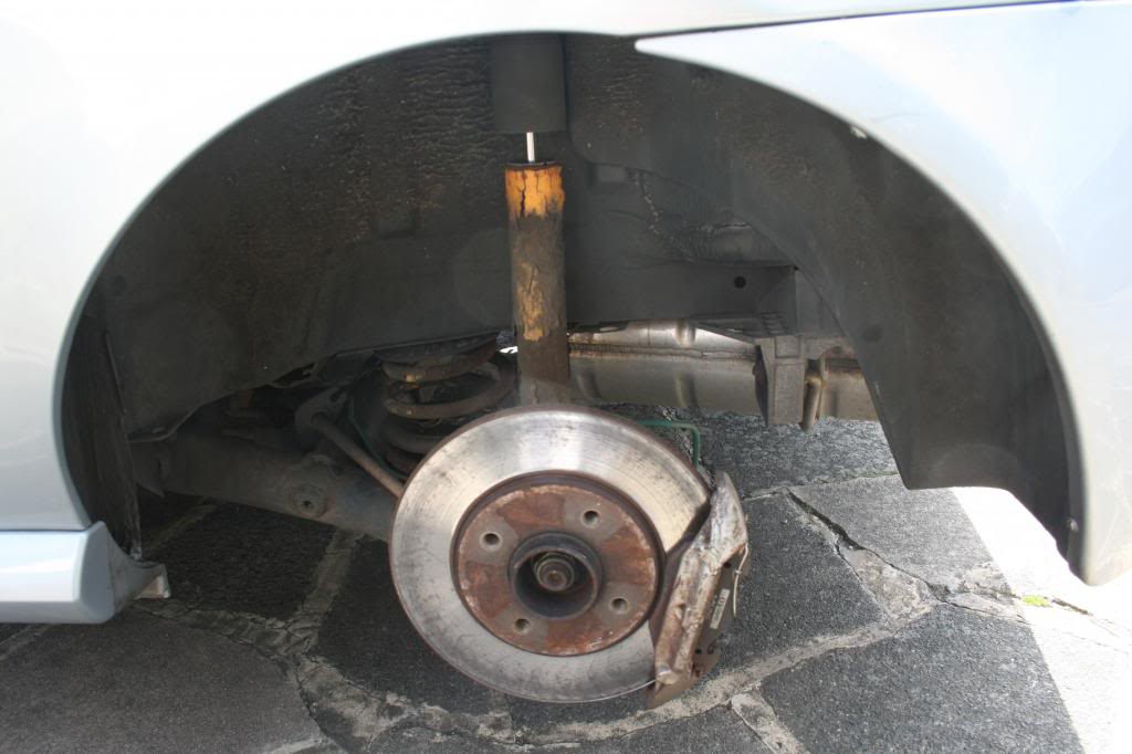

Rear Before:

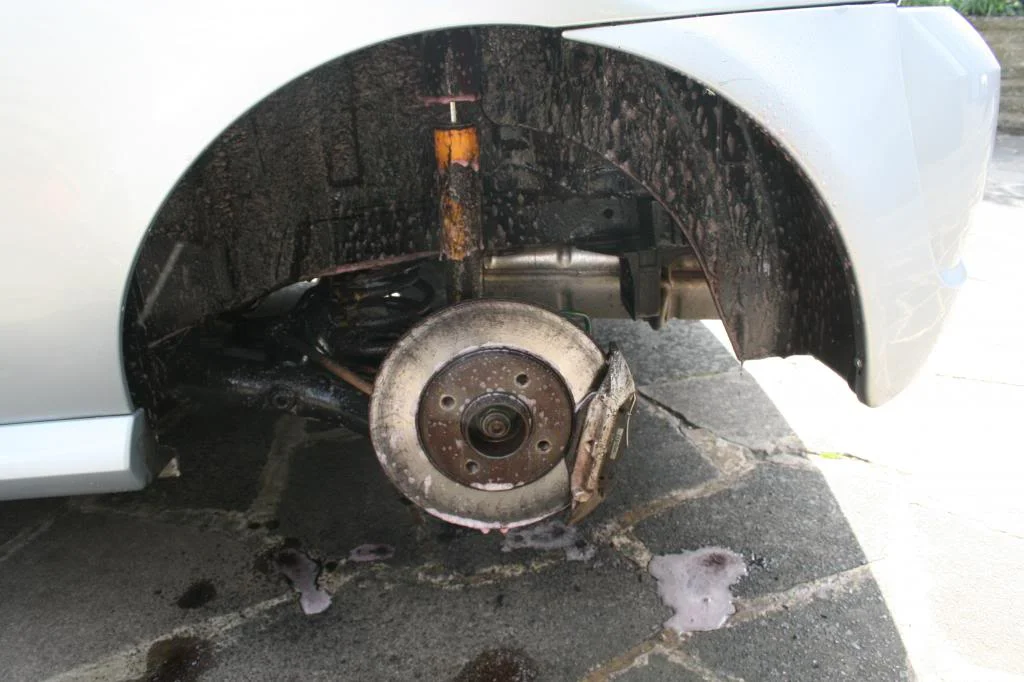

I wasn't surprised how grotty they were, what did surprise me was the amount of 'Soil' that was trapped up against the skirt and up around the top of the turrets.
Tackled it with some Gunk Degreaser, let it dwell, gave it a scrub with a brush then liberally doused the arch with bilberry wheel cleaner before jetting it all off.

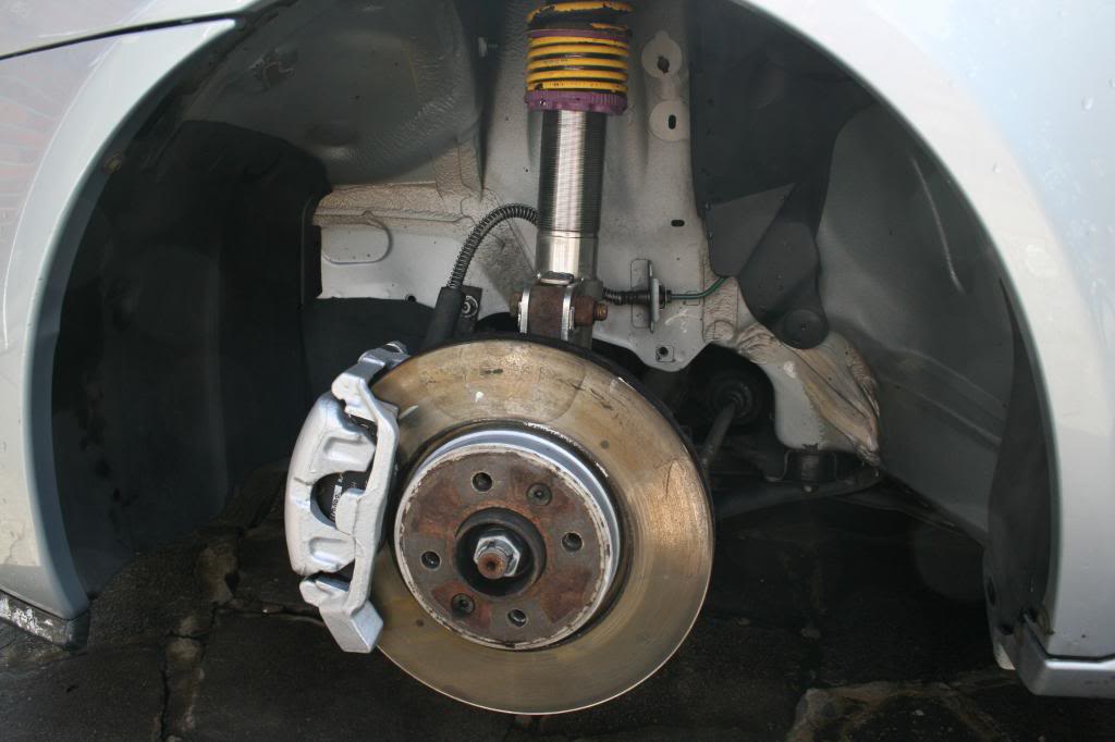

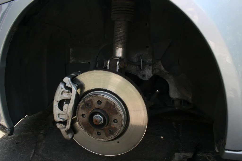

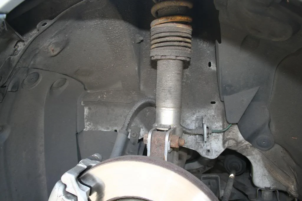

Front After:
Rear before:
Coated with Bilberry for a good soak

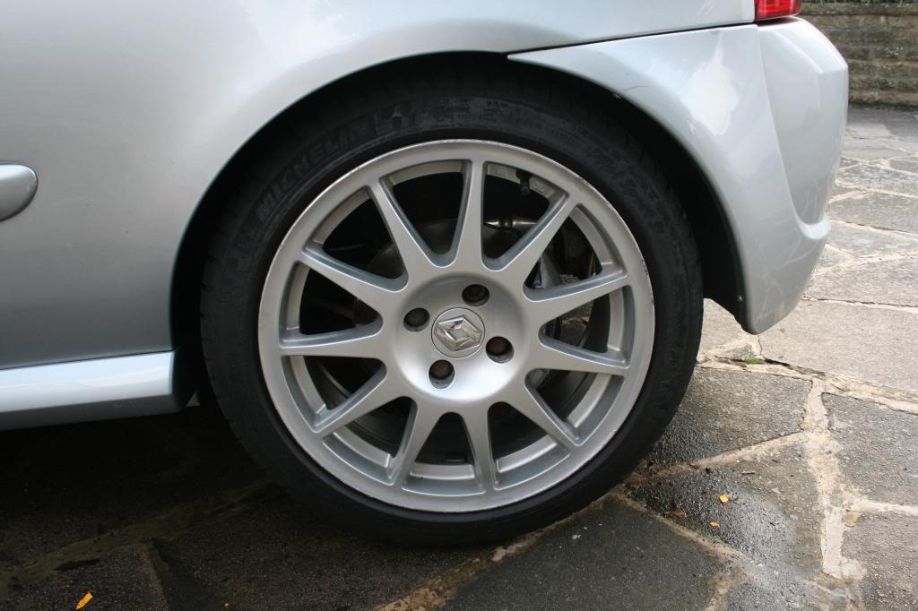

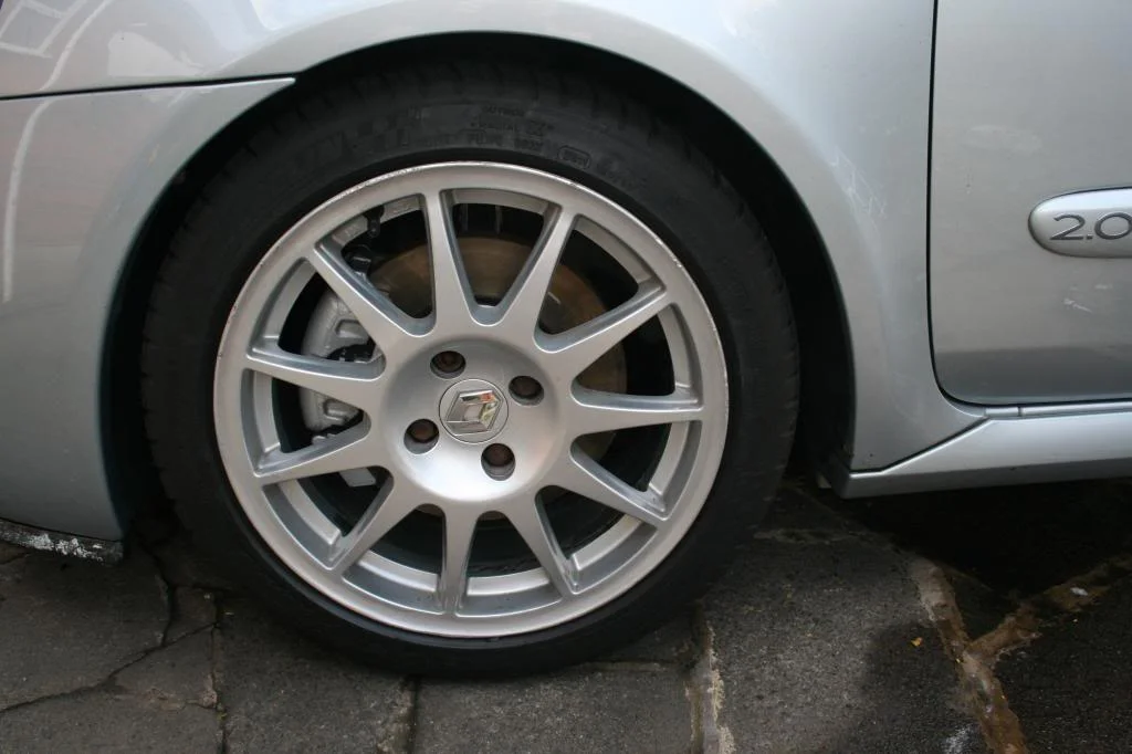

I didn't get an after for the rear so some reason until the wheel was back on:
What I have noted is that:

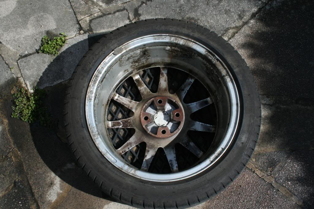

I need a new suspension set up as the rear KW's are very badly corroded (Both Springs and Shocks) and my Turini's are desperately in need of a refurb as they are very corroded inside the wheels -

Was a worthwhile task though as the soil removed was all very damp and underneath some of the seams were starting to show signs of corrosion.
There was a tonne of 'soil' around the fuel filler in the drivers rear arch, a good mug fulls worth.

J -- Car is looking good, coilovers came up a treat, I take it the bodies have the inox coating on them? I had my old coilovers on one of my 1*2's re-powdercoated, looked a million times better and you can choose what colours to go for :)

Thanks, I would say its worth doing... You know in the rear arch where the skirt meets the arch, there is a little 'well' created where the seams meet.
This was full of damp 'soil' and when cleaned away was showing signs of corrosion I suspect due to the build up of dirt and retaining the damp.

Yes, inox on the front units, the rear KW's are just powder coated / painted which has all corroded off.
The coilovers are tired though, they were originally on Bens old Throttle bodied PH1 and have been on my car for nearly 5 years now!
I toyed with the idea of a rebuild and discussed with KW, the rears were something like £120 each and I don't recall how much the fronts were but you are looking at the best part of £600ish which is 50% of the cost of new.
