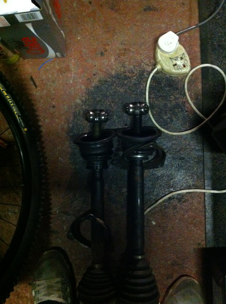

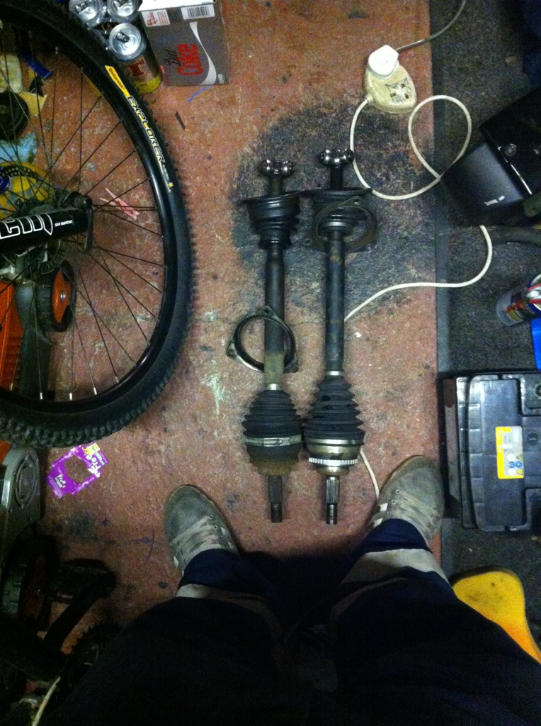

I think I've solved the problem. The driveshafts were too long believe it or not lol. Only just finished fitting standard ones so will see if the noise is gone in the morning.
Fingers crossed :)
It's official......cars sorted :) the shafts were too long. Here's a pic of the passenger side
As you can see just a little longer lol
