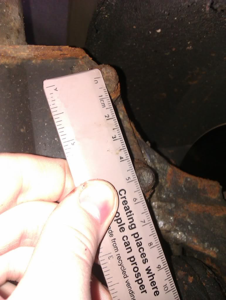

seems about right, you should measure your bolt spacing to make sure though :)
turn your steering wheel full lock left, then on your drivers side put your head under the car at the bottom of the shock connected to the hubs you should see 2 bolts, measure between the centre of each bolt :)
Well I checked the spacing, the gap was a little smaller than I thought from looking at your photo, but I go a ruler in there okay and measured it to be 58mm :)

aha yeah it is quite awkward to get a ruler in there, but its do-able ;)
