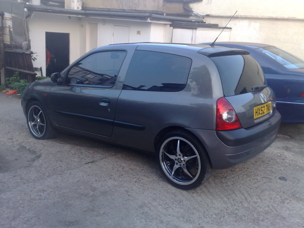

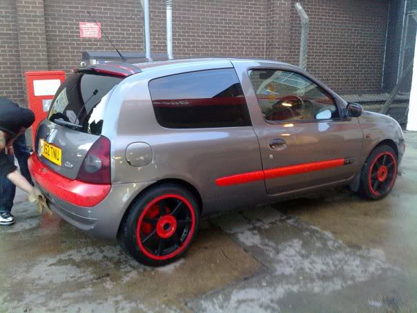

hello everyone, i have owned a clio 1.4 16v for a bout a year and a half its all nice apart from a warning light on the right bottom corner which looks like a engine light only happened last night maybe to do with a sensor or something and i would like people to give any ideas about what to do next for example lowering it? and i have tried to put the arches in but it still rubs the arch when I fit 4-5 People in the car.. but anyway here is how the car was before and how it is atm.

love the colour of the car but not a fan of the red :( should of left the rear lights alone would of gone with the red
  B/G 182 + PH1 Track
Agreed, you ruined that.
Could be a really nice car, the base colour is real nice.
But WTF were you thinking.

hmm thanks for the replies i know i shoulda kept it original bumpers but reds my favourite colour and anybody recons 60mm lowered would suit it? and isit okay using springs or would be worth spendin more money on the udjustable lowerin ones.. alperin

thanks for the ideas mate but i wanted to just get simple tuning and maybe if i do more red bits it may colour match because i really want red and grey im thinking red mirrors and renault badges and few other bits but im more worreid about lowering the car what mm would suit it and what i could do to stop the arches rubbing the tyres. thanks alperin

It's rubbing because by the looks of it your wheels are the wrong offset? they shouldn't sit like that (without spacers) you want the wheels to be about 5mm sunk into the arches to avoid rubbing when lowering. Mines lowered 60mm on standard shocks, and it's OK, rides not great, and not sure how long the shocks will last, but it could be alot worse.
Oh and I'd seriously consider putting any more red on it, the two colours dont go at all imho.

its not just your tyres bud, its the actual alloys them self, they need to be either slimmer (so if they are 8"wide now go to 7") and also "the offset" needs to be either smaller or bigger.
eg.
A smaller offset will make the wheels stickout.
A bigger offset will make the wheels go deeper into the arch (not really what you want)
You want something that is about 7" wide with an offset(et) of 28 or there abouts. This is what i have an my cars Low

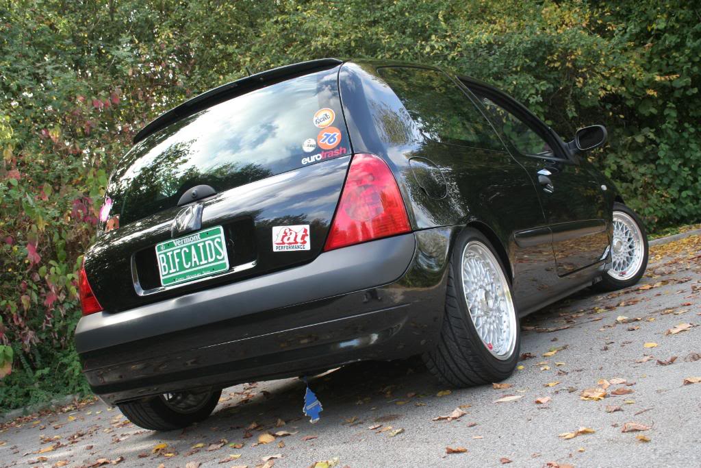

dont like whoring my car bud heres an example:
the wheels are 15" x 7" et28 with 195/45/15 tyres. i also have 10mm spacers(each side) and a tad bit of negative camber due to the fact i have 1mm clearance from the lip of the arch to my tyre without camber. Also the cars the lowest it will go on the back and the front is ruffly 80mm.
