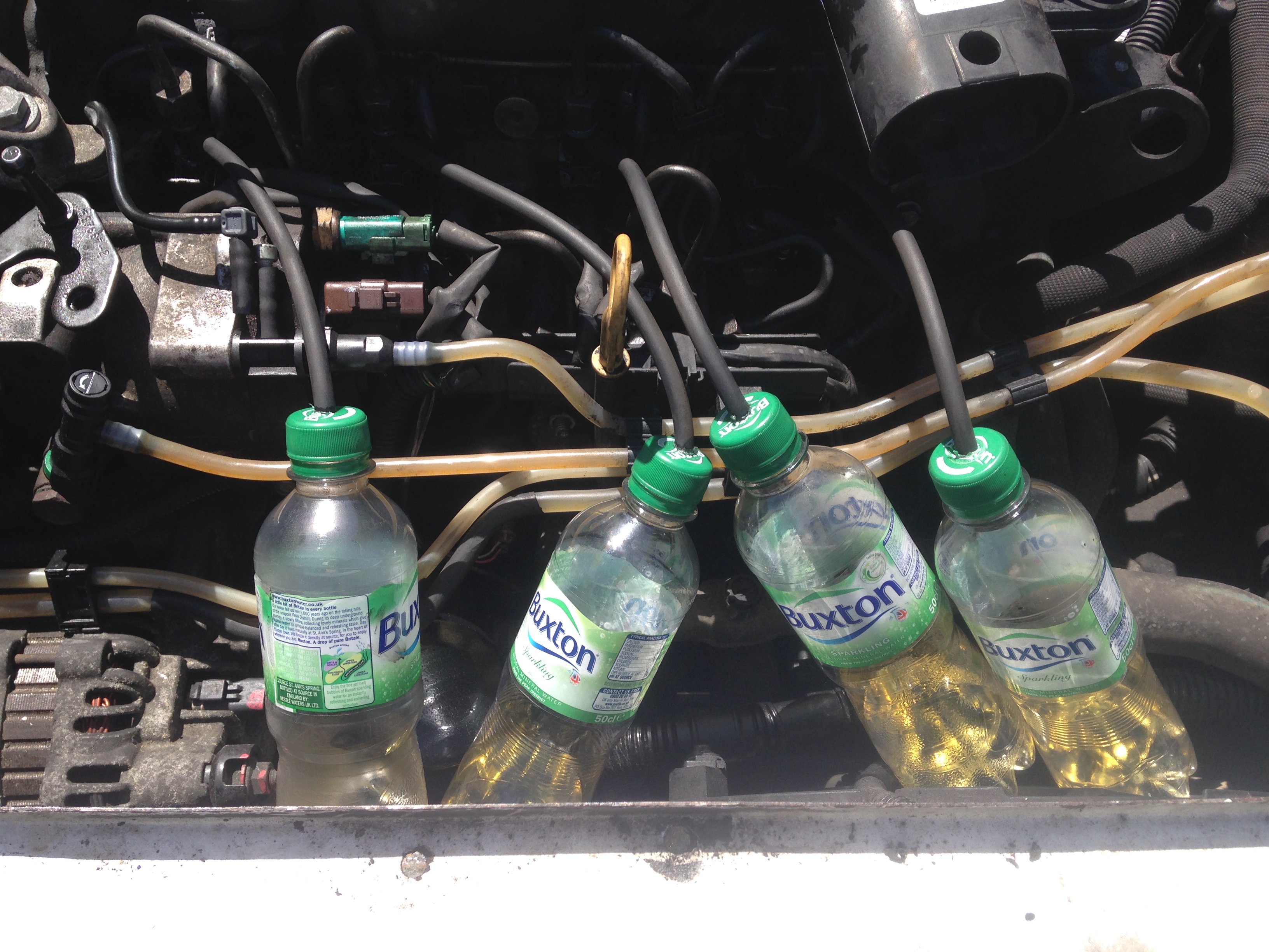

I've done an injector drip test and they're all dripping he same amount, and not a constant flow.
Is that a valid test?

I think you're refering to a leak down test. After a minute of running you should get very little in the bottle. These injectors are busted

Yes mate, there is very little, I have cleaned the housing for the egr which the hole size was about the same as a 5 pence piece, now it is about 20 times that, there is a whistling when I rev to about 2k rpm so I have removed the turbo and there is some play in one side of the fan bearings (the intake side) I'm guessing its time for a new turbo
