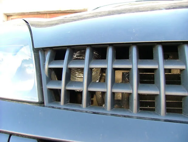

Garrett GT1749V (vnt15) turbocharger from Bmw 320d

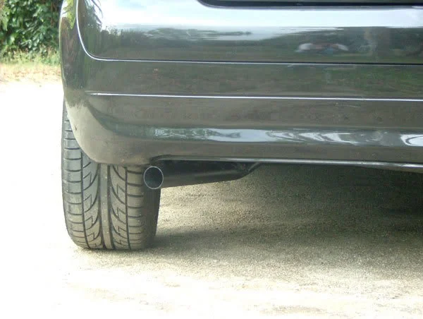

Straight Custom Exhaust Pipe with 55mm

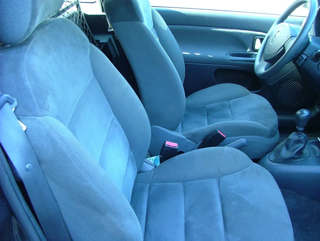

Audi A3 Alcantara Seats (I'm looking for 172/182 seats, please ring a bell...)

is the bmw turbo direct fit or does it need modification ? what kind of boost can it make ?
It's not direct fit.
To fit this turbo you have two options:
1st) Soldering... turbo on exhaust manifold (like some VAG's TDI)
2nd) Build a phalanx (i don't know if this is the right word in english) to join both turbo's and exhaust manifold's face
With the bmw turbo there's no room for kat and in my case i also have removed the EGR.
