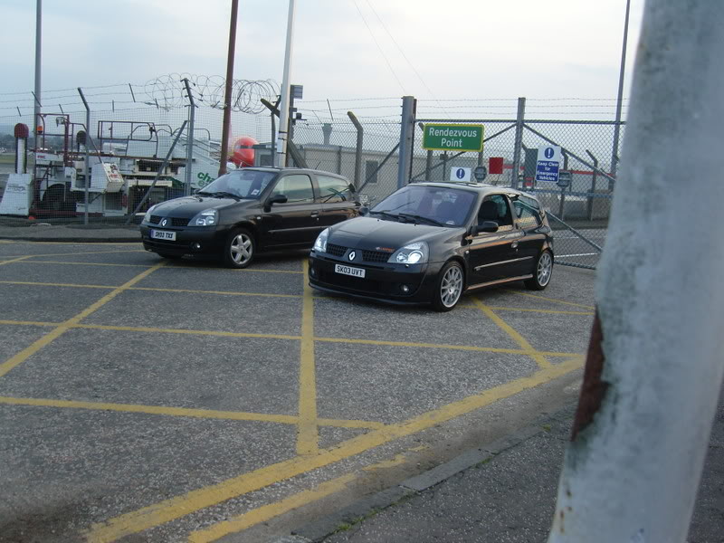

you will need new front wings front bumper rear bumper and side skirts, and xenons if you want to go all the way
Here's what it should look like once i get it
looks nice:) non sports have a sun roof, but the sports dont have as sun roof so thats the only way you will tell its not a sport

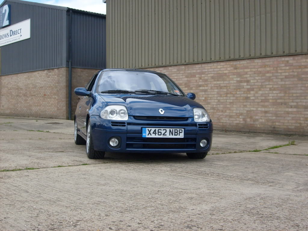

another dci rep :)
well........mines isnt quite a rep, sort of stole other RS bits and left dome dynamique bits on :D
RS grill £42
Colourcoded strips, handles bumpers and spoilers £160
182 wheels with 7mm tread on tyres £360ish
interior from Andy @ GDIs 182 £300 ish
RS door cards from fleabay £40
bosch aerotwins £30
clear repeaters £8
................£35 tax per year................... £ priceless lol
and thats were ive left it now
love this pic of it
have fun repping ;)
