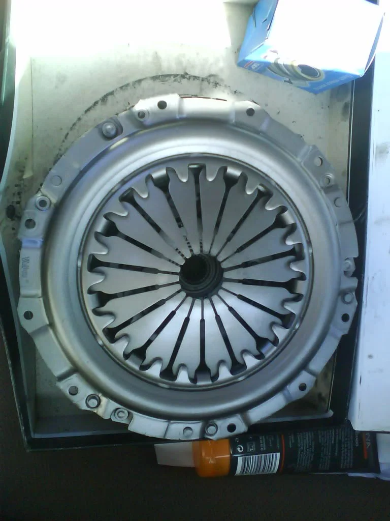

That's it,

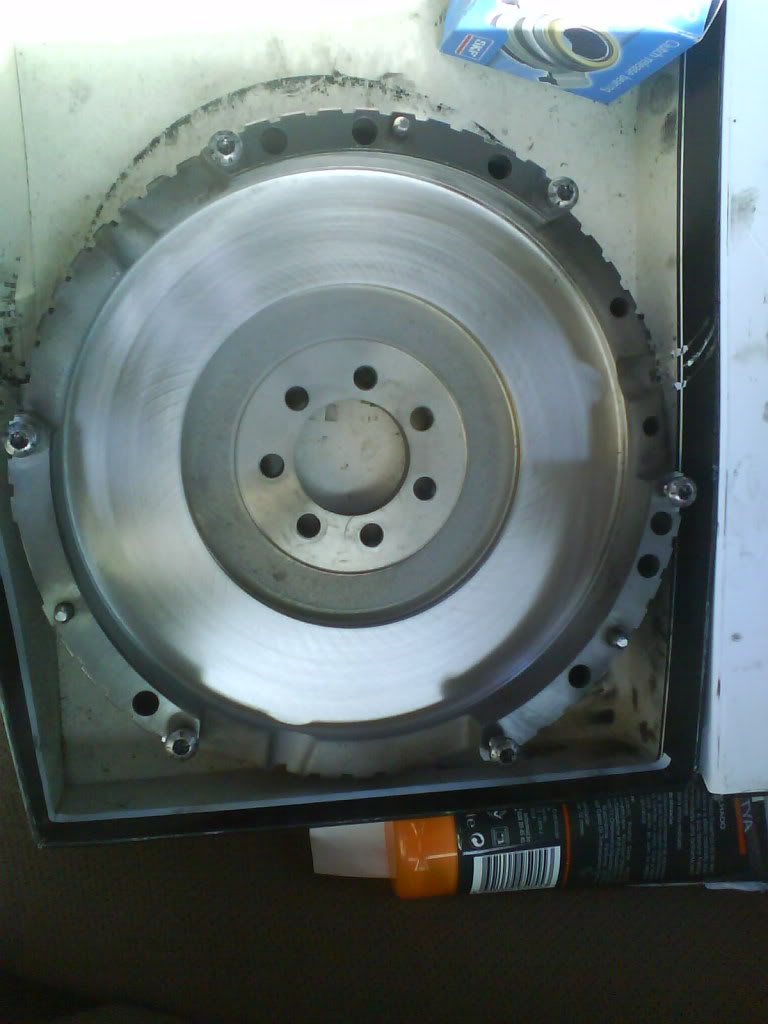

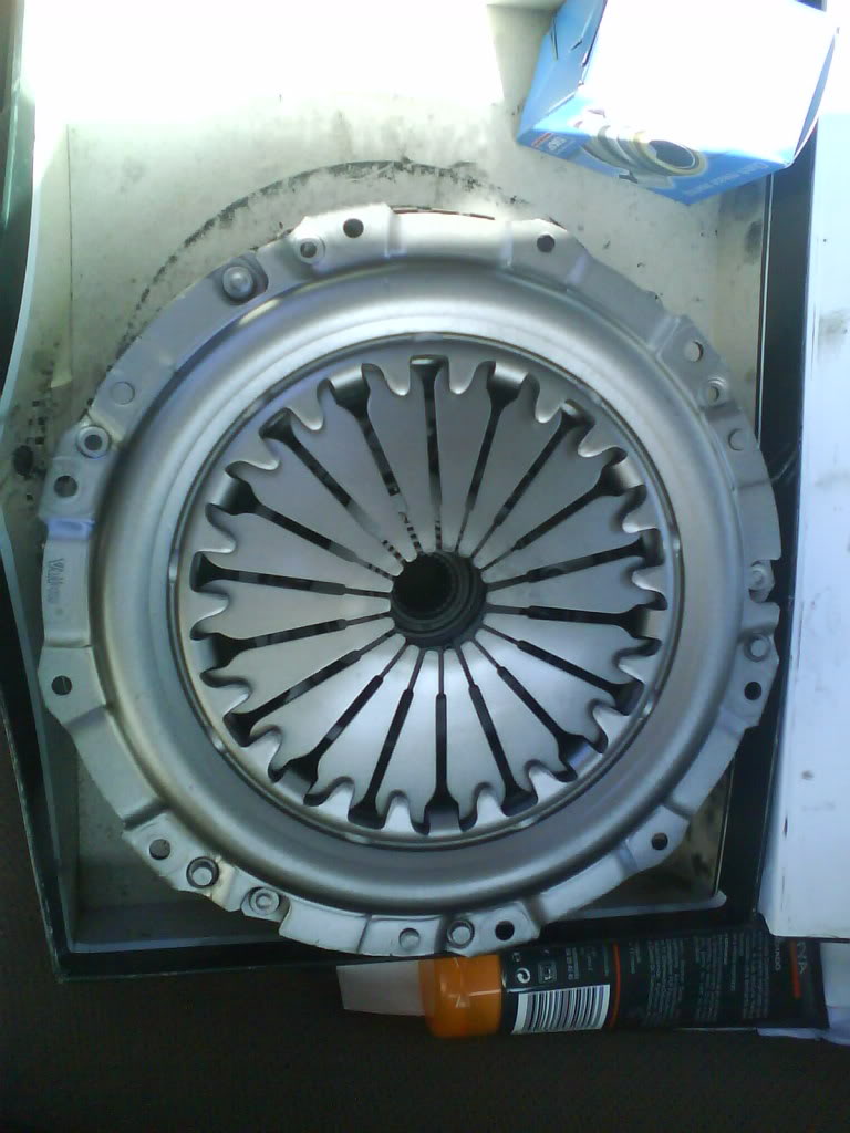

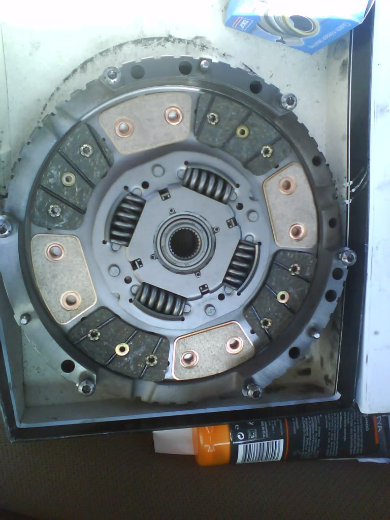

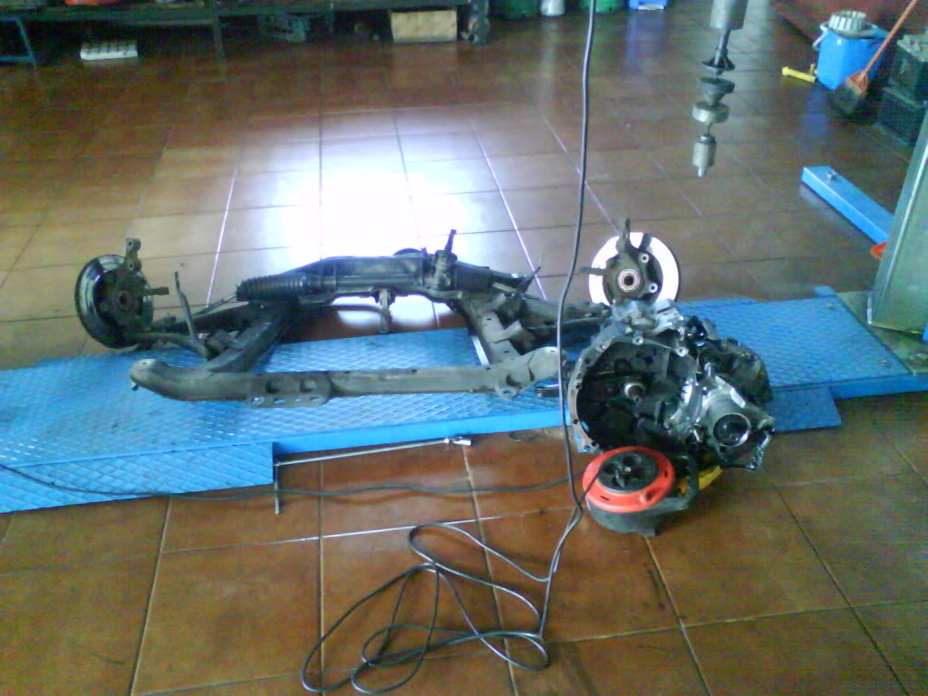

Upgrading the clutch
Photos from the uprated clutch
Disc with Ferodo and Copper
Fly-wheel:

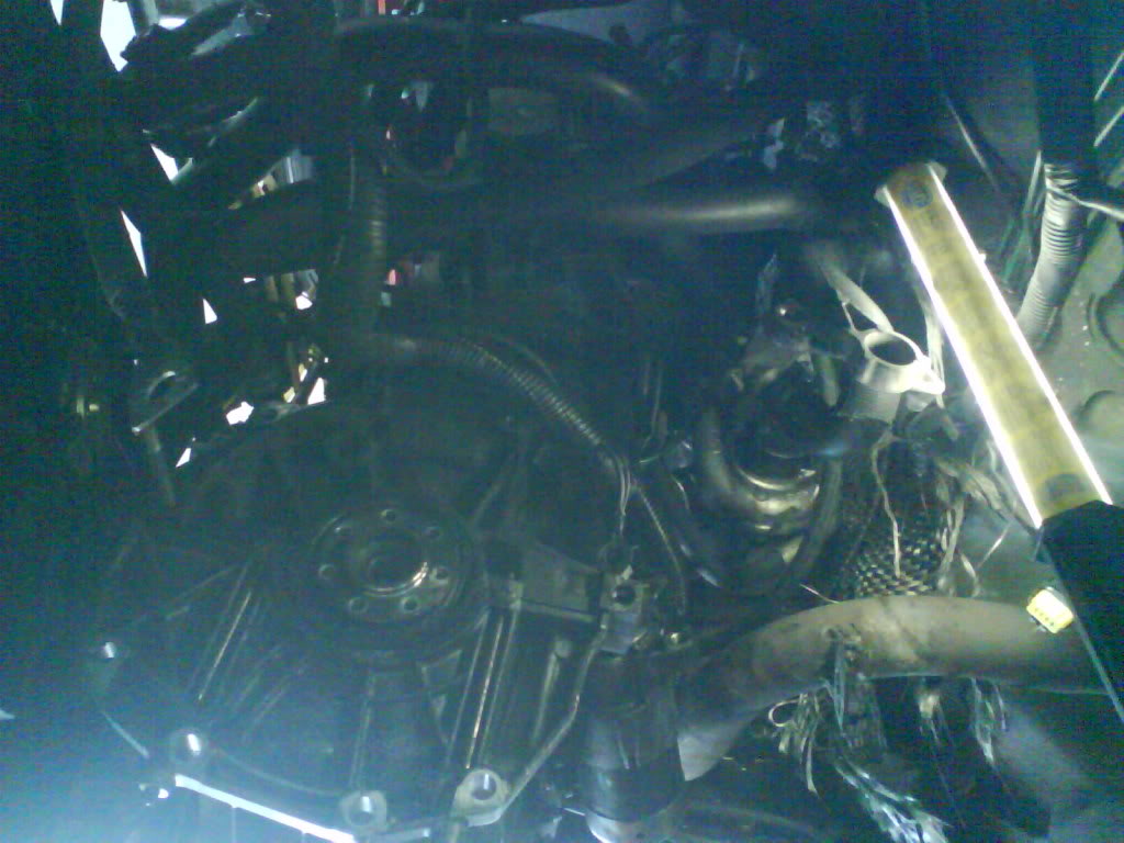

The car will only be ready to roll tomorrow evening, and i'm dying till then to try the new clutch.
Photo from below the engine bay:

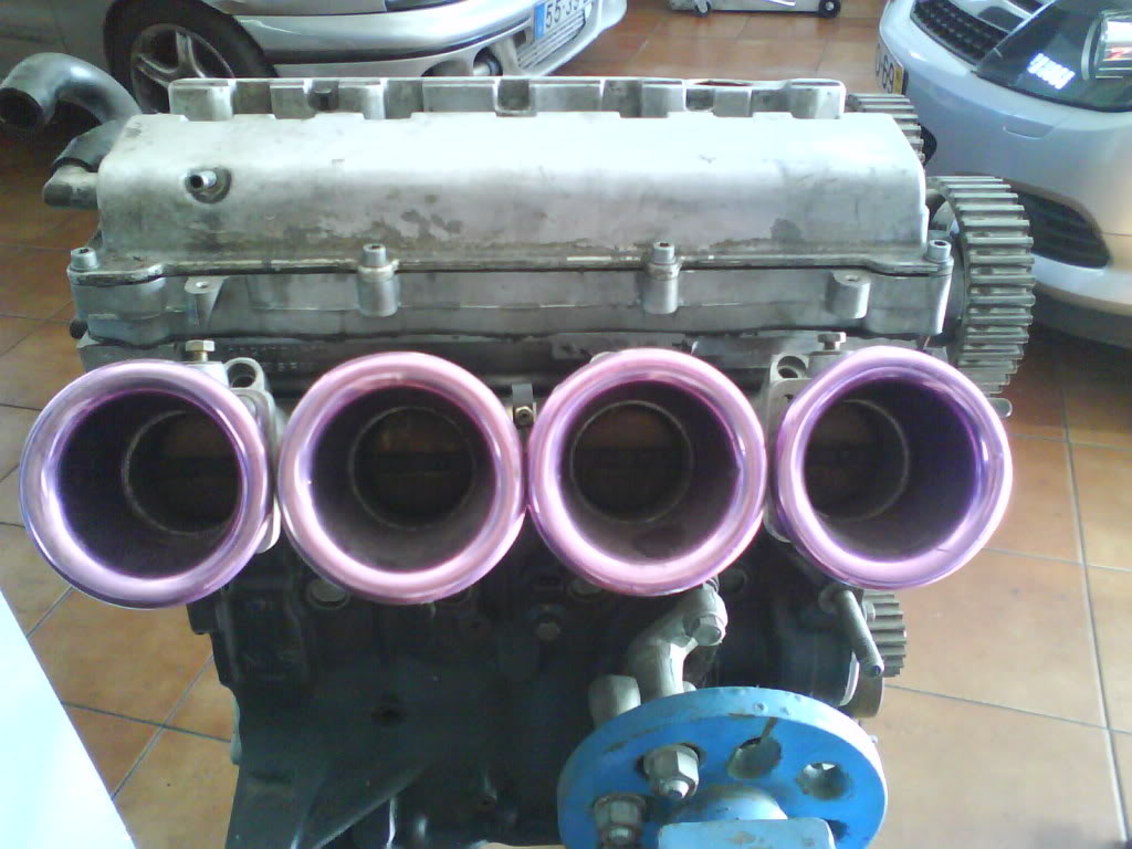

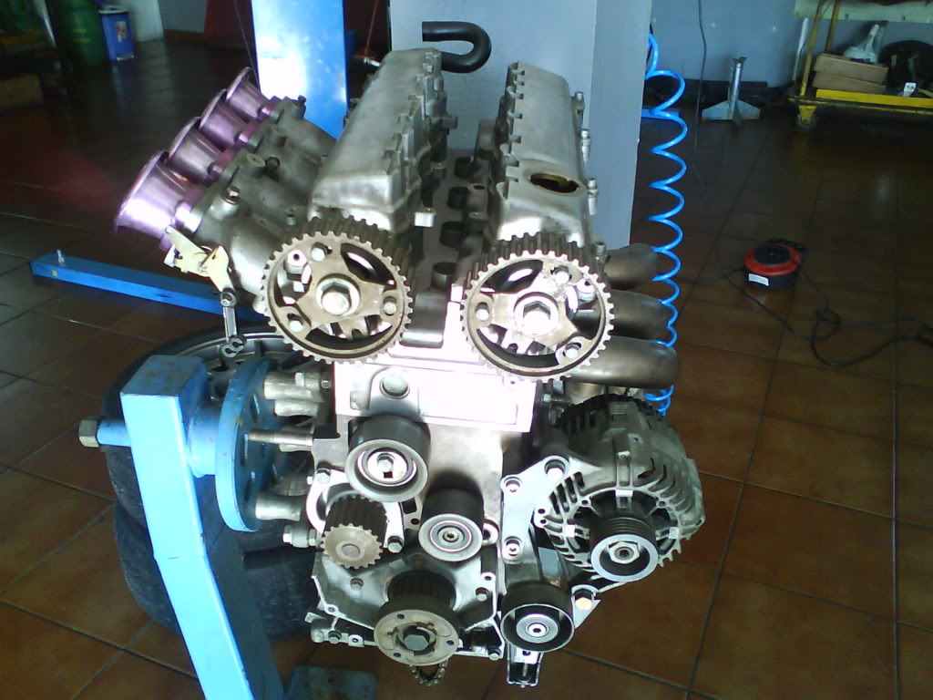

And an little off-topic that looks interesting. The guy that's working my car is preparing a saxo kit-car engine to run in a C2 shell, some photos:
ITB's power:

AWESOME!!! who rebuilt the clutch? and how much it costing you?
Hi Martin,
well i went to a clutch shop that do this king of jobs and for competition cars/trucks.
Yesterday i arrived there (clutch shop) about 9am, went shopping with my wife for about 6 hours and it was the time it took to get ready.
Cost: about 160£
Later today i will pick up my car and test it. Then i will give my feedback about it.
Cya,
./magnastik

Well,
clutch in place and the car looks more agressive switching gears.
And the first problem i had, broken engine/clutch support (too much torque) :)

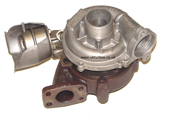

Got these things this week:
And a new turbo, an hybrid GT1544v from the 1.6 HDI PSA engines, but with upgrade intake and exhaust turbines.
like this in the outside:
I'm waiting for a new garrett actuator and new custom injector nozzles.
I'll be posting news.

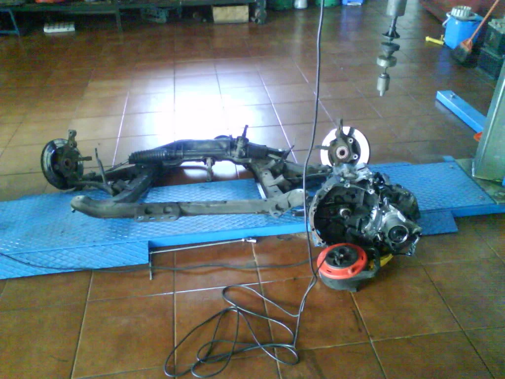

Well, can you find the diferences?
Yes... Clio RS Trophy front callipers and disks, and Clio 172 complete rear axle.
Cya,
magnastik
How easy was it to fit the rear axle? :)
The hardware is plug&play.
But to manage to get ABS work properly we need to change the rear ABS tooth crown.
The drums abs crown has different tooth number and in that way the abs will calculate different wheel turns, so the ABS will be deactivated.
To solve this issue just buy to ABS crown like the Clio 172/182 front ones and put them on the rear.
Ahhh... now power breaking is a lot better.

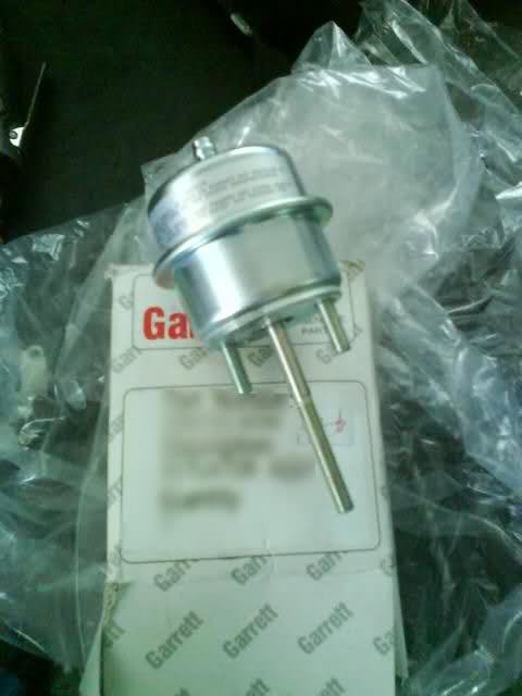

Well,

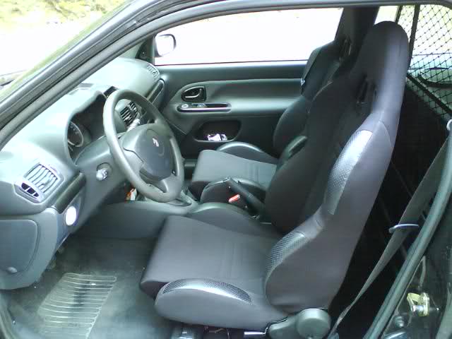

if we stop we die, so, as i will install a new turbo, i went shopping:
Garrett Actuator calibrated to 1.4bar of boost:
Better pics from front Clio Trophy Calippers and Discs and rear Clio 172/182 Discs:
Custom front grill

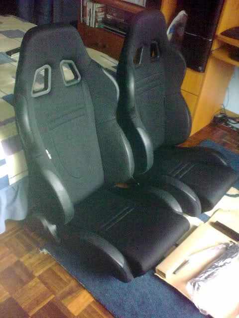

Sports Seats

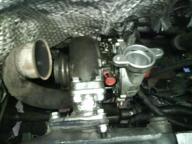

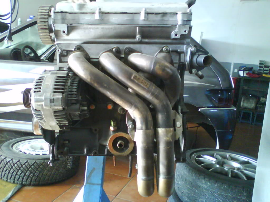

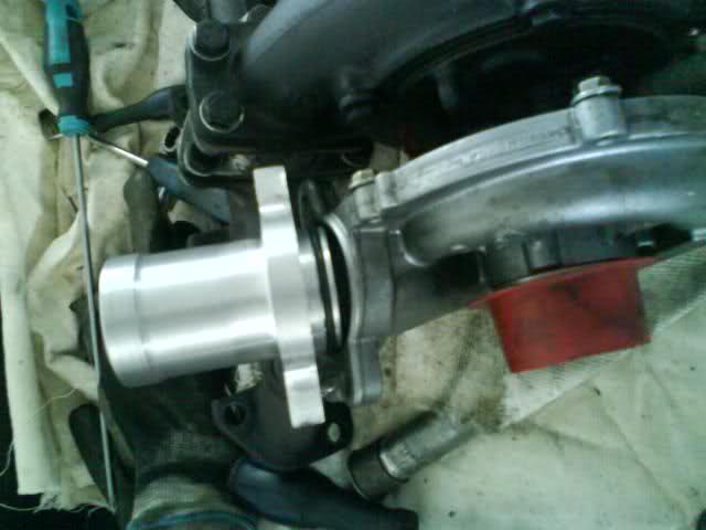

Work in progress :=)
OK! I'm back with some news.
Some new pics:
New turbo:
Tomorrow will do the new downpipe and next week i expect to have the front clio RS bumper painted to fit.
Cya,
magnastik
