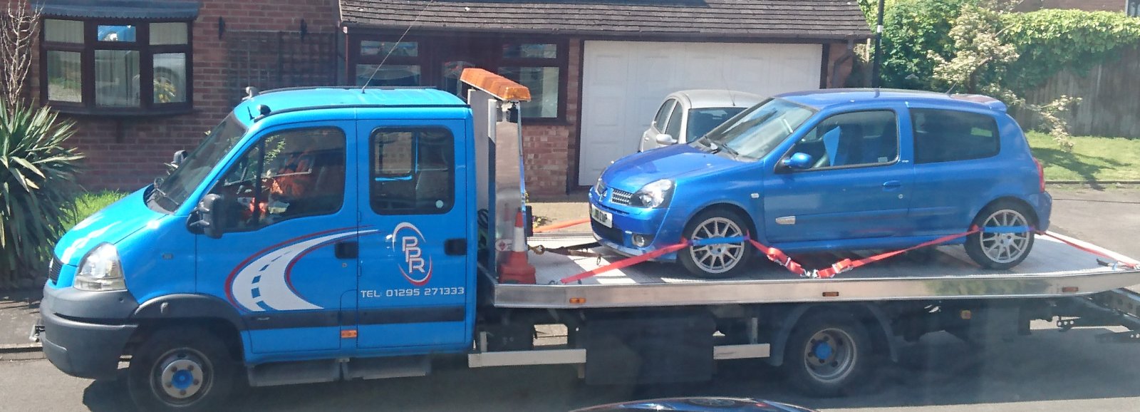

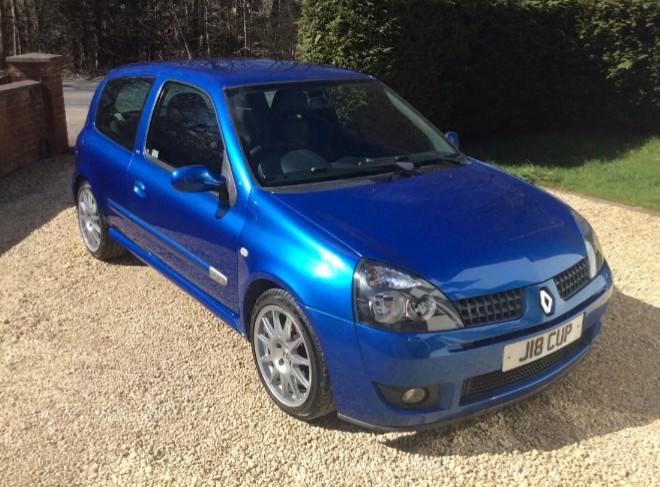

I'm new on the forum as I've just bought a 172 Cup so this is my first post. Unfortunately the reason I'm posting is because it's now in need of a new engine. I bought it, drove it back home around 90 mins away, took it out for a spin once home, then it cut out. I tried a few things, but in the end fearing the worse I got it over to the Renault specialist in Rugby. On inspection they found one of the valves had come away and the valve seat had been chewed up through the motor, damaging 3 pistons to the extent you could see chunks out of them, scoring the bores and making a general mess. I went to see it with the head off and you could see swarf over the pistons, not good considering I'd literally had the car 2hrs before it happened so not quite the dream start. Anyway for you other Clio owners apparently this is quite rare, so don't worry, I think I can only put it down to bad luck.

It's got a few nice bits, like stainless stealth exhaust, refurbished turini wheels with good tyres, mono steering wheel, shocks are fairly new with eibach springs, decent interior etc...

Thanks for the advice. I found a decent looking motor for £450 delivered, quote for work, plus cam belt kit including dephaser and clutch was around £1250, so £1700 all in. That doesn't sound too bad, however there is some heavy corrosion around the rear sill which became more evident when the recovery truck strap was pulled off and caught it, exposing the extent. I can see that costing a couple hundred quid to sort properly, so let's say £2000 total for a car that's maybe only worth £2-2.5k with a non original engine. Really tough decision but decided to strip it for parts and put the money towards a tidy one. Absolutely devastating taking it to pieces, but interesting finding out how it's all put together at the same time. The more I take off it the less pretty it looks which is making the job easier. If you're in need of any bits let me know I might be able to help out. Thanks, Andy
