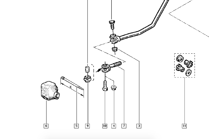

Talking about those parts, 12 and 13, any other part needed?

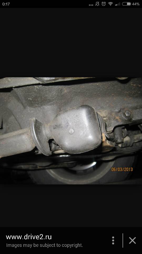

And how about the rubber protecting the whole bushe there? Mine is missing,
Do you have the part numbers?

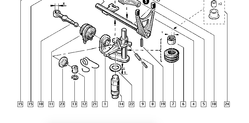

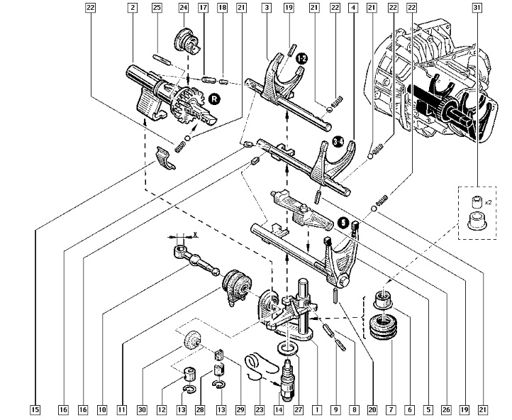

I have used a Ph1 172 Reg from a google search and here is the part numbers.
Item 12 - 7700872205
Item 13 - 8200328305
Item 23 - 7700859626
