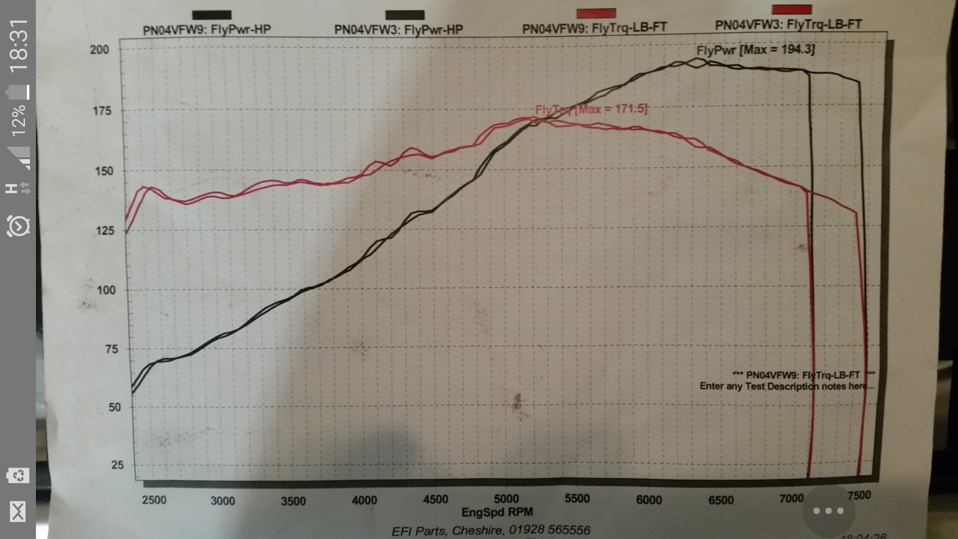

did you have a graph for this mate? be nice too see

Can't help on your issue but have recently had 197 cams fitted to an otherwise standard engine with filter and exhaust and it made 195hp and 171lb. Great cheap mod IMO.
